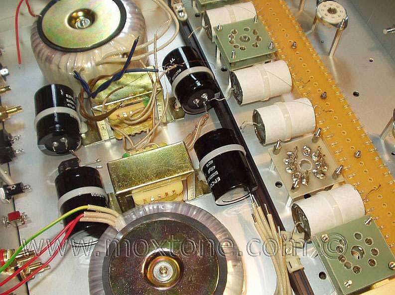

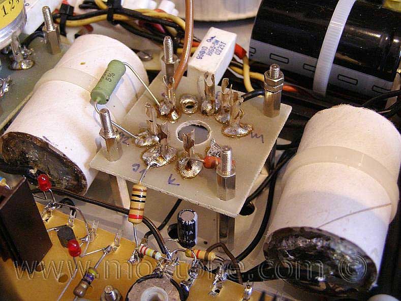

The Russian teflon tweak that I linked a few pages back offers a number of advantages. One of the advantages that have not been touched on so far, but which is worth pointing out, is the elimination of the parasitic capacitance typically formed between the outer foil and the (removed) magnetic case. The capacitor that is housed inside the magnetic case is not firmly fixed to the case so it may move/vibrate, causing the value of the parasitic capacitance mentioned above to change. This may in turn result in modulations and distortions of the useful signal that passes through the capacitor - a sure no-go.
Another thing worth pointing out is that by placing the cap inside a cardboard tube we get excellent thermal and electrical isolation so the cap can be mounted onto the chassis, as shown in the picture below. Also, one should always take care to mark the end of the cap which is connected to the outer foil prior to tweaking the cap so that later, when the cap is eventually used in a circuit, that end can be connected to a lower impedance point (in most cases, this means that the cap would need to be connected to the output of the stage that precedes the cap rather than to the input of the stage that follows it).

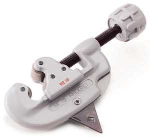

Hi Milan, thanks for the detailed shots. In return I think I can save you a ton of work. These caps just squeek into a 1 1/8" standard North American screw-feed pipe cutter like the one below. A larger size would be better but not worth more than the $12 I spent. A dozen turns and the end of the cap pops cleanly off. I cut just in the flange area to avoid contacting the internals. To save having to cut both ends work the pin loose on one side with pliers (never spinning the termninal relative to the body), desolder and pipe cut the opposite side.
For an outside sheath I'll probably go polypropylene or Teflon, both are available through McMaster-Carr.
Well..that's smart! Another fine example of why they have design TEAMS, not individuals. There may be some ideas you may NOT have, whereas someone else will figure out a better way. And sooner. Using a pipe cutter. I'da never thunk of that one. Usually I'm one of the guys coming up with the 'way cool' method of doing a given thing. Not this time. 🙂

rdf said:In return I think I can save you a ton of work. These caps just squeek into a 1 1/8" standard North American screw-feed pipe cutter like the one below.

moamps said:It sent me rummaging through my plumming gear...
Wasn't sure about the European standards for plumbing, after all you have some pretty odd-looking porcelain bolted to the floors out there. Any further thoughts on the sheathing? I like the anti-microphonic properties of cardboard but not it's tendancy to absorb water. I also like the thought of filling most of the void with wax, epoxy, etc. and was surprised about how much empty space was in the original shell. No wonder the more extreme modders were resorting to modelling clay.

rdf said:Wasn't sure about the European standards for plumbing, after all you have some pretty odd-looking porcelain bolted to the floors out there. Any further thoughts on the sheathing? I like the anti-microphonic properties of cardboard but not it's tendancy to absorb water...
I'm really not sure about the European standards either but I'm told we also use inches for plumbing pipes over here. I'm a radio guy like yourself, I believe (now I think I remember once having used a thing like the tube-cutter you referred to - a bit bigger, though - on an installation job, when I was setting up a huge radio and TV transmitting mast (1 7/8 inch cables). 😉

fred76 said:How do you like those Epcos 450V low esl/esr caps below compared to other lytics for B+ you've tried?
Hi fred:
In the tube (pre)amplifiers I built before the Siemox (e.g. SET6c33 etc.) I mainly used electrolytic caps salvaged from old switching power supplies. They were either Nichicons, Panasonics or Elnas and they were all very good. However, they are only rated for up to 400V and for the Siemox amplifier you just saw I needed caps rated for 450V. Epcos' turned out to be the best value for money I could find. They appear to work well too but I haven't really tried out any other caps in this particular setup so I can't tell how they would stand the comparison. I haven't been using the Siemox amplifier for long enough to be able to determine what to expect from the Epcos in the long run under such high-temperature conditions. So far so good - the amplifier works beautifully so I gather that means the Epcos can't be too bad either.

moamps said:...I think I remember once having used a thing like the tube-cutter you referred to ... on an installation job... setting up a huge radio and TV transmitting mast (1 7/8 inch cables). 😉
Your memory is good, it's part of the standard RF tool kit. Ours is at a mountain-top site, otherwise I'ld still have $12!
If you sit the cardboard tube in some melted beeswax, it should wick up the cardboard.

Beeswax may work. If it's good enough for transformers, it should be good enough for caps. Come to think about it, I believe beeswax was indeed used in the old day to protect caps from moisture. It can be even more prefereable to epoxy where the operating temperature of the application allows it (I'm not sure but I think beeswax melts at about 60 degrees centigrade so extreme caution is advised).

Some waxes have excellent dielectric properties and I had considered using wax as filler between the cap and shell. It's not strong enough for my liking to hold the teflon tubing I use to sheath the end wires in place. Also, the two main filaments of this project each dissipate about 50 watts directly into heat. I'ld hate to find the caps puddled to the chassis bottom.
