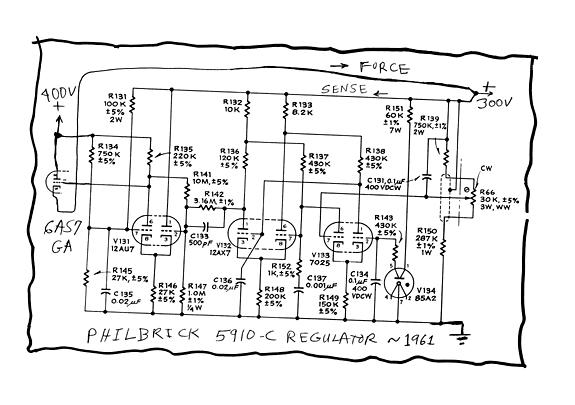

Mr. Pease's Electronic Design column on ripple rejection and the Philbrick 5910 was submitted as prior art with the patent app. I believe the first place I saw it was on your web site.
Filing is inexpensive, getting it done with an attorney is something else. I spent $15k on a patent involving chemical coatings and a laser, and $35k on a patent involving a laser in a totally different application. That's just the US, the EU is a mess as far as I am concerned.
I asked Bob Pease about some early super regulators and he dug this up and wrote an article about it.
