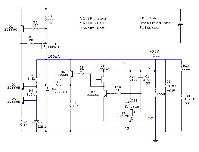

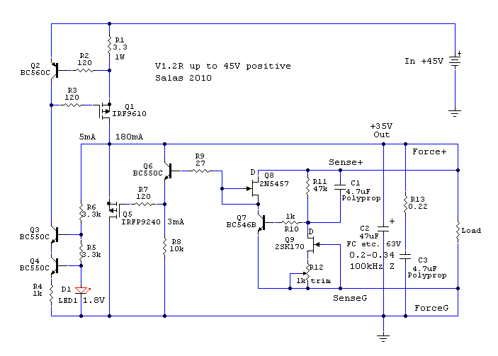

Hi jackinnj,
This is the final definitive schematic of the Salas regulator.
I hope this is the right one, I ask in the other thread the schematic and I get this one.
Rudy

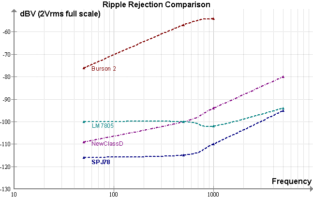

OK -- here's the PSRR test of several regulators mentioned -- the Belleson is consistent, but hardly outstanding.
I used a Jensen 600:600 ohm transformer -- very flat from a few Hz to 200kHz -- it's the model AP uses in their PSRR test. The injected voltage was 1V RMS.
Hi jackinnj,

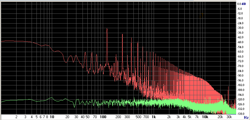

Our measurements for PSRR are quite different from yours, see the graph. These measurements were taken with 1Vpp not RMS, and only to 5KHz.
Also see the spectrum comparison of a rectifier signal into a Superpower and the regulated output. This shows the nasty spectrum of the semi-sawtooth out of a full wave rectifier (red) and the clean signal (green) from the regulator. Measurements are referred to 0dB=2Vrms. The rolloff above 20K is due to a filter in the spectrum analyzer.
Given the large range of bad performance from several regulators, I suspect you are measuring something other than the regulator. At these levels of voltage it's easy to get poor measured results. It's easy for a measurement to be worse than actual performance and more difficult to make something measure better than it is. The most time consuming task we have when designing tests is to isolate the measurement system errors from the DUT errors. For example, we had PSRR problems with a particular type of test socket feeding through from input to output.
You don't say how your transformer test circuit is connected, is it possible that DC current is saturating the core and skewing the measurements? This could cause errors that depend on regulator current consumption.
We use an active driven source to feed the input rather than a transformer, and are working on a PSRR test circuit that uses an LM3886 to drive the input with DC+AC.
If you are interested, we can pick a couple of monolithic 3 terminal regulators to pass back and forth in the mail until we agree on a correlated measurement or until we tire of the exercise 🙂.
Brian
