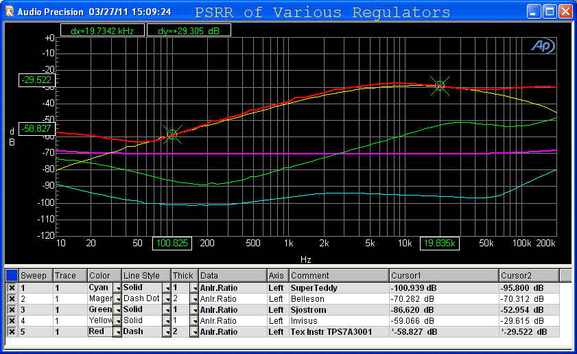

Just finished an external power supply for a Naim CD5x using the Bellson 24v super regs. Sounds good. No added noise. Musicians instruments sound larger and there is more information coming through. This is just after half hour of listening.
This thread died kind of quick. If nothing else , some insight on actual performance of a number of regulators. I did not see any reference to the Liner Tech regulators. LT1963 etc. A bit more advanced than 317's. Where do we stand with "simple" regulators where space does not allow some of the more exotic designs? Has anyone done any measurements of amplifier performance with different regulators. Say the current hot National Op amp or some generic discrete buffer.
I would love to drop a pair of Bellseons in some of my stuff, but the price is about twice what I would put out without some much more convincing evidence of being a fully sufficient regulator. To put it into perspective, I recently picked up a Hafler 110 preamp for less than a pair of these.
Didn't see this thread before; just looked at the Belleson patent.
It seems to me that the one thing I haven't seen before is the way they power the error amp from Vo. That method requires the use of the depletion mode FET as the opamp can never provide more Vout than it's pos supply voltage which is the regulator Vo.
So why do they present the patent mentioning the depletion mode mosfet as if that is significant? I'm pretty sure I can build this concept without the depletion mode mosfet (although maybe not as elegant), so does that mean I can circumvent the patent? Not that I have an intention to do so, just curious to what you guys think.
