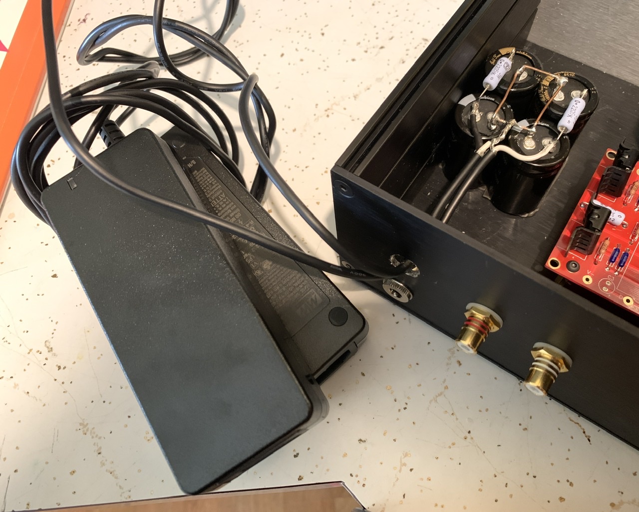

check with ohmmeter - is center pin of IEC (safety GND ) connected with negative leg , on output side ?
No, doesn’t appear to be continuity there. I’ve attached a pic of the ‘PSU’ in one frame. I originally had planned to connect each SMPS via separate barrel connectors, but my jacks are in contact with chassis. For right now I’ve just wired SMPS’s directly to the cap bank. The barrel jack in the photo is not connected.

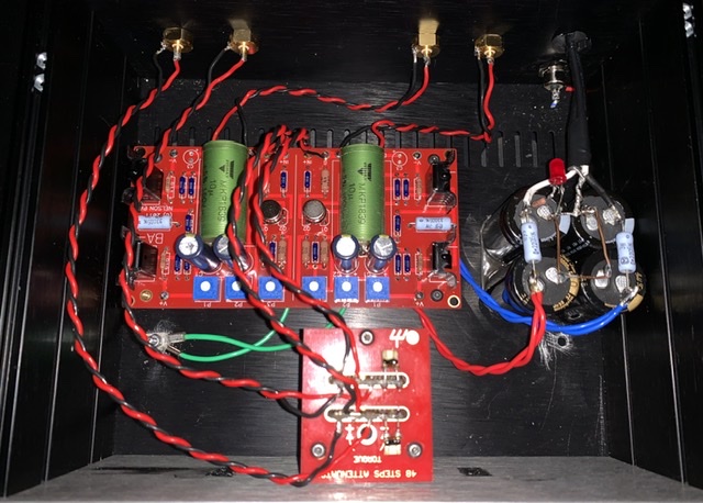

Waiting on a couple parts, but hope to report back with a finished pre in a couple days!
Thanks again to ZM and 6L6 for your help on this. Still need to finalize wiring and reroute, but it’s up and running. Sounds great!
Hope to build a proper PSU soon, but the two SMPS bricks are working great for now.

Nice build. You have quite the ac filtering going on there.
