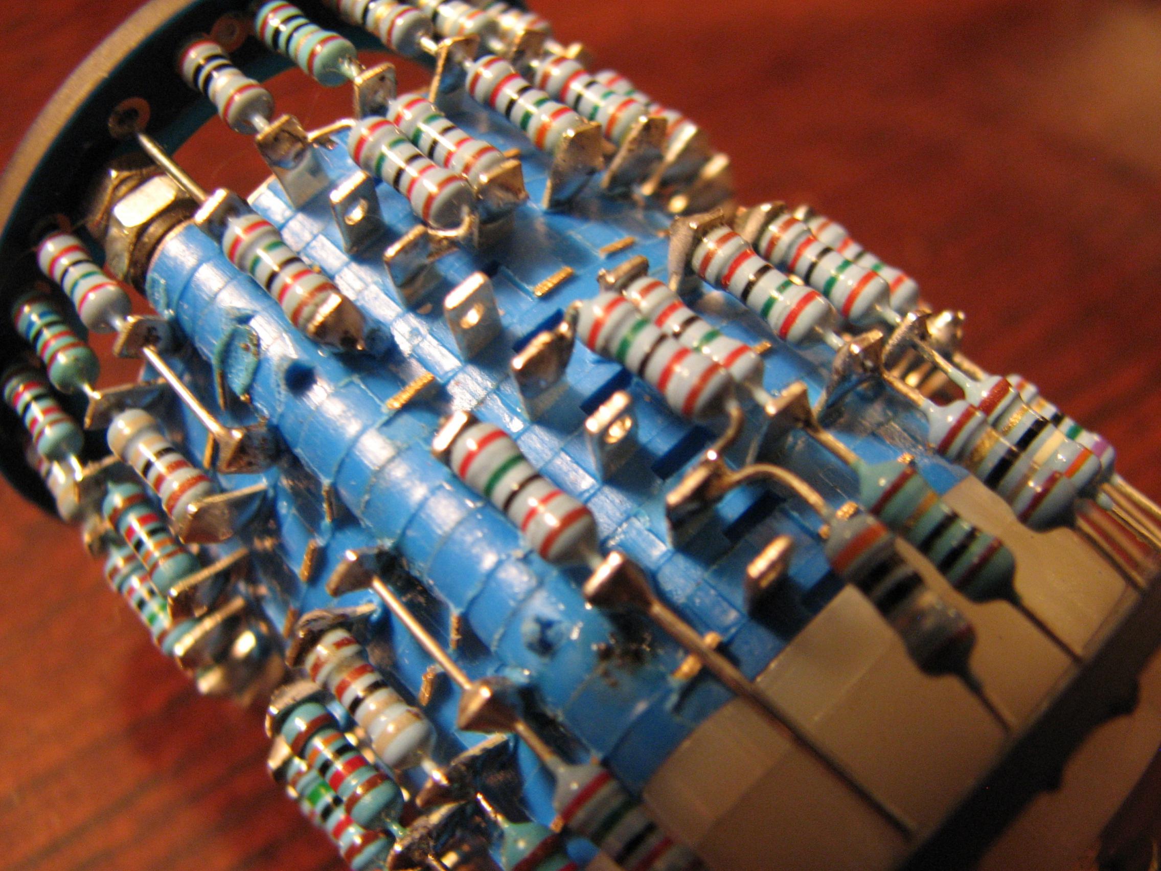

Yeah...its hard to tell from that pic. Looks ok though. Where are your rectifiers? Under the little pcb behind your reg board?
Here are the rectifiers:

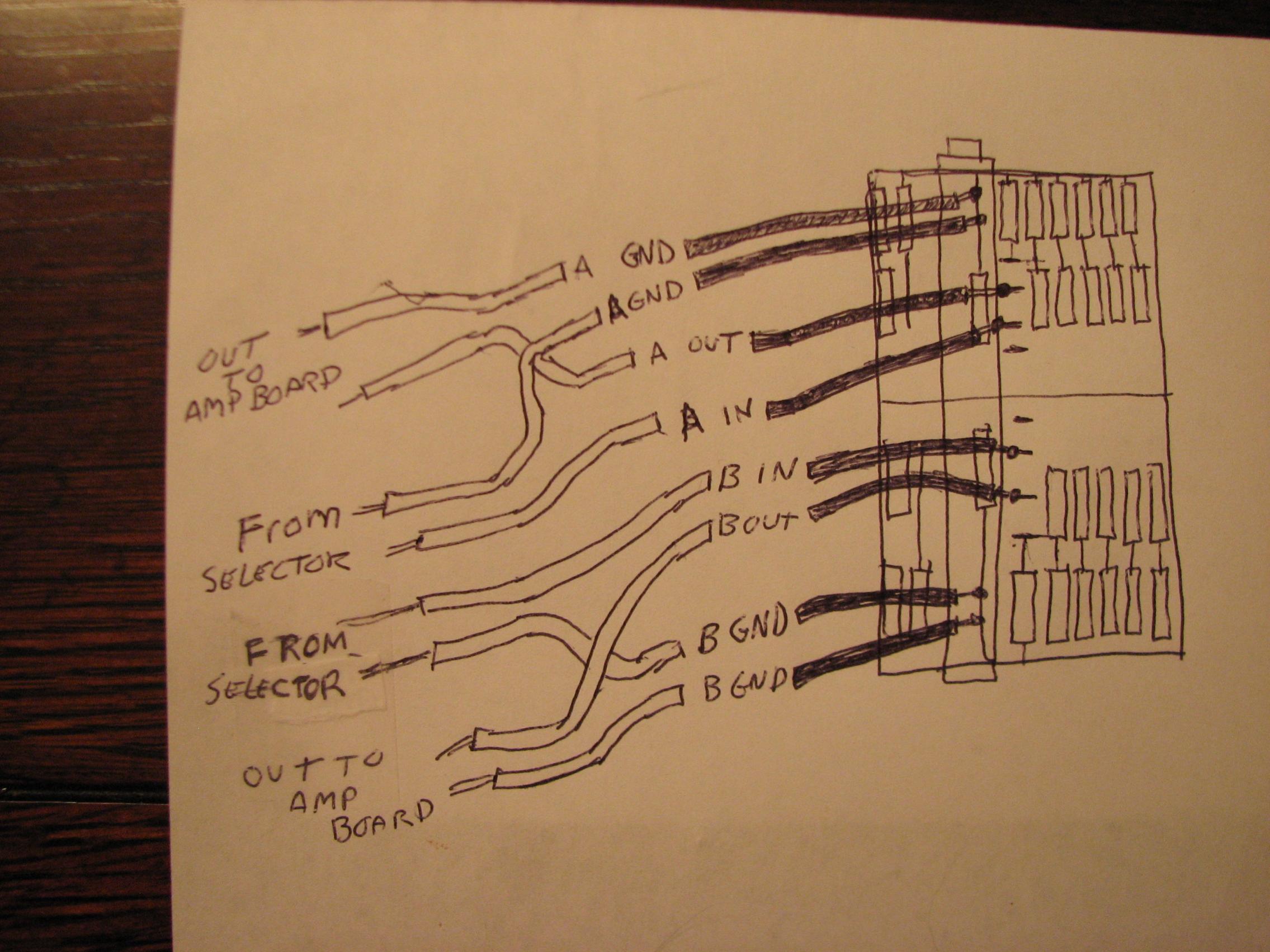

This diagram is for your attenuator? --
Its a diagram Hikari1 found on the web...it sure looks like the way mine is laid out. Hikari1 apparently used this diagram in hooking his up I guess.
Looking at this, would this likely be the way it is wired?
exactly
you can use ohmmeter to confirm that layout of attenuator
Thanks. I measured it at 25k on way, other way varied with knob position, from 0 to 25k. Now to hook up ground wire and power cord and fire this thing up!
