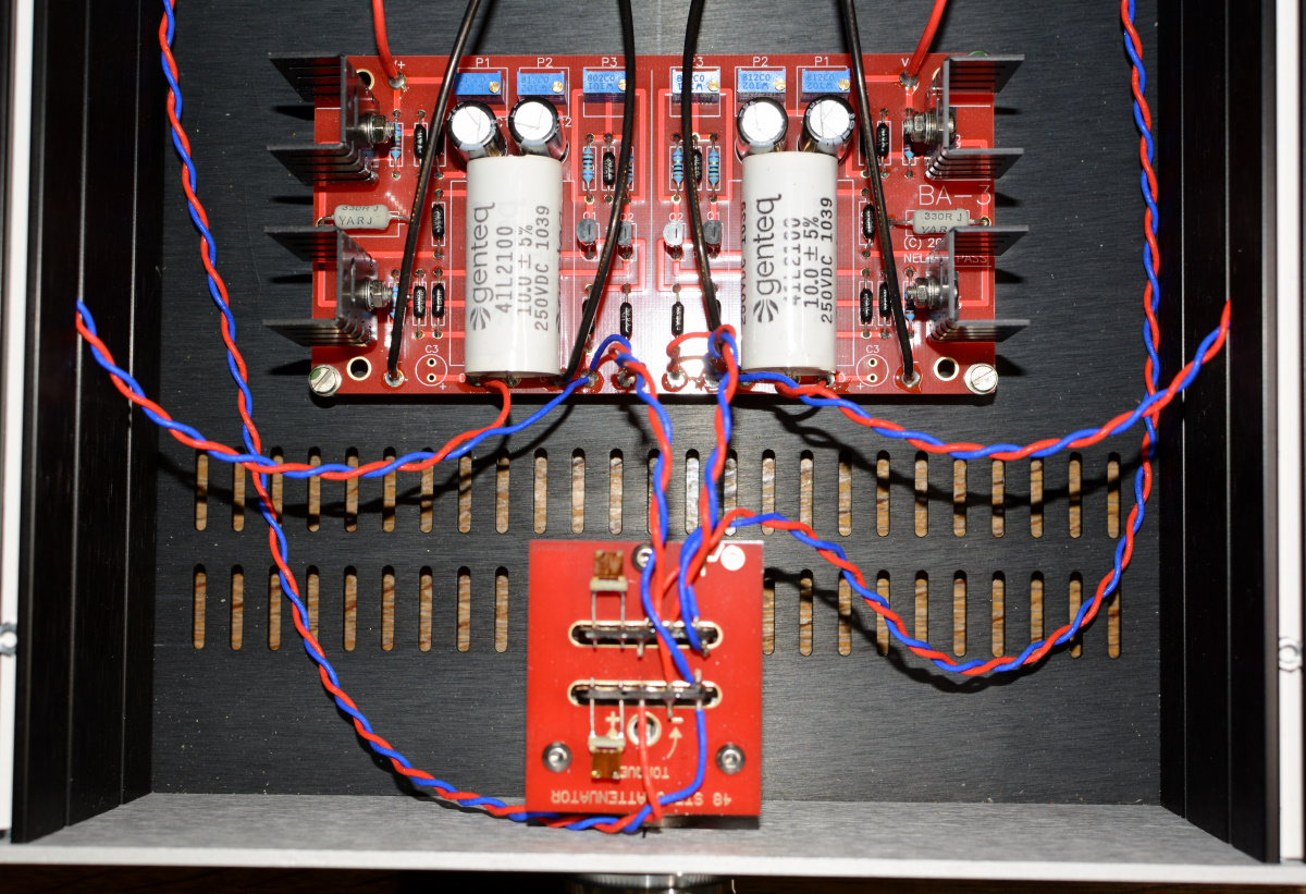

After many hours -- and a few glasses of whiskey ;-) -- reading through this and other threads on the forum, I'm beginning to gather parts to make the BA-3 preamp to go with my ACA 1.0 (and then eventually the Aleph J, etc.). I'm going for the most straightforward build I can, as I am a complete and utter newbie when it comes to electronics (allow me to underscore the complete and utter newbie part of that last sentence!). As such, I have a few basic questions:
1. Since the Galaxy 388 that 6L6 used in the build guide (which is awesome, btw!) is no longer available, will the Galaxy 2U with dimensions 330mm X 280mm work for this project? I've tried mapping out the PCUs and transformer, and I think it will work, but would appreciate some verification before I order the chassis.
2. What specific kind(s) and gauge(s) of wiring do you all recommend for this project?
3. Less a question and more a statement: For power supply, I think I've decided to go with the AMB Sigma 22 set up for 24v output since there's lots of documentation on the AMB website to hold my hand as I go (and I want to go ahead and get some practice building a PSU in advance of the Aleph J build ;-). That being said, I'm open to other suggestions on the power supply front.

1) Yes. That's tons of room.
2)Whatever you can get your hands on. This is nice - Remington Industries 22UL1007SLDKIT UL1007 22 AWG Gauge Solid Hook-Up Wire Kit, 300V, 0.0253" Diameter, 25' Length: Amazon.com: Industrial & Scientific
3) the Sigma22 is really, really cool. The documentation is also top notch, Ti does a fantastic job. You asked for suggestions, this is a wonderful performer - Dual/Bipolar LV-Reg

I can vouch for the AMB Sigma22 dual regulated PSU, have built 2 of them into 2 previous pre amps (The Kaneda Line stage and the BA3), and now I am building a third one to use with Wayne's BAF 2018 line stage. Very happy with the performance of all.

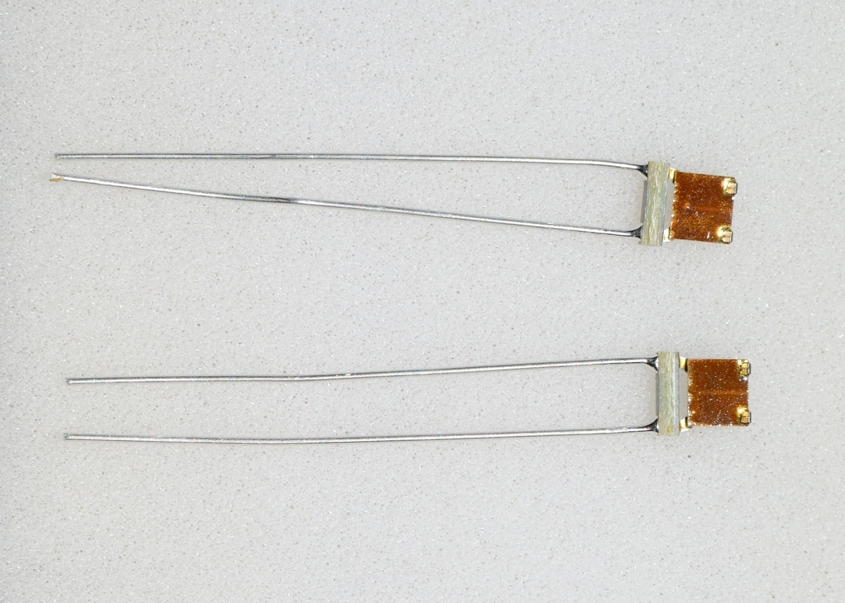

Yesterday I made a small "operation" on my BA-3 pre. I exchanged the 51k AMRG with 10k Z-Foil serie resistors in the shunt attenuator to have more output (use MoFo as power amp). When I ordered the shunt attenuator I was not "thinking" as the 51k makes a voltage divider with the Rin (47k) of MoFo. A normal pot or stepped attenuator would have been a better choice. However with 10k I have plenty of voltage swing from BA-3 pre. The sensitivity of vol. control feels like a normal amp now. It plays fantastic.

Continuing the cap conversation here. I've read enough to know there are all sorts of opinions about what kind of cap to use for C3. Based on the build guide and prior posts on this thread, the 10uF Audyn Q4 or, for a bit of a splurge, the Cornell Dubilier are at the top of my list. I'm curious about the bypass option and what that does sonically, but think I'd be wise to keep things simple for this first ground-up build... so, is the Cornell Dubilier worth the extra $, and/or is there anything else I should consider for C3?

I like the AUDYN Q4 cap. Sonically and in the special case of the BA-3 because of its size. Fits very nicely on the pcb. But I also used MUNDORF SUPREME caps and WIMA MKP4 in my BA-3 FE (I built 4).
Some others prefer the ELNA SILMICS.....
I never used this CornellDubillier cap you've mentioned. But I use the CornellDubillier MICA caps sometimes (I like them).
For me there are audible differences between caps - but very marginal for me.
I hear it much more in a passive crossover of an loudspeaker.
But that is my opinion. The cap discussion is always a neverending one.... 🙄
