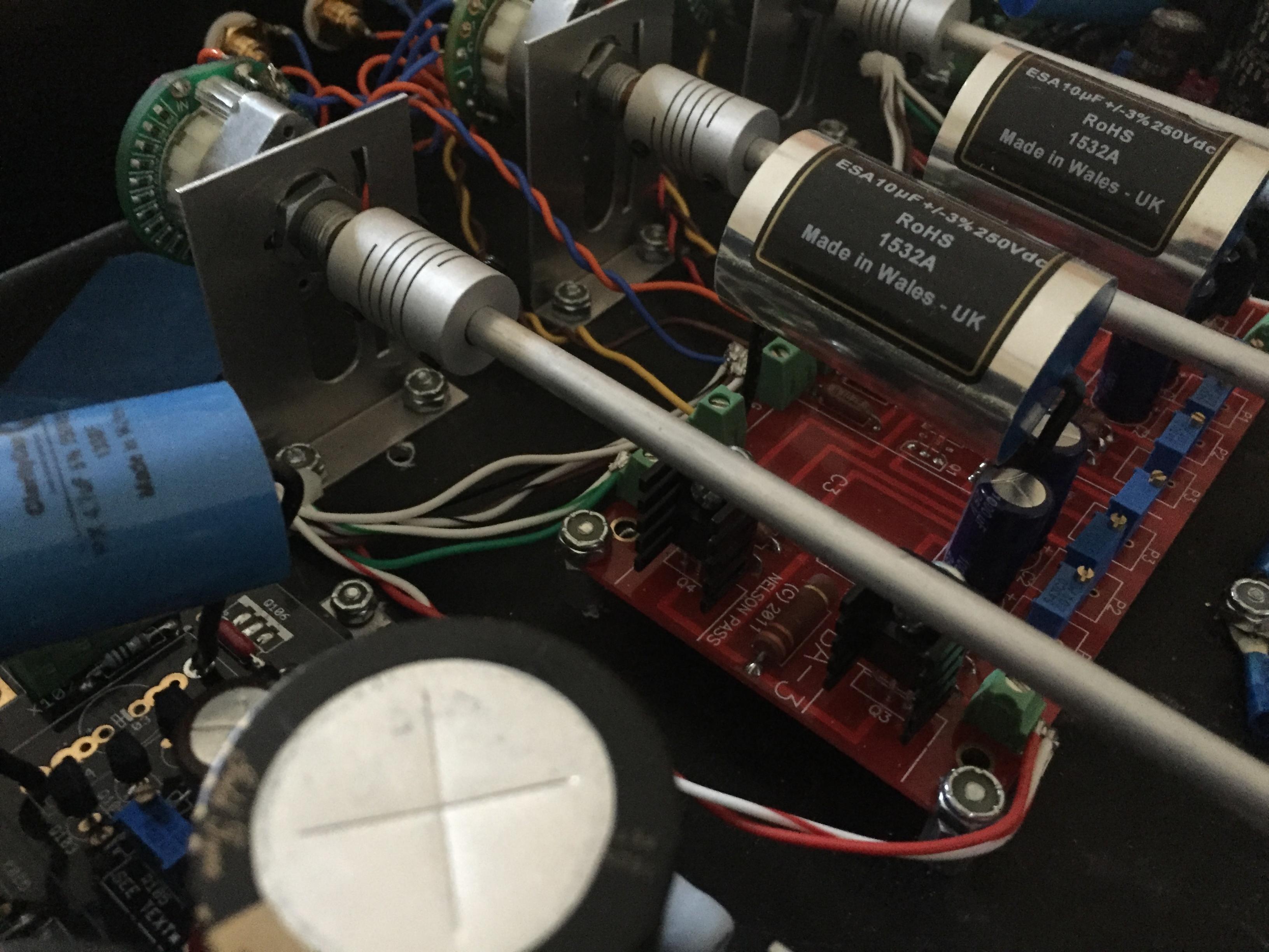

I have a couple of questions regarding my current BA3 fe build. The first relating to pot value on the input and the second regarding jfet/output cap placement.
Firstly, I plan to use an alps blue for volume control my question is should I use a 50k or 100k is there a technical/sound preference for one over the other.
Secondly, I have purchased some Mundorf evo oil 10uf caps as output coupling caps i.e. C3. My issue is that they are quite big i.e. 40mm diameter and 27mm long - so quite a squeeze. I have seen some use these have had to push the jfets over out of the way of the caps. My question is is it ok to do this and if so are there risks or issues i.e. does it matter if the jfets touch each other or the outside of the mundorf caps. An option I had thought about is to mount the jfets on the bottom of the board and use reasonably high offsets to give them some breathing space. Are there any particular pros and cons for doing this. Alternatively I had thought about mounting the mundrofs up high off the board to give the (top mounted) jfets some space, but should I put a spacer under the mundorfs, and if so what could I use - some balsa or something else. Again are there any issues for me to be aware of.
Any help would be appreciated, regards Nigel.
I just let my output capacitors stand up off the board. I would go with the 50k pot.
Of those two, yes. I used 25K and many encouraged to drop to 10K. 6L6 used 50K, as he had a 50K goldpoint at hand. This looks like what I, and a few others used. Out of 3, I had one with a bad internal connection. Best 20 bucks I've ever spent on a volume pot. I used them on both BA-3 FE I built.

...wow cnc grade shaft couplers
