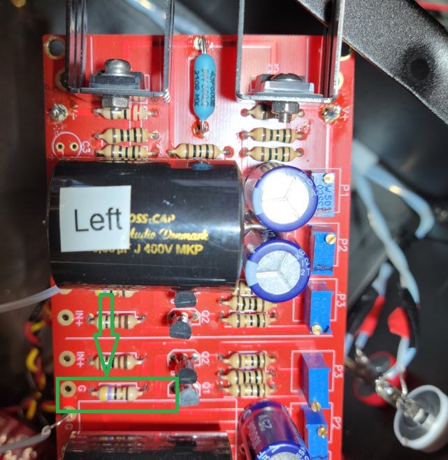

Chip, Check the value of R2 on your BA-3 board. It looks like yellow violet black gold brown, which is 47 Ohm. R2 should be 47k Ohm.
If you don't have a 47k, you can put in a higher value.

Chip: Please check R2 as Ben suggested. If R2 = 47 ohm and R1=1k then R1 and R2 gives you about -27dB attenuation...

Ben,
Thanks so much for finding this error.
You are correct. I checked on my purchase order for these resistors: 47Ohm not 47K were purchased.
I will replace them.

This is strange.
I've built two BA-3 amps, let's call them BA1 and BA2.
My source is a Node to an ANK DAC 5.1 that I built a year ago.
My amp is a M2X.
When I feed BA1 via this system all is good.
When I feed BA2 with this system, the right channel comes in about 50% to the left in volume.
When I take the DAC 5.1 out of system to the BA2 and feed the Node to BA2, all is good.
So the DAC 5.1 works with BA1, but not BA2.
I've checked all the connections.
I've run this series of tests multiple times.
The only major difference between BA1 and BA2 is the Khozmo attenuator [which ANK uses in their preamp kit].
I have used two different sets of interconnects.
I have no idea what is going on.
Just want to sit and listen to music at the end of the BA-3[2] build adventure [whine, whine].
Any thoughts would be appreciated.
define exact type of Khozmo
if that is one with fixed series resistor, then shunting resistance as variable, you need to do 2 things:
-first change R2 in BA3 ( Rin defining element) to, say , 330K
-optimize value of series resistor to give you minimal possible attenuation in lowest position
