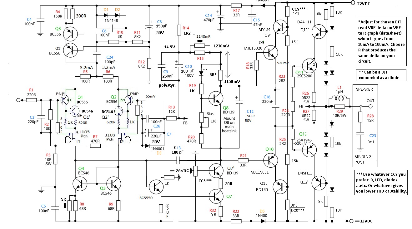

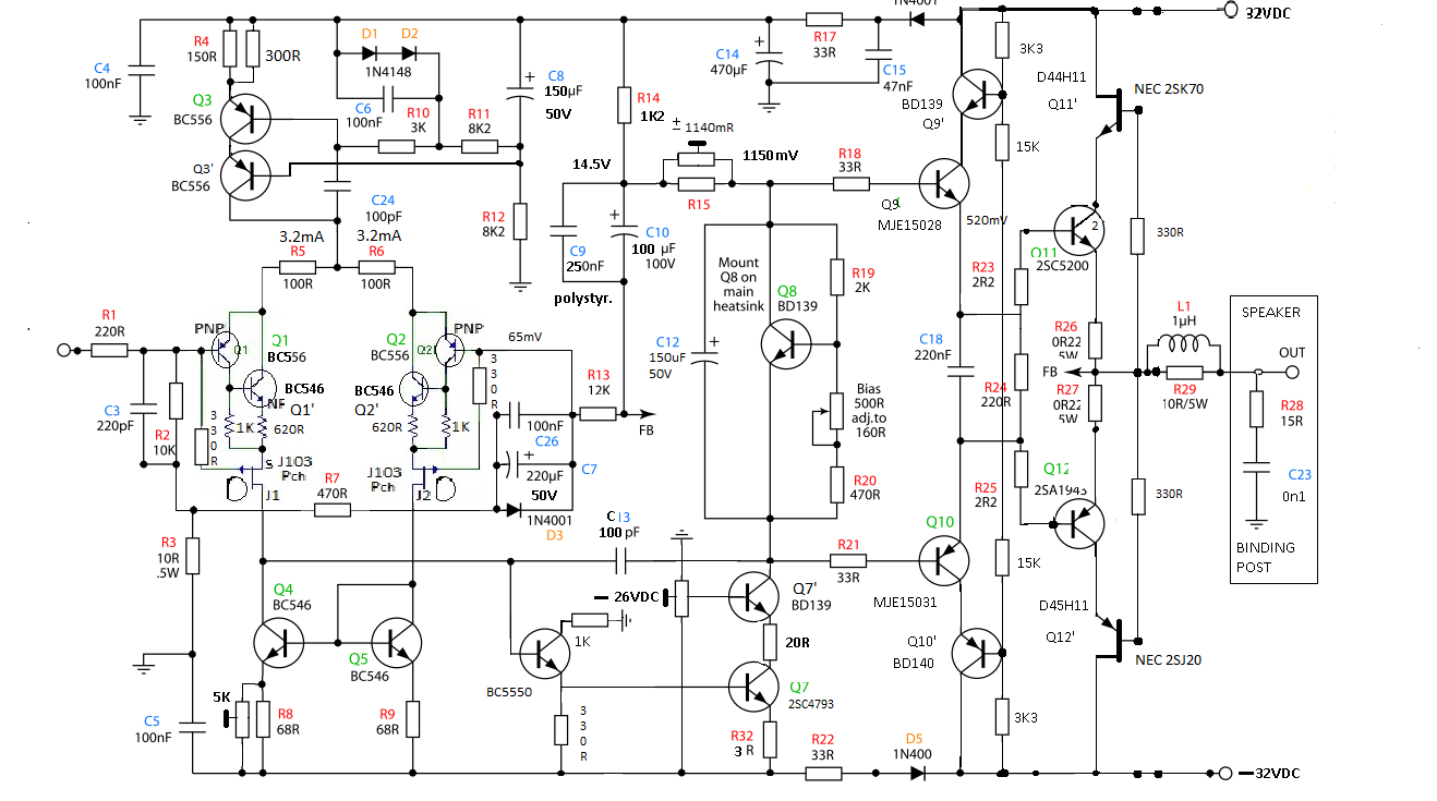

I made some mistakes earlier. The node in question is named "+/-Vbiasdrivecasc" on the .asc file that now goes attached. This one with 44V supplies and still no clipping. The .four command says 0.005%THD. I still don't like the noise floor. I will reevaluate my common-base buffer for the differential current output.
Edith: apparently, biasing with power LEDs gives lower THD. Biasing +/-Vbiascasc, the node for the output cascode with one diode and one LED (instead of a string of 3 diodes at 2.1V) set at +/-3.38V gives 0.0024%THD...more experiments to come.
On the real amp I still have the bootstrapped VAS as I respect DX's opinion about sound Q. Can I use baker clamp in my bootsatrapped VAS???
The real amp makes superior sound, IMHO.
Confession: the real amp has solved the oscillation bursts problem with a configuration of cascoded EF VAS plus cascoded drivers exactly as depicted in diagram from post# 101, with 2N5551-->2SC4793 cascoded with BD139 and then drivers MJE15028/15031 cascoded with BD139/149.
When I tried to make the VAS an EF by adding 2N5551 it went into heavy oscillation, even if the RC from the zobel was transplanted to the speaker binding posts (BTW the connectors from the speaker protection circuit, IF outboard, are also useful for that move) with the only difference being that the drivers on that channel are still BD139/149 cascoded with BC546/556!
Working Amnesis and sounding good. Tests continue.
I added notes. The Hagerman mod is not yet done.
I think MJE15028/15031 are superior drivers. And they can handle parallel outputs, I imagine.
When I am satisfied I will prototype my 44V version, with all mods from .asc file included: Hagerman VBE; CCS loaded VAS.
There are many mods still to try:
Input-> increase current from 3.2mA to 4 or 5mA. Cascode the current mirror. Add the common-base buffer to the current output from the differential "pair". Transform the J FET cascode element into a compound CFP...
VAS-> independent regulated supply with increased value to "cascode the cascode" as suggested by Peufeu. Compare boostrap VAS with CCS loaded VAS.
Drivers-> find the ideal biasing for the common-base BJTs and find the ideal BJT combination.
Output-> once the previous section get stable, continue to experiment with crazy outputs to find the optimal one that can cope with the increased resolution of the low TMD amp: VFET; CFP; cascoded CFP internal and external; CFP cascoded CFP, internal and external...other that I cannot imagine yet. As you see, lots of work and experimenting. 😀

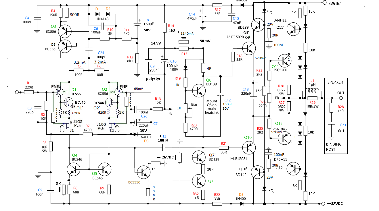

What great inventions LEDs are!
The real amp (with 32V supplies) is now stable with LED regulating Vbias for the drivers' cascode, decoupled with 20R-100nF to ground. I could test it until clipping with no oscillation whatsoever. The cascodes for the outputs must be checked for bursts of oscillation: none found.
Cascodying still has secrets for me...the drivers are good with the cascodes' bases at PS+/-3V while the ourtput need the bases of the cascodes at +/-2.1-2.8V from ground...
Now I have the basis for re-exploring the cascode-CFP and then the CFP cascoded-CFP.
The simulations with 44V, LEDs and the buffer for the differential output seem good enough, with extended response and good stability margins (80°; -18db) and is now a worthwhile experiment.

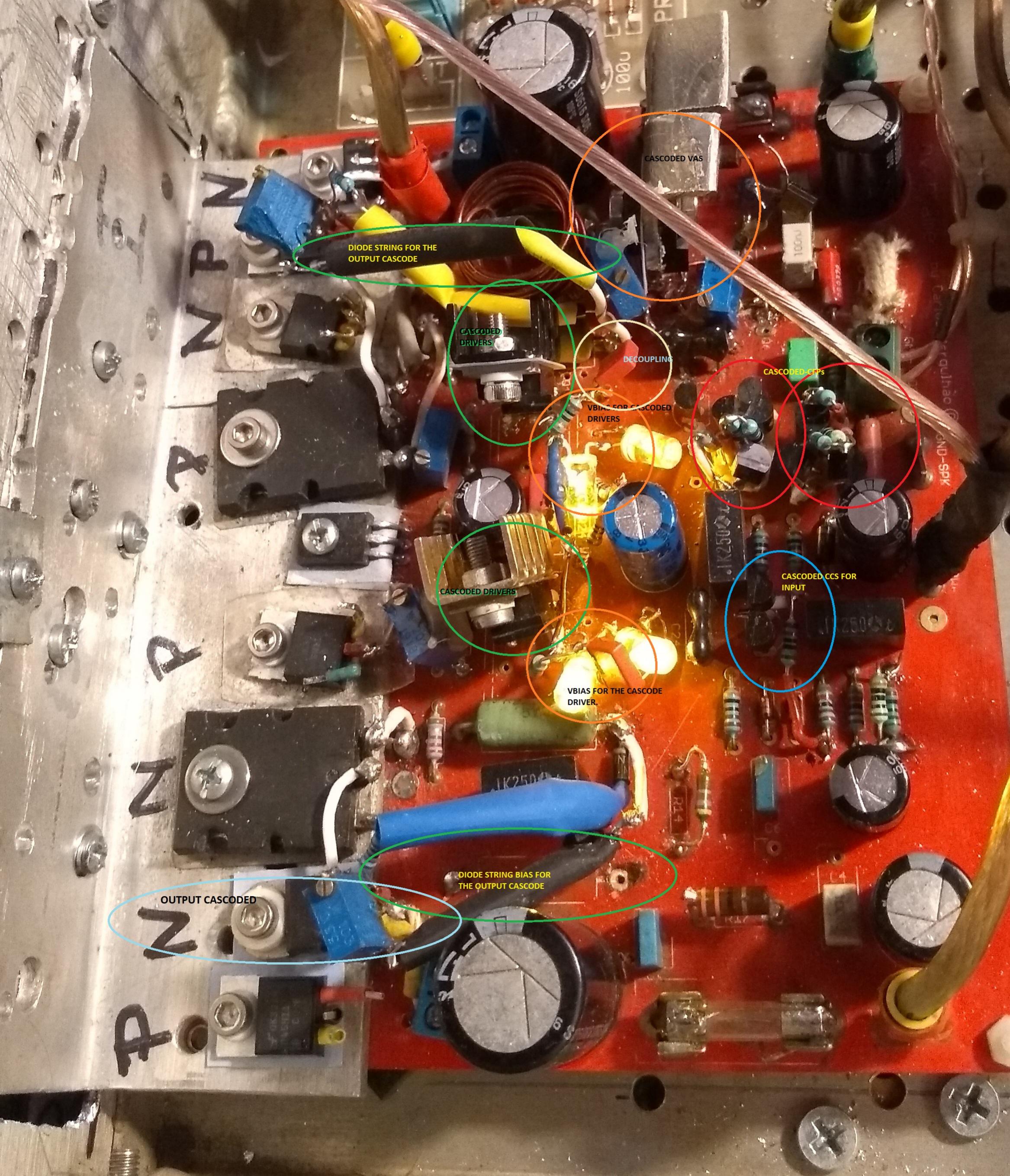

Audition started with the inside systems.
Stable so far.

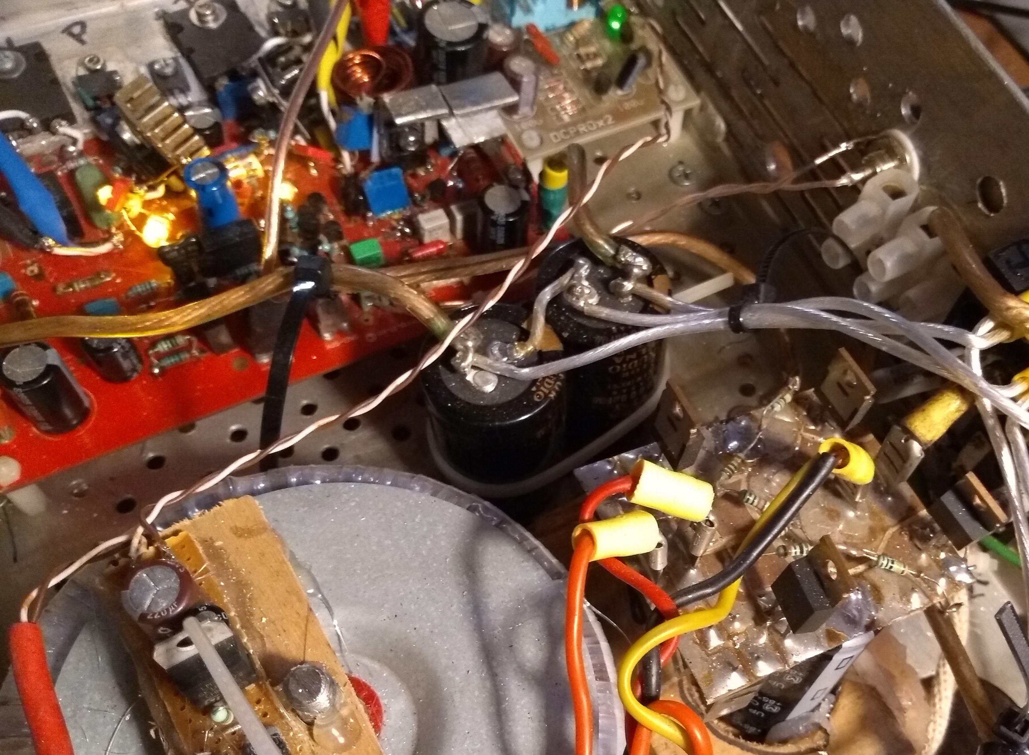

Some pictures of the Amnesis LED and of the "charge-transfer supply".
Stable so far.
I think I have a winner... 😎
Sorry, the last file did not work properly. I had to mod it: degeneration R for the drivers split and tied to output. The other way works in real life though...

IC that ya haw a circ that is modded a copple of times.
Dont ya get sort of exitet by the thougt of having bouth sides of the vas stage to bee active or sort of ? Maybee even symmetric?
Mount Q8 on output, remove termal pad. Reduse R19 to reduse termal tracking on Q8 if it overcompensates bias.
Is there just a symbol of or is it a diode in the bias circ ?

I have two projects in one so to speak: the real amp is the circuit posted above with bootstrapped VAS. The other amps are only in .asc simulation format and those have active CCS VAS. Many variations have been tested.
The biasing I posted latelly is a modified Hagerman: it could a a diode or a transistor in diode config. It is supposed to be much lineal than the classical.
Be aware that I am no expert and that I progress giving "blind sticks" here and there, trial and error...until I catch the attention of the big dogs. 😀

The ultimate design goal at present, as I said before, is to find the most transparent output section to exploit the LTMD benefits of input and VAS.
Speaking of which, I will have to test cascoded-cascoded-VAS, as Peufeu recommended.

In case you don't want to deal with potential oscillation problems, here a revisited version of my own splendid Low TMD amp with Tokin 2SK180 or THS51 VFET. This is the version with all-cascoded.
The VFET can be replaced by your prefered depletion Mosfet, but that would require adaptation of the Vbias, probably.
Even an enhancement Mosfet would do as cascode element, or a power BJT provided a change in biasing...trust me these Tokin amps are great.
This version is not tested yet, but will soon be, as I have the biggest heatsinks I could get... 🙂

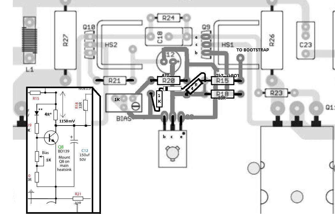

This would be my Hagerman mod to the bias of the Blame PCB.
The extra compensation R* must be selected given the chosen BJT and its change in VBE from two selected points in the VBE v/s Ic chart, for example from 10mA to 100mA, as explained by the author.
I hope I got it well. 😀

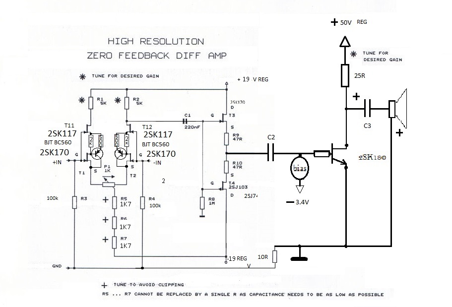

I am revisiting the diffamp for my VFET single ended as this is a tricky balance act. I wil post the present circuit. It gives enough un-clipping gain since the VFET gives a gain of 10.
