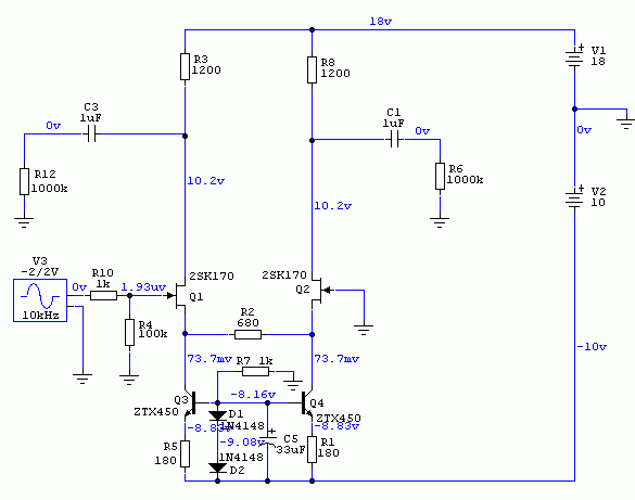

Here is another SingleEnded to Balanced signal converting circuit. It sounds better to me than one published in post #69. I used JFETs with Idss=7.5 mA and each CCS gives 6.5 mA (depending on diodes used R1 and R5 might need adjusting: lower R => higher I). R2 sets the gain: lower R => higher gain. With R2=680 R I have 1.5 V/V and with R2=510 R I have 2V/V=6dB gain. Matching JFETs is important.
It easily drives Mike's circlotron with Zin=100k and sounds really good. I even tried to load it with 10K pot and it still sounded the same, there was only 10% drop in signal amplitude.

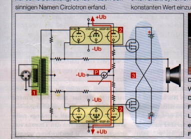

As to the Thorens schematics, you'll find out more about his "invention" than this HiFi magazine schematics. He did not invent the circlotron circuit he used, just the bias stabilisation, which is essentially a common-mode servo plus a differential servo.
Amazing what people can patent these days, including method to identify certain genes of a pig !!!
