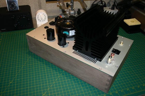

Got my fan in the mail yesterday, it's a shame to have it out of view, looks so good, and can't hear it without sticking my ears into the blades, may need a re-wire though, it takes alot of heat to make it go fast.

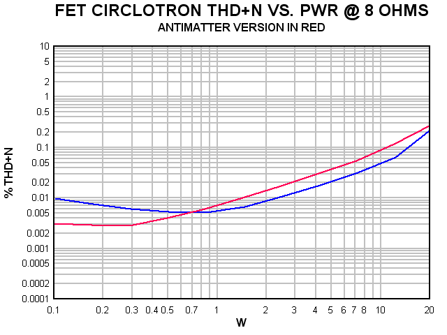

Somewhat preliminary, but here's a test of an "Antimatter" channel using the LSK389 boards.
The noise figure I measured in the audio band was impressive at about 15 uV, which probably accounts for the improved THD at tiny power levels.
Board file and info to be posted this week.

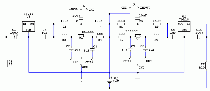

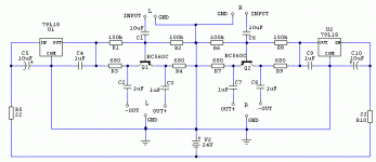

I really recommend balanced operation. The two-stage capacitor-less iteration is certainly the way to go in my mind.
However, realizing that might not be possible for some constructors, I had intended to look at three circuits (2 active, 1 transformer) for "unbalancing" the input.
None have been tested, and it will probably be quite some time before I get to them all.
In the meantime, perhaps a few solutions could be worked out here in the forum.

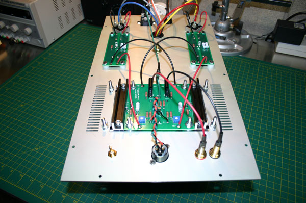

Got the rest of my parts from digikey today, now I've got all the components. Tomorrow I'll cut some parts for the chassis, hoping to have it on the way to the anodiser on Sunday.
I'll make a picturey worklog on the AudioEnz forums, and put a link here to it.
