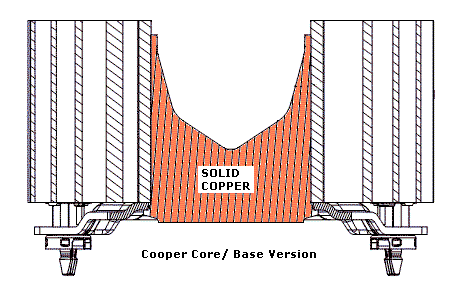

Nothing too strenuous here, just after a few opinions. Firstly, cooling: how about these stock Intel LGA775 heatsinks, one per MOSFET? Particularly the one attached, as I've already got two of them, and they are frequently sold second hand cheap, they come bundled with CPUs that often get after market heatsinks.
I'd have them protruding halfway through the top panel, and have a thermistor controlled 120mm silent (6 to 14 dBa) fan driving air in, forcing it out through the 4 heatsinks (and elsewhere if the flow rate makes it too noisy).

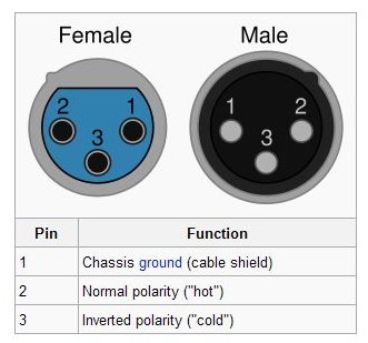

Also, just so I'm clear, a question regarding the input, amping is quite a new field to me.
Balanced being required, and unbalanced being everything I own, It would be wise to build into it a B1 JFET buffer, correct?

Pikefish said:Balanced being required, and unbalanced being everything I own, It would be wise to build into it a B1 JFET buffer, correct?
A stock B1 will not give you balanced outputs - you'd have to rework the design as a phase-splitter first. It would be best to execute this as a separate preamp with its own power supply, though it is feasible to add it as a new front end to the amp itself. But if you don't otherwise need a balanced-out preamp, the simplest thing is probably to add good line transformer to the front of each amp.
Yeah, I realise now the B1 doesn't seem to have the right number of plugs for balanced operation. Haven't got the foggiest idea how to rework the design as a phase-splitter, so I'd then run the B1's out through a pair of line transformers, and have the last switch position route to a XLR balanced input, for upgradability. Maybe make it also able to function as an output from the preamp.

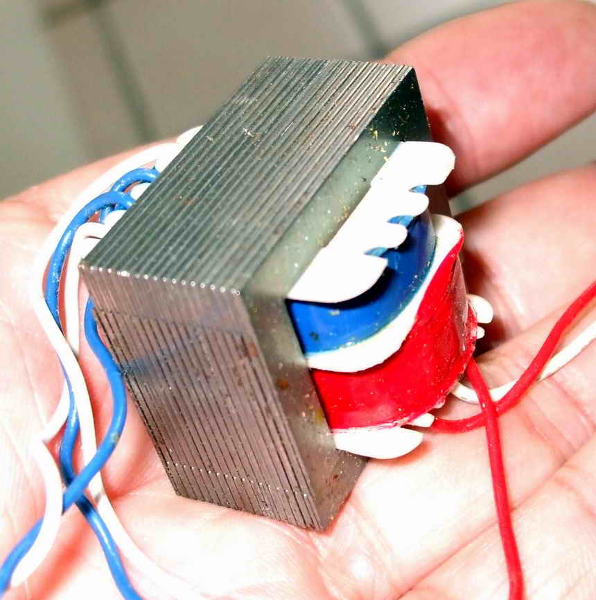

Another question, regarding the power transformer, could one get away with using a 160VA transformer instead, if the supply caps were 39600uF each? Would also a soft-starter be needed, pointless, or unsufficient?
I'd ask Mike at his blog this sort of thing, but then the answer's not here for the benefit of others.

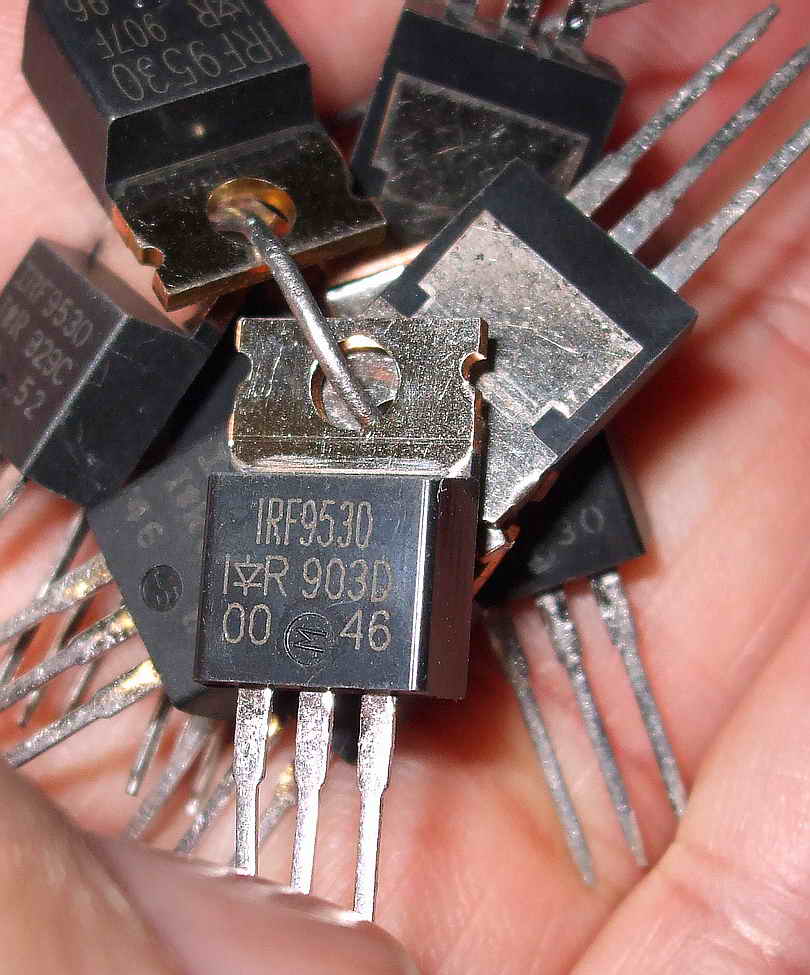

Mind changed because i have those fets... the Ciclomanen ones
FETs are problem here in my home..hard to find them.
I do not appreciate class A, also do not appreciate Fets, but this circuit call my attention because very simple....no CCS, no lamps in series... very simple.
A pitty i will have to use a transformer or phase splitter into the input... i think the circuit will loose the charm to me if i will have the need to install a transformer or another stage as phase splitter.
If needed... i will stop to build immediatelly.
The nice things is that it is simple...if need something into the input...well... will not be simple anymore..will look alike others.
And i use to change my mind... and daily my friend... this means evolution brother!

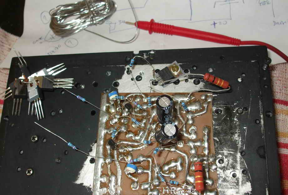

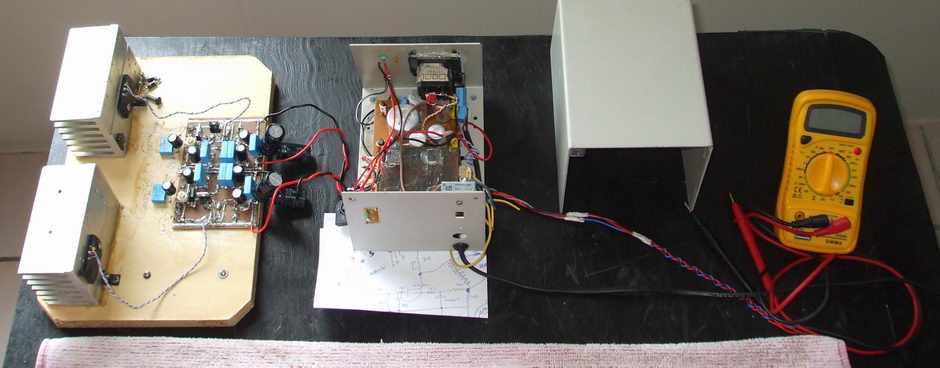

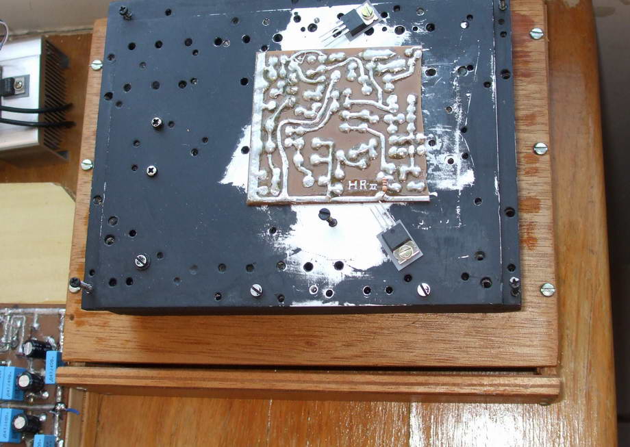

I have assembled and found it good
Treble is not so mufled as the DOZ and others class A i have in my home.
Do not pick radio frequency when we put finger into the input
Was stable and easy to adjust... a pitty, too much hot... increased current to 1.5 A each side and i felt the unit would melt...poor transistors very hot to the touch.
I found sound nice, excelent bandwidth, clear treble, mids and bass...nice..very nice.
And i have tried several input circuits, transformers, inverters using transformers, transistors inverting, direct plugged..well..tried many ways... and i found good in many ways... some very small noise into wrong ways but audio remains nice.
I think the unit will sound great when using the good pre amplifier to match the unit.
I would be happy with a sligtly bigger high end...yes, have tried headphones and different speakers.. and with those speakers and headphones i have some class AB here that produces more treble, better high end... despite the difference is not so big.
I felt distortion very low...very good..but when you increase the input audio..then, while clipping, into this moment distorts awfully.... of course!
Will be dismounted...to much hot to my home... was a nice experience
thank you the attention (not so big)

Pikefish said:Firstly, cooling: how about these stock Intel LGA775 heatsinks, one per MOSFET?
With fans, perhaps, but it's hard for me to know with certainty.

Pikefish said:Another question, regarding the power transformer, could one get away with using a 160VA
160 VA should work. I used a 250 VA from Avel because it was only a few dollars more than the 160 VA version, bigger generally being better and so on.
