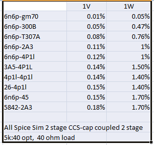

Attached is a cmparison of THD at a few millwats to 1W for various 2 stage combination as predicted by LTspice under extremely ideal conditions.

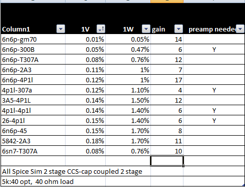

Added 4p1l-307A and Gain. If anyone sees what looks like an error or counter-intuitive let me know. These are more relative numbers than anythig as it is simple spice. If anyone has a model for the 841 (old thoriated fil valve with gain of 30) please let me know.
Fixed typo in chart post #508 had a typo. Added 6sn7-307a
Are you sure 1V 8%?
Thanks Merlin, fixed. Also to much regret as I despise 6DJ8's due to their cost and sometimes sound they're showing a perfect match for the 307A, the distortion is exponentially lower than the other tubes, I hesitate to post yet. The 307A is proving to be a tube that doesn't quit, low distortion low level to very high level.
