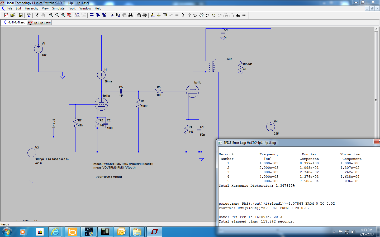

Because I'd like to compare notes with you. I use this in the schematic, as a spice directive:
.meas PWROUTRMS RMS {V(out)*I(Rload1)}
.meas VOUTRMS RMS {V(out)}
which gives a calculation of the RMS output power and voltage. I'll try to recreate your sims.

Probably the transformer model ( I am actually using a 40 ohm load):
.SUBCKT OutXFMR_5.0k:40 1 2 3 4
L1 1 5 46H ; primary inductance
R1 5 2 103 ; primary resistance
L2 3 6 0.366H ; secondary inductance
R2 6 4 2.4 ; secondary resistance
K1 L1 L2 0.9996 ; coupling coefficient
C1 1 5 5p ; primary side capacitance
C2 3 6 30p ; secondary side capacitance
C3 5 6 200p ; primary to secondary capacitance
.ENDS
Could be the bias points, I will put this in a zip file and upload tonight, I would like to compare notes also.

I use rar not zip will need to figure that out but here is a screenshot, note that the transformer model is extremely optimistic, its actually a parafeed transformer model. Real world results with an SE gapped Iron core would I expect be much worse.
Honestly, I would not put the effort into building a headphone amp that promises to give me the listening pleasure of 1.4% distortion at 1W. Nothing wrong with your simulation. I'm just saying that for me this would be extremely discouraging. If it turns out that my combination of tubes ends up with similar levels of distortion I don't think I'll go ahead with the project.
A real output transformer will add even more distortion, especially SE gapped. The only way to do significantly better is a 1000+V GM70, heck I've simulated a million combinations. $5k to $10k commercial DHT headphone amps have the same relative levels of THD, this is SET and the norm. Remember its the first milliwat that counts and a black background.

Why don't you try to use a simple anode resistor and see if you can cancel a good amount of H2? In theory it shouldn't be difficult with a 4P1L driving a 4P1L.
You could start with 3.3K and 5.6K. These, in parallel with 100K next stage grid resistor, will make 3.2K and 5.3K respectively. With 3.3K and 750R cathode resistor it should run at about 205V/20 mA; with 5.6K and 620R cathode resistor it should run at about 170 V/19 mA.

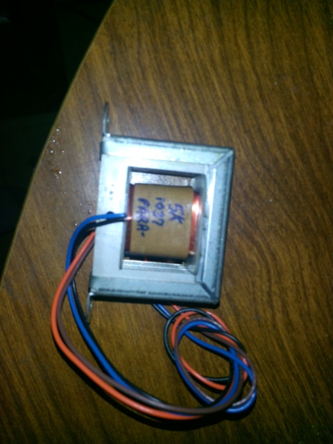

Here is a picture of what ElectraPrint sold me from their left overs from a large order but it is a true embarassment. See the huge gap between the copper and the lams? Not good at all. Its not their fault really they just tried to couble together what they had left from a big job.
