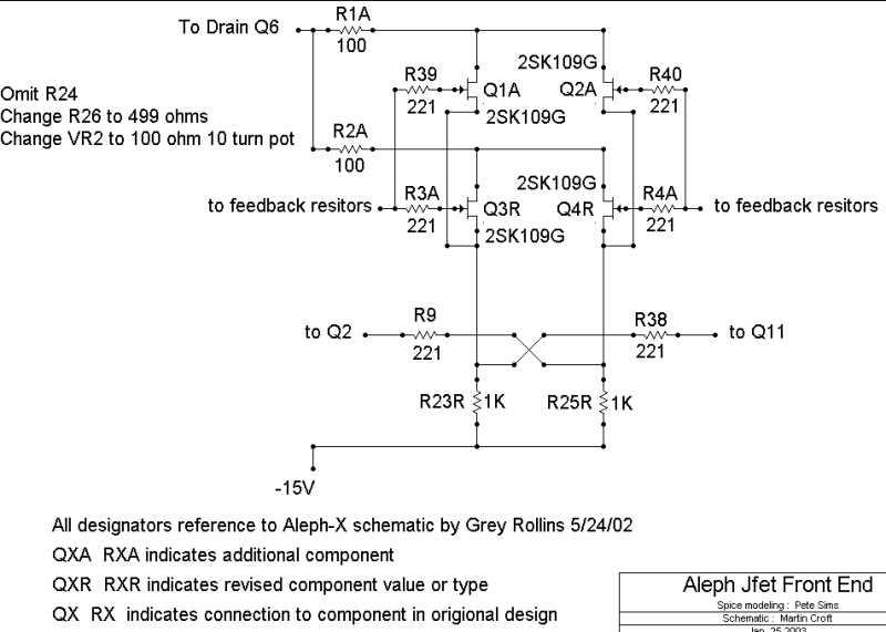

What is the use for R36 and R38 tied together and at the sources of the jfet diff pair?

r36 and r38 from aleph-xj
r36 and r38 are the famous Ian MacMillan resistors.
These help to control the absolute offset. This is the
offset from one output to ground. The differential offset
(offset between + and - output) is not affected by these.
Regards
Regards
Idss classification V type would be better if I would be able to get
them. V type would mean little higher transconductance, and
more feedback, so little lower distortion. For this to work you
would need to bias the frontend harder (let us say 15mA per
side of the diff pair), hence this would mean at least two V(iolets)
in parallel to deal with the increased dissipation. The current
source for the frontend would need to deliver more current,
means more dissipation, so a different type would be needed as
well. I remember Mr. Dieckmann recommending a 2sj77.
Your schematic shows 2SK109G. Did you mean 2SJ109GR?
These would be the lowest Idss class.
The 1k drain resistors R23R and R25R in your schematic suggest
a bias of only 4 to 5mA. Good for GR type, not so good for V type.
