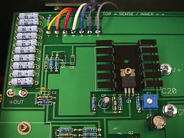

Re: c5 and c6 => stability
In first production pictures you can still see them, aren't they C2?
rtirion said:
In a real circuit you can experiment (use for instance 5 pF) and
look at the square wave output on a scope. Mr. Pass wrote that
he designs his XA pcb's is such a way that the c's are no longer needed.
Smarty pants, that was a picture of XA200 Rev 0.
The owners of this rev will be treated to a free update, BTW.
Believe what I say, not the pictures I post.
