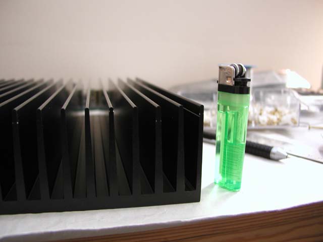

I also agree that those are the best heatsinks around. If you guys are interested, I can organize a group purchase, since I'm looking for heatsinks as well. Just let me know. A piece 11" x 11" anodized black was CAD100. For you, living in States it's peanuts. With a group purchse the price would drop down probably.
I'm definitely interested. My friend who wants to build the
2 ohm Aleph-X's will need serious heatsinks as well.

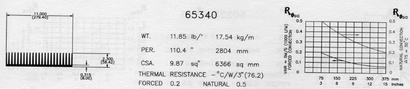

Which R-theta profile is it, BTW?
Dennis
that's the one:
If a group purchase for these is organized, I would like to purchase 4, maybe more if the price drops. Can you see if you can get prices for a large group order?
It appears to be the same as this extension from Aavid:
http://www.aavidthermalloy.com/bin/exdisp.pl?Pnum=65340&LengthUnits=in&ExLength=11&airflow=57.2
Brian
