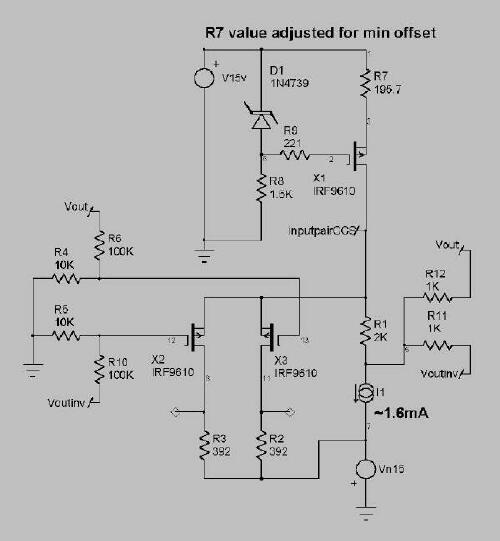

Grey, I think it might be best to use both resistors from outputs to ground and the bridge feedback to the input diff pair Sources. Otherwise, since the the latter represents a fairly low impedance input, you will need pretty low value CM feedback resistors. Simulation indicates that approx 2K resistors are required to achieve much the same effect as the 30R resistors to ground. Perhaps using both, but with larger values might be the optimim solution?

I know that Ian was saying 2k, but I want to test that in the real world, as I believe that he's still working from simulations. My feeling is that unless I can find a value that allows me to completely delete the grounding resistors, there's no point in putting in the resistor bridge. My experience here was that the amp was really quite stable once it was adjusted, so unless the grounding resistors can be removed entirely, there's little to be gained by throwing in more parts.

Grey, Grataku, attached is a simplified schematic based on Grey's basic circuit, but showing the common mode feedback resistors. Grey is correct, so far I have been using a simulator, but it is one that has proved trustworthy, at least in determining whether something will work. Distorion analysis is something else however. The circuit shown has reduced currents (I am building a headphone version) and uses 3.9K CM feedback resistors and no output resistors to ground. This gives about the same performance as the 30R resistors from output to ground on their own. Sensitivity to diff pair input current is about 3.2V/mA. Personally I would use both techniques but with larger resistors but I wanted to prove that it would work without the output resistors. I've also included a simulated frequency response - make of it what you will.
Ian.

I would AC couple the inputs and move the 68K resistors to the inputs. I think the 68K resistors form a common mode impedance to ground the will compromise the performance of the circuit when driven with a single ended input with the other input at AC ground.

Unfortunately it does not seem to be so simple. The 68K resistors from input to ground appear to be essential when the common feedback scheme is employed. Lowering their value improves the stability of the circuit, whilst removing them or placing them as suggested causes the whole thing to become jumpy. Presumably this is because they form the DC reference against which the CM feedback is applied? Whatever the reason, these become much more important than the output resistors to ground with this variation on the topology.

Hmmm.... If the 10K input resistors are AC coupled, moving the 68Ks to input sides would look like 78K to ground instead of 68K to ground for the input feedback resistors at DC. That really drives the circuit nuts? Do you also have the 2K resistors to the outputs and the 30 Ohms to ground for your model. I actually like the idea of these 30 ohm resistors as they are also helping to buffer to open loop output gain against variations in impedance with frequency. Particularly at bass resonance frequency. I am tempted to drop them further down in value.
