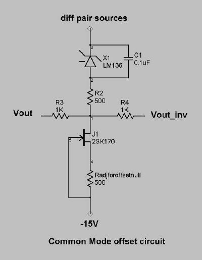

Offset Null Circuit for Aleph X
Harry, your idea is similar to one I mentioned in a (now rather old) previous post.
It is a nice idea and I see that yours is different from mine in the addition of R1. However, to some extent are you not just moving the problem elsewhere? If the current from I1 is not exactly correct, will it not create its own, unwanted DC offset?
Ian.

Offset null
No..... I think we are talking about different points. The idea is the keep the juction of the common mode feedback resistors ( between the outputs and input sources junction) at a zero volt point so as not to dump AC current into the sources of the front end diff pair. The circuit adds a DC offset to this junction to match the gate to source voltage of the input mosfet diff pair. DC feedback is still there, but no AC current into sources. Go put a few different values of output voltages and the opposite polarity of voltage on the other output and you will see currents into the sources due to the DC offset of about 3 volts the junction of the input sources relative to the 0 volt average of the the output voltages (as they swing differeny polarities from each each other with the same amplitude.)

Offset null
I beg to differ (in terms of talking about the same thing) - I think we were both trying to address the same problem Probably I wasn't sufficiently clear and I did rather quote out of context. Anyway, enough excuses from me.
I still think that you may have a potential problem with DC offset produced by the addional current source if it does not produce precisely the right value, but perhaps I have an exagerated impression of the effect. I'll have to get the old simulator out again...

Pretty Solid
I agree, your CM offset null circuit is pretty solid. However, I also feel (in keeping with both you and Nelson I think) that it is probably overkill, i.e. is the problem it solves really a problem at all? The performance of the circuit with and without the Vgs correction does not appear to be that different and the adjustment on the diff pair current source will still be required. It might be worth noting though that the ‘problem’ is considerably reduced if a JFET input stage is used…
The diffential offset wound be reduced but you will have the same
common mode offset effect for the same given current source for the front end. Stability of the current source is very important if the offset is not to drift with temperature and power supply voltage. That is why I am using a voltage reference and fet current source to bias it instead of a zener and resistor. For those comptemplating a jfet front end be aware the jfet doesn't have as high a transconductance as the mosfet front end and the drain resistor will have to be higher for the same open loop voltage gain. This will increase high frequency distortion and reduce bandwidth for the amp. The aleph front end and output are a much more synergistic combination than one would think at first glance.

Current Source Bias
Just to clarify, I was talking about the Vgs offset being smaller (and opposite in polarity) for the JFET front end. I realise that the common mode offset is critically dependent on the input current source stability.
I'm a little confused by your comment about alternative bias for the current source - are you referring to your recent post? I thought this subcircuit was connected to the sources of the input MOSFETs rather than the gate of the current source. Can you clarify please? BTW, I completey support the idea of stablising the current source as much as possible - this will have benefit for both the DC and AC common mode output.
Regarding your comment about replacing front end with JFETs. I reduced the value of the current by approx half and doubled the drain resistors. The (simulated) frequency response using J109 actually improves over the MOSFET front end and rolls off more gently. I'll publish the traces when I'm back at home.

Current source reference
My reference to current source bias is for a fixed current source such as that for all the aleph amp front ends. The tempco for a zener and the variation in zener voltage with varying supply voltage is probably not optimum for a very stable current source. For lower value supply rails this becomes more of an issue as the resistor becomes small for the same bias current through the 9 volt zener. With Grey's value of 1.5K to bias a 9V zener from a 15 volt supply, I would estimate that the zener voltage will change about 10 millivolts for every volt change in supply voltage.
I believe the dominant pole is the drain resistor for the front end and the gate to souce capacitance of the output stage mosfets. You are moving this pole away other poles in the response of the amp which gives a smoother roll off. I believe you are also reducing the open loop gain of the amp increasing output impedance and distortion due to less open loop gain. The ZEN articles discuss the effect or souce impedance on high frequency distortion for the common source mosfet gain stage and are well worth reading for insight into this distortion mechanism. As always thanks for your very learned input. What Spice simulator are you using so we can compare and maybe swap device models?
Thanks for trying to clear my confusion. If I understand you correctly, you are using the same bias scheme for the front end tail current source as you posted for DC offset null purposes, i.e. same scheme – different application. Am I correct in assuming your primary focus here is DC (static) stability in the face of temperature and/or supply voltage variations? I ask since the obvious alternative is the typical two transistor/MOSFET technique in a feedback scheme. This would of course also affect the dynamic performance of the current source. Do you see the latter as a problem or is there another reason to prefer the single device current source?
You make an interesting point about the dominant pole of the Aleph-X circuit – not something I have yet investigated. My intuition tells me you are probably right though, seeing as how the high frequency response is so strongly influenced by the impedance of the driver. In addition, the frequency response traces seem to support the theory (see attached). I am less sure about the reduced open gain – surely the larger driver drain resistors will tend to compensate for the lower transconductance of the JFETs? In any case I see no increase in simulated distortion, though I don’t much trust this aspect of Spice simulators. I didn’t think to try and measure output impedance with this modification, but will have a go shortly.
Spice simulators – now that’s a thorny topic. Most that I have encountered are not all that good or else they are way too expensive. CircuitMaker has a nice user interface but its simulation ability is not in the same league, e.g. it doesn’t cope well with current sources and will frequently fail to converge on a solution at all. I wasted my money on a copy of EDSpice some time ago and it has proved of no use to me at all. I am currently using a student version of Pspice (from Orcad). This has an inferior user interface (compared with CircuitMaker) but does a much better job of simulating things accurately. Unfortunately I cannot afford the commercial version. The student version has too few models and imposes a small limit on the number one can import/create. If you know of anything better that is available at a reasonable price (I would be willing to pay two to three hundred dollars) then please shout! Compare and swap device models? By all means though I doubt that I have much that would interest you.
