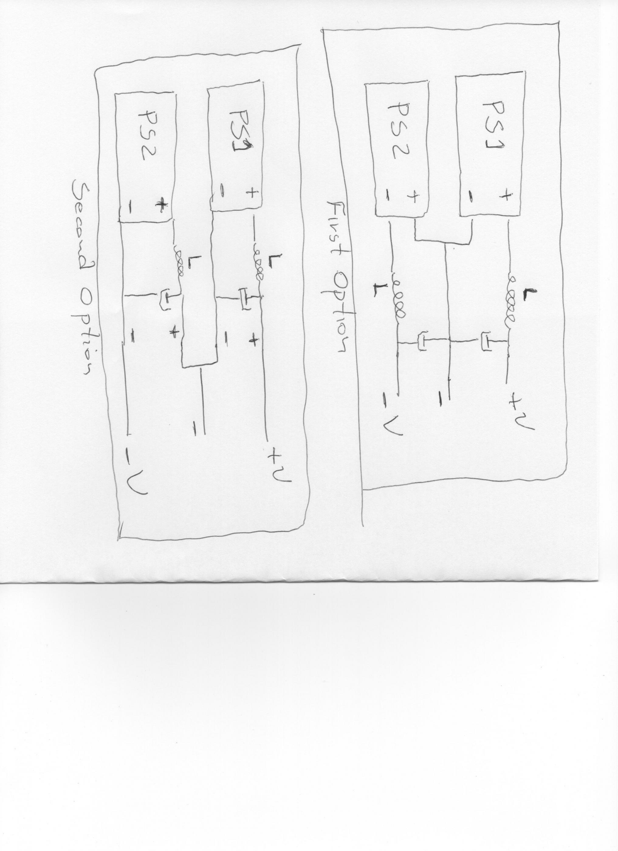

I need to use two switching power supply to make a +/-V. I want to better the original filtration from these PSU and i do not know how would it be the right way to do this.
I drew two options and i would like you all to help me pointing which one is the right or best way to do it.
I thank you all that should take some time in helping me.

first option is certainly more logical
be sure that switcher outputs are really floating , ie. not connected to case

What do you mean dady? The same about my options one and two or the same meaning that you agree with Zen?
practically/electrically these two options are the same
but , I repeat , first one is more eye pleasant
Brother Fabio, if you see the current sense the circuits are equivalents. But looks more handsome for the eye. ZM is an aesthetic man.
Best Regards for both Gentlemen.
I myself agree with the two of you, i thought both were right and i was up to use the first because it "looks" righter to me, but i was afraid that could be something that i could be missing. Knowing that you agree give me confidence to go this way. Thank you for helping.
