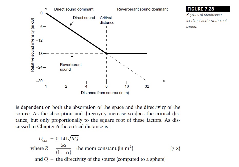

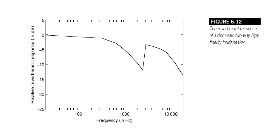

from "Acoustics and Psychoacoustics" by Howard and Angus, 4th ed., Focal Press 2009, Chapter 6: "Hearing Music in Different Environments":

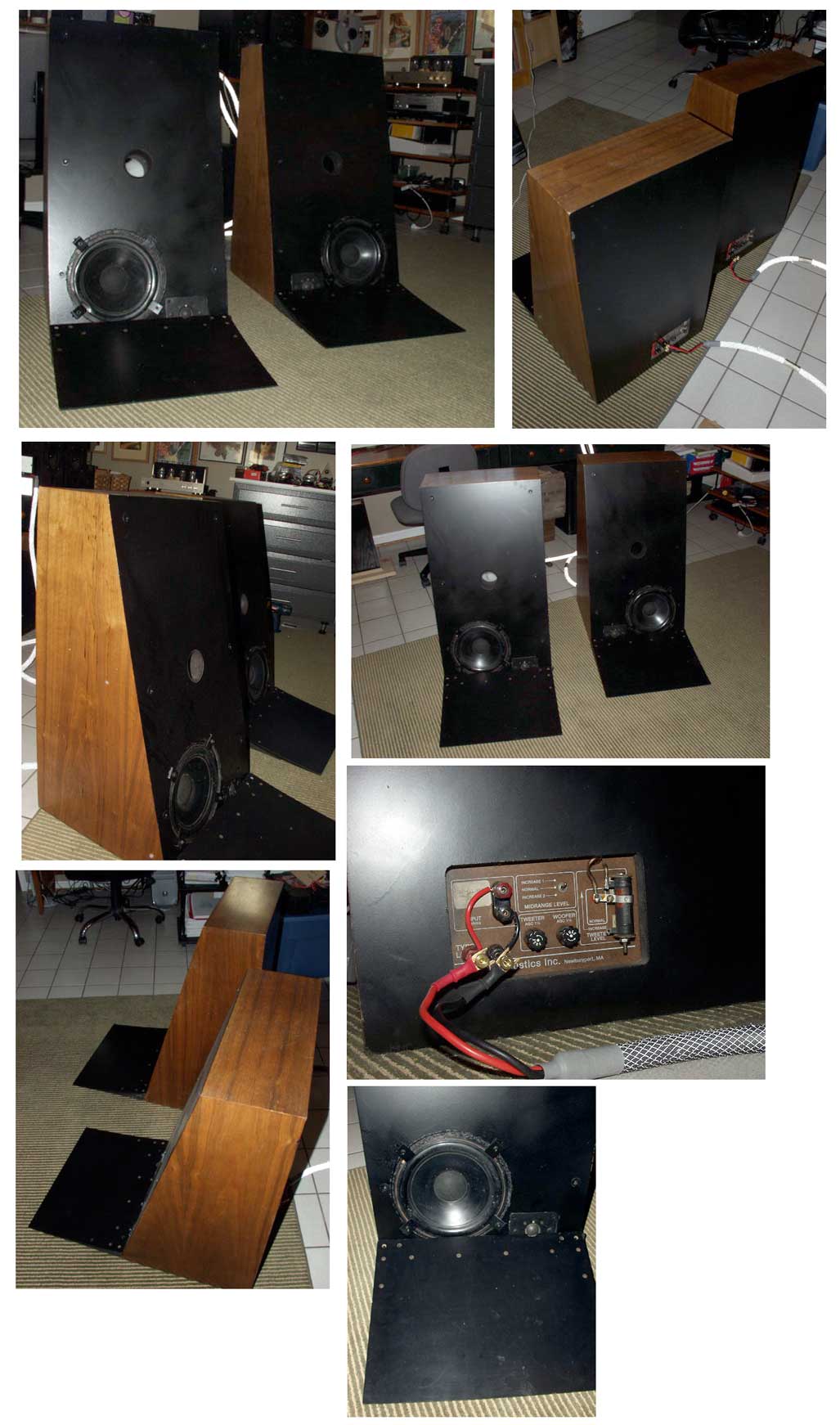

I believe this one belongs in this thread:
One of Peter Snell's earliest design, the 'type 1' had the tweeter at the very bottome of the cabinet that included a bottom 'flap' to reflect the tweeter's output. However, that was the end of that approach. Peter later went on to create the Model "A" and the rest is history.
http://www.diyaudio.com/forums/multi-way/136887-snell-type-1s.html
Stig Carlsson referred to this design in His patent application
The model A preceeded the type 1. At Snell we referred to the type 1 (affectionately) as "the wheelchair ramp". (It had a shallow ramp leading up to the mid point of the tweeter.)
Not a big seller.
Note that in my testing the critical distance in a typical listening room is about equal to the listening distance. That is, you here direct field and reverberent field in roughly equal proportions. No matter what, your ear/brain is pretty good at hearing through to the direct/early sound.
Be careful when giving credance to RTA curves over direct field measurements.
David
so 2-3 meters? in a typical listening room? are You sure? which frequency band? what is the directivity of loudspeakers used for those test?
