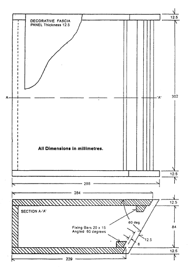

as to Jordan's linear array system He recommended that the stereo base could be as much as 15 feet wide with very flat loudspeakers wall mounted and toed in 60 degrees so their axis cross well in front of the listener area
