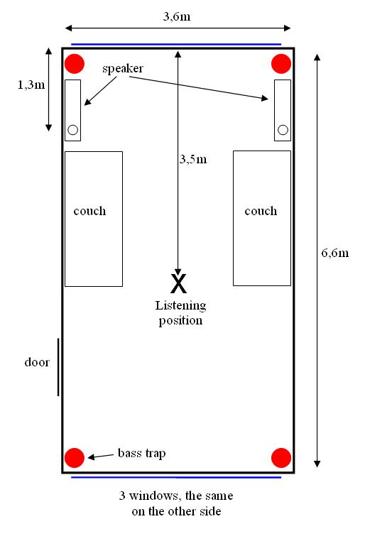

can You post a schematic drawing of Your current setup - how exactly the loudspeakers are positioned?
best,
graaf
I never attached a file before, just hope it will work...!
The ceiling is at 2,4 m and the LS are 35 cm deep. They are lifted above the ground by pieces of wood so that the driver is around 40 cm above the floor.
Etienne
now I see, thanks fo the image 🙂
nice room, I think that those couches can take away the highs
perhaps You can use some kind of passive or active equalization instead of elevating the loudspeaker higher?
best,
graaf

I lifted up the LS so that the driver is at the same height as the armrest of the couches. So far it seems to be an improvement but I did not listen to that much music.
Etienne
