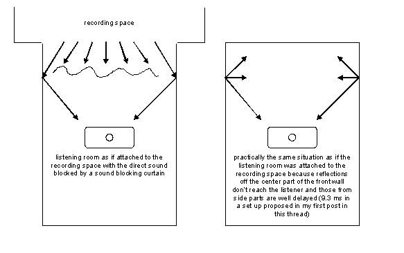

syntheticwave said:
We are far away from the goal of realistic reproduction by all phantom source based procedures.
well, psychoacoustically the loudspeakers are perceived in stereo as early reflections of a sound whose direct version we missed
what is wrong with that? seems to me that nothing per se
what is fundamentally wrong is rather the positioning of these early reflections in a room
it is having these early reflections in a middle of the room what is higly unnatural and leading to lack of realism
try damping of the wall in front of the listener and Beveridge positioning where the loudspeakers are acoustically integrated into the side walls
what do You think?
best,
graaf

probably what He refers to is head related transfer functions (HRTF) and especially the pinnae functionsEtienne88 said:
he also says that parameters such as timing and intensity are not sufficient to pin point accurately a source. He doesn't say what else is needed to achieve the accuracy quoted earlier (1 to 3 degrees between 100Hz and 10kHz)...
"high directivity for the high frequencies" and omnidirectional dispersion pattern are needed to make the individual loudspeaker in a two speaker stereo array harder to be distinguished from the side wall and harder to be localized as a distinct sound source and a real (and separate from the room acoustics) cause of virtual sound imagesEtienne88 said:
Some of your requirements are high directivity for the high frequencies and early reflections coming after 5ms, 10 ms being much better. So far, so good! Then you place the driver firing upward. Since the later is directive in the highs you will have very little direct sound and mainly delayed reflected sound...
the aim is to acoustically integrate the speakers into the side walls just to make the room acoustics to be a carrier of left and right signals
by making the loudspeakers very short and positioning them next to the side walls I want to emulate (as close as is possible with dynamic cone driver) the Beveridge line sources
the additional advantage of high directivity in such a positioning can be less amount of detrimental high frequency "very early reflections" off the adjacent side wall
yes, in such a set up what we perceive in the highs is mainly sound vertically reflected off the ceiling arriving at the ears with about 10 ms of delay
but this is not a problem because the hearing mechanism is processing what the ears receive in "stages" or "phases"
the first stage is sound source localization and it lasts <1 ms counting from first wave front arrival at the ear, the second is sound source size assessment and it lasts for the next 1<30 ms, the third is sound source identification which begins with pitch recognition occurring between 10<30 ms
thus all sound source localization is done completely before the delayed reflected sound reaches the ears, no problem at all
moreover, in case of sound localization in reverberant space like a room hearing relies mostly on time difference mechanism - the law of first wave front and the precedent effect (Haas effect) and additionally on phase difference mechanism and in that regard most important are the spatial cues around 1 kHz at which my speakers are not yet that much directional
on the other hand the spatial cues encoded in a stereo recording are in most cases of the intensity type or at least they should be according to the original Blumlein stereo patent and a coincident stereo microphone set up invented by him for that application
this is simply how "stereo" should work
unfortunately this is often ignored diminishing the standard stereo ability of realistic spatial reproduction even more

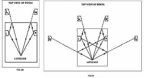

Etienne88 said:
I don't get how this can lead to "absolutely more realistic than the standard stereo - occupying a real space, 3D, very palpable images" as you said yourself. I'm not questioning your feelings, I just try to understand the mechanism(s) behind!
I am also nor completely sure about that 🙂 I am only hypothesizing
and as I have already pointed to above in the thread the main problem with realistic spatial presentation of sound in audio reproduction at home is with the fact that we are listening to the speakers perceiving them as distinct sound sources, we are hearing the speakers – something that has no counterpart in nature
in spite we should listen to what the speaker do while staying unaware that this is done by the speakers
ambiophonics is trying to achieve that by the means of stereo crosstalk cancelling and making the listening room a little anechoic chamber 😉
in that way the speaker themselves are made "invisible" to the hearing
but I believe that this can be done as well by integrating the speakers into the side walls instead of projecting the sound in the direction of the listener
in that way we can perceive that sound just occurs in the room like it would be if the room was attached through the wall in front of the listener to an original recording space (see image attached)
Etienne88 said:I will try your set up myself and read the Carlsson white paper you linked to.
I recommend to You the Beveridge white paper in the first place
http://www.bevaudio.com/White_Paper.htm
my approach is a sort of combination of the two ideas - of Carlsson and of Beveridge, and more precisely - while trying to emulate Beveridge loudspeakers’ radiation pattern I arrive at something resembling Carlsson speakers
it just happened that way - Carlsson was not my direct inspiration
best,
graaf

well, in small rooms, in most listening rooms, with standard loudspeaker positioning the time delays are typically <10 ms
this is why I say 10<20 ms or 10<30 ms is no difference in practice
only from that perspective
I’ve demonstrated in my first post in this thread that by means of special positioning of special loudspeakers in a room we can achieve a delay of around 10 ms for every reflection, floor and ceiling included, in bigger room perhaps even up to 20 ms but with very high ceiling, a really big room
and 30 ms of delay is not realistically achievable at all
I understand that with CD speakers like Summa or AI-Audio something different is achieved - the level of reflected sound is lowered, reflections are as if they were filtered with a low pass filter
and with the positioning I proposed the reflections are not filtered nor lowered in level but delayed by around 10 ms or more
are the effects comparable? can this two approaches be regarded as equivalent alternatives? like in time/intensity trading?
can we just choose a solution best suited to our rooms acoustics or décor?
who knows?
I don’t know
but why not? it makes sense

I drew the sound path lines, calculated them and then I calculated the delays. The only assumptions I made is that "the speed of sound = 344m/s"
and also that "angle of incidence = angle of reflection"
two assumptions
I have found similar way of reasoning and same assumptions in Harold Beveridge brochure (see image attached):
Now let's look carefully at figures 20 & 21. The direct path of energy from speaker to listener is obvious and there are no near images.
Three important points need to be made. First, these full frequency range reflections are identical in form to the direct path sound. Second, they are nearly as intense as the direct path. Third, the delay in these paths is easily made large enough to avoid confusion and the ear accepts them as normal room reflection. This adds spaciousness and depth to the sound.
In stereo, an exact and precise "image" of the orchestra is desired: violins on the left, cello and bass on the right, and so on. Such an image is best produced when at least 10 milliseconds of the first-arrival energy is delivered to the listener with no overlap of sound from image speakers to produce confusion.
180 degree cylindrical wave speakers meet this criterion. No near reflection paths are present and no near image speakers appear. All four image speakers are far enough away from the primary speakers for a clear and unencumbered packet of first-arrival energy to be perceived. A precise stereo image is formed.
see: http://www.bevaudio.com/White_Paper.htm
is anything wrong with that reasonig? the law of reflection does not apply in this case? I don't know - I assume that it applies
Is this assumption wrong?

344m/s is OK for the speed of sound in the air at 20ºC at see level! 😉
click this link if you need to discuss that in details. 😀
More seriously: your second assumption is not always true. It is not true for the lower frequencies were ray theory can not be applied any more, wave theory has to be applied.
Where does this transition take place is the obvious next question!
First this transition does not take place at one unique frequency below which wave theory applies and above which ray theory applies. The transition takes place over 2 octaves during which both ray and wave theories rule.
The frequency where it starts (= the frequency below which wave theory can be applied without doubt) depends on the volume of your room and the absorption properties of the room. It follows the following formula:
F2=11250*SQRT(RT60/V) RT60 being the reverberation time in seconds and V being the volume of the room in cubic feet.
This formula yields F2=180Hz for a room of 63 m3 (25 m2 by 2,5 m which is more or less you room, if i remember well...) with a RT60 of 0,5 seconds.
The other frequency (the one above which ray acoustics can be applied without doubt) is 4 times the previous one.
This yields F3=720Hz for the same room as before.
All this comes from the Master Handbook of Acoustics by Alton Everest, page 324.
From that I can say that the assumption "angle of incidence = angle of reflection" is true from the highest frequencies down to F3, is less and less true from F3 to F2 and is unappropriated below F2.
