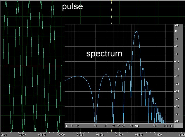

Hello,
5 periods of a a 100Hz pure tone (sine) will possess a complex spectrum (a lot of components with f < 100Hz and also some over 100Hz). It will most surely not sound as a pure tone...
Give a look to the spectrum of a pulse made of 5 periods of 100Hz sine in the attached file. (the 5 periods are preceded and follown by 10seconds of silence.)

Hello,

Jean-Michel
No one would do it that way!! And in all my discussions I said a "wavelet" meaning a slow rise and fall of the wave. This would have a very narrow range of frequencies centered on 100 Hz. But of course you knew that, which makes me wonder why you made such a comment.😕

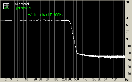

So I thought I'd try this test.
All the tests were done with only the woofers on, no mid or tweeter. Woofer low passed at 450Hz, 3rd order.

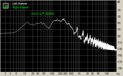

The voice file does contain info above 300Hz, see my FFT graphs below. However the 300Hz white noise does not contain much, I used a steep filter.
For me, the trouble comes with pure sine waves. I'll try to test where white noise has to be low passed for me not to be able to locate it on my system.
Interesting stuff!
- The filtered Voice. No problem telling where it came from. In fact I had to turn off the right channel to even hear the left.
- White noise low passed at 300Hz. Also very easy. No mistake.
- 300Hz sine wave. It came out of the wrong channel! Until I realized that it was actually coming from where I put it. But because I happened to be looking at the silent speaker, it "stuck" there. Had to move around some to unstick it. But, sitting between the speakers it seemed to come mostly from the center.
Interesting stuff!
Markus
If thats the stuff that you are putting out as "LP filtered above 300 Hz", thats pretty shabby.
