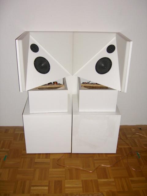

I had the right-collapse again and it turned out that not the loose screw but a broken wire was the problem. What's good about it: This time I can say what bass driver was not working: It was the right one. Everyone would say intuitively that this can only cause a shift to the left, but obviously an error in the bass on any side enhances my right-tendency and causes the image to collapse to the right.
I still have the slight right-shift caused by my brain, but with both final enclosure AND correct crossover I was just enjoying the Johannespassion with the Bach Collegium Japan from the BIS label more than ever before.
