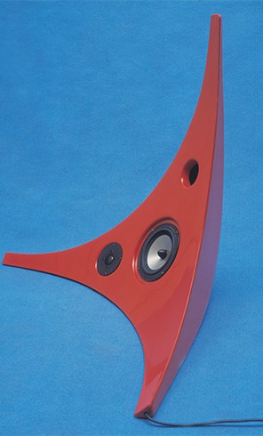

take a look at those pictures:
http://www.diyaudio.com/forums/showthread.php?postid=1634295#post1634295
http://www.diyaudio.com/forums/showthread.php?postid=1634297#post1634297
and then at the image I attached to the post No 1 in this thread
how about that! 😀
it is nice to see that Mr Linkwitz came to the same conclusion about omnidirectional speaker's placement in small rooms 😎
best regards!
graaf

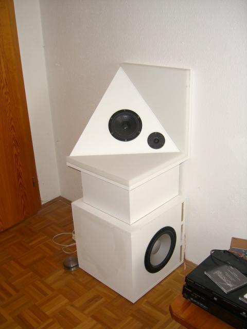

Update to the Carlsson project:
After listening to the prototypes for many months I now have the final version running with much better damping inside (rock wool instead of polyester fleece) and outside (Basotect instead of polyester felt). While I am very happy with the tonal improvement I dislike what happened to the imaging. The prototypes had an excellent imaging when fed with real-acoustic recordings and some problems with synthetic acoustic: The instruments were either fixed to the speakers or formed a clump of mud between them. Now the real acoustic recordings are diffuse and without depth, whereas the synth acoustic recordings are much better now and in fact the field where the speakers perform best.
I suspect that the basotect is to blame. I held the polyester felt to my ears and found that they have almost complete transmission, so the triangles probably formed reflectors rather than absorbers before.
Now I am trying to find a compromise. Thinner Basotect may be a solution, but I would be happy to get rid of it completely because it is very fragile. What about real wool felt?
