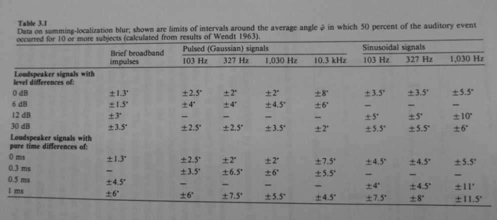

Yes, you are most correct. I also see often references with smallest notable time difference between the ears being in order of 20us.
Also I don't know why these things are not more widely known. Maybe people read too many hifi magazines instead of scientific publications 😀

Not so. Do some more reading. From Blauert Spatial Hearing there is case with two loudspeakers in s stereo triangle. Freq range is from 100Hz-10kHz. See, there is practically NO change in localisation accuracy when freq is getting lower. This is the results for phantom image localisation blur. The blur is very small, only about couple of degrees! Who tells you human cannot localise sounds at low freqs?!?
- Elias
gedlee said:First, there is no data below 500 Hz so what happens at those frequencies is not supported in any way by Blauert's book. Also the chart shown is for real sources in free space and not the localzation of phantom sources from a stereo signal in a small room. Hence it is almost totally inapplicable to the question at hand.
- Elias
