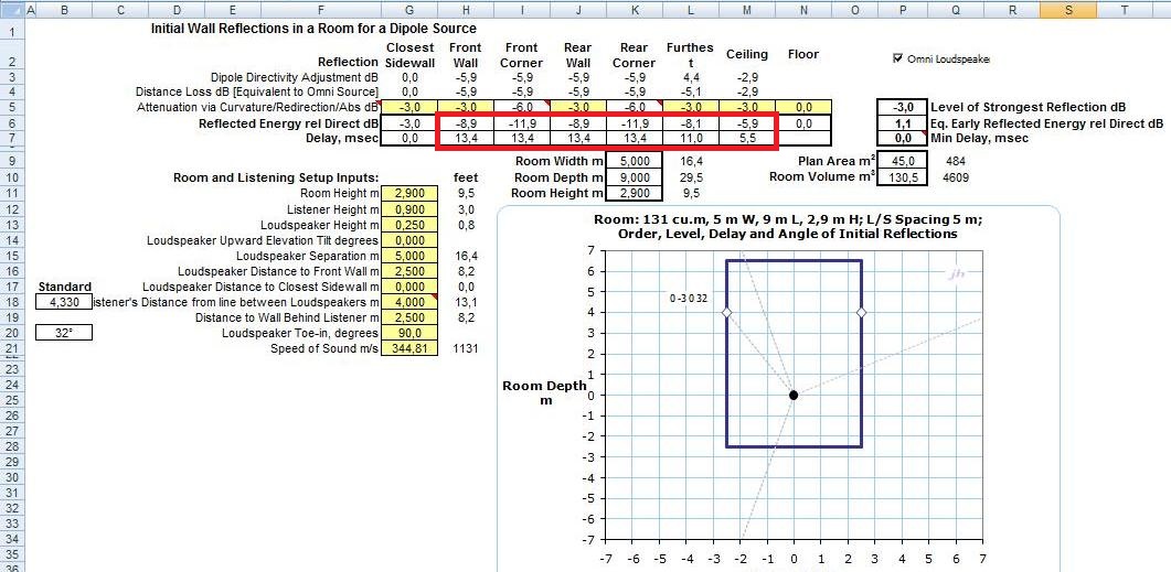

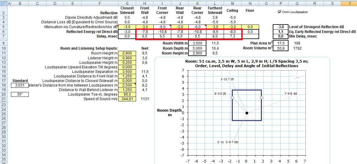

and below is shown how it looks - in a small, medium and big room respectively - according to the spreadsheet from Linkwitzlab website, exactly as predicted and quite as good as it gets as well I would say

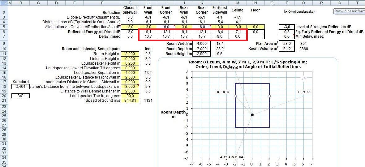

let us see what it takes to place a conventional stereo triangle of similar proportions, with speaker moved into the room away from the side walls, in a room of similar size, and how the pattern of early reflections looks then 🙄

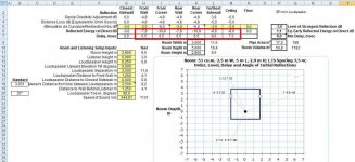

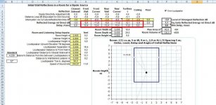

That's what I experienced when rotating my dipoles 90°. I calculated the early reflections with James Heddles spreadsheet at http://www.linkwitzlab.com/LX521/Dipole First Room Reflections SL rev3-a.xls
View attachment 357016 View attachment 357017
Left picture is what I have at home - and like 🙂. Right is the Stereo Unlimited proposal 🙁.
Rudolf - please explain 🙂

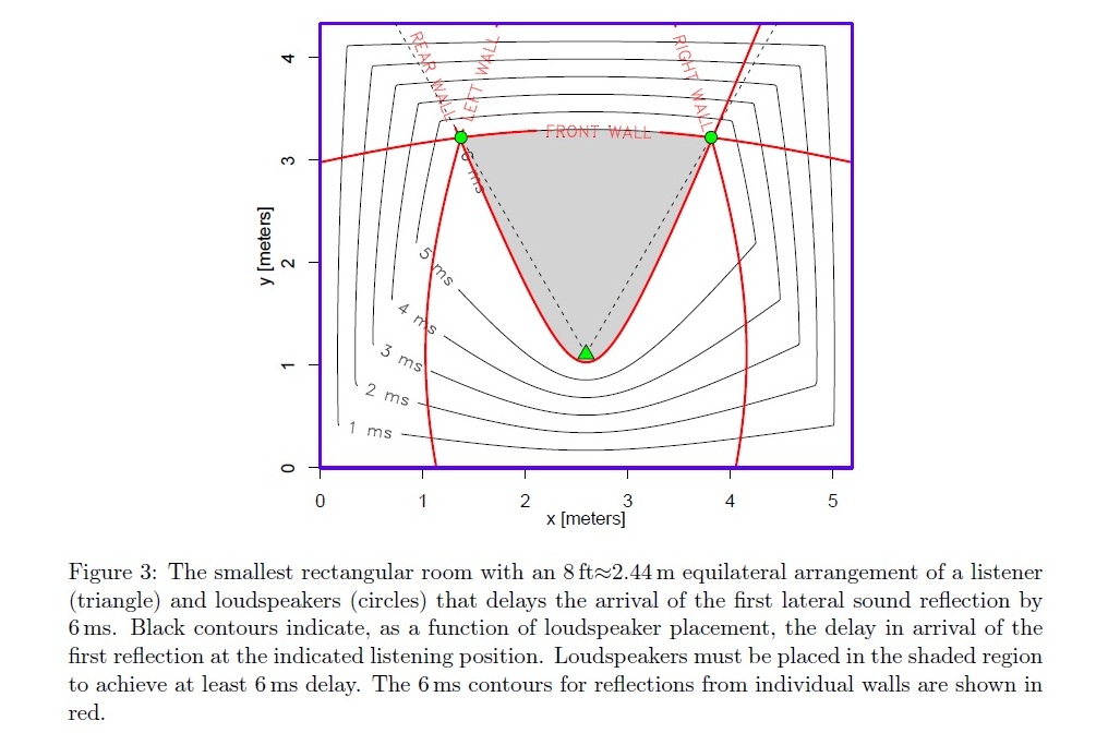

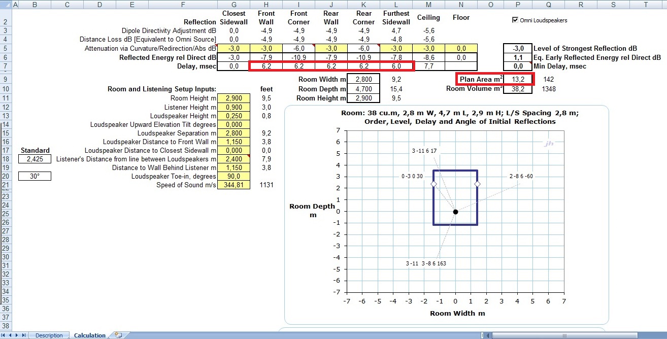

Mr Taylor's the smallest room usable for stereo reproduction is around 21.8 m2
whereas in fact the smallest room can be as small as 13.2 m2 (see below) HUGE - 40% - difference 😀 😎
  • the smallest rectangular room for 6 ms delays with 'Beveridge' side-wall placement method.jpg
If early reflections in the room are only 6-10 dB down and only 6-10 ms late, they mask some information in the original recording and introduce new unwanted localization hints, thereby smearing the original localisation information.
This doesn't need to be certified by theory - it jumps at you when listening to it. And it doesn't become wrong, because some individuals don't care about it.
I have early reflections down at least -15 dB for the first 15 ms with just a few room correction measures, and this helps significantly already. -20 dB for the first 20 ms would be even better.
..."some" ...perhaps 🙂
including the floor and ceiling reflections?
Besides, on the spreadsheet diagram that You posted I can see that @~8 ms there is one reflection -15 dB and two -21 dB. As these are calculated on some assumptions and as You do the measurements - is this confirmed by measurements?
