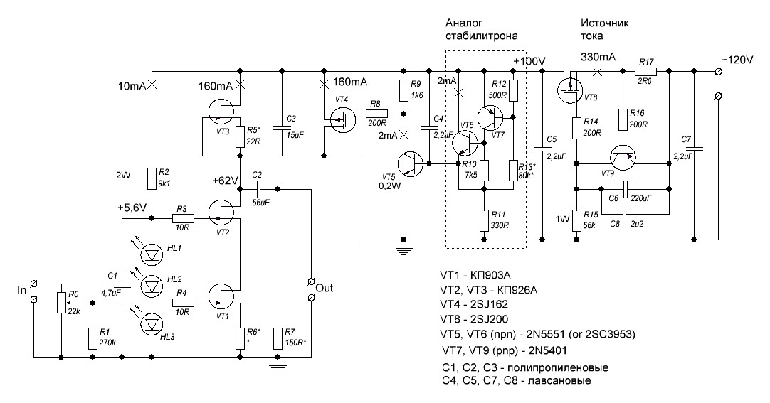

For the Power Zen9 being discussed here a choice of preamp becomes quite important, since it must work for 3k4 impedance and provide large amplification.
As a possibility, I use the following preamp. Analogs for transistors are:
KP903 <- CP650
KP926 <- 2SK60
The preamp itself is three first transistors only. The rest of schematics is shunt power supply.
KP903 <- CP650
KP926 <- 2SK60

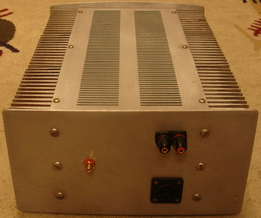

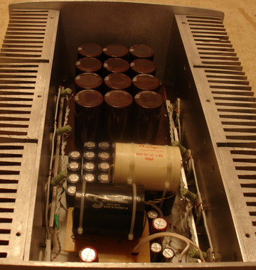

Well, I tried to remove comletely the components of current source modulation from 4,8A Zen9 monoblocks. So, now it is without Aleph CS. With a resistive load 5,1 Ohms, I have measured 17,8V RMS non-distorted sine signal, it is 60W RMS output power.
As for listening impressions, as was expected, now it is more transparent, better microdynamics, hardly possible to distinquish from SE 300B tube amp. Bass has become a bit less impressive, but I guess it will remain without Aleph CS. At the moment I do not have any wishes as per further improvements.

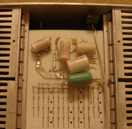

Also I have replaces small 0,15uF shunts by bigger ones (5u6 and 6u8). The monoblockes are made by p-to-p soldering, on the 2mm teflon plate. Inp and Outp connectors are gold plated bronze.
