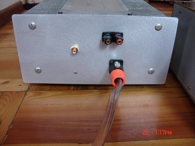

Speaking about mechanical design of class A power amps I would like to vote in favour of monoblocks with external power supply. This idea is supported, in particular, by listenable positive effect of exsessive power transformers, and by possibility of using the same power supply for different amps. In my case I use the same power supply for both Zen9 (shown in post #4) and Zen4 (picture below).
