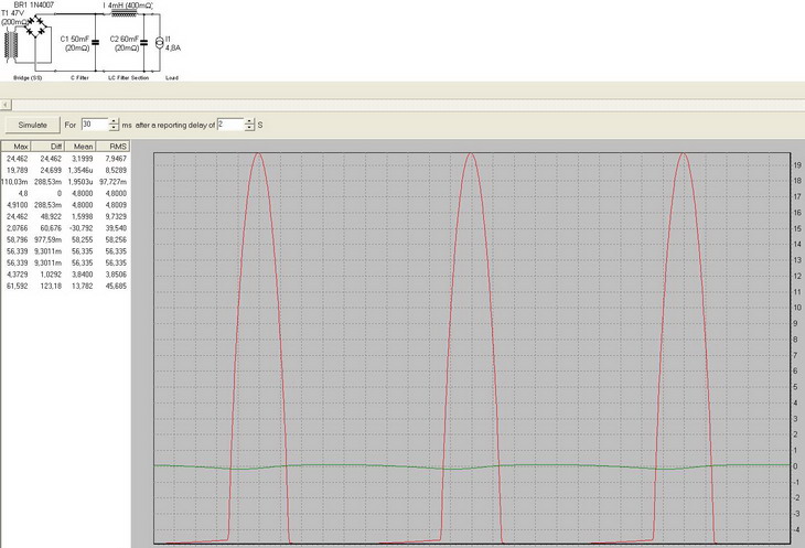

For schematics with elevated quiescent current, like for instance 4,8A, some cautions must be put to power supply design. Enclosed is a result of simulation of C1-L-C2 filter loaded by 4,8A constant current source. Other values are visible from the picture. Time dependences of currents through C1 and C2 are shown. Important is that RMS current through C1 consists 8,5A, while through C2 it is 0,1A only. So, one must care not only about the most important big C2 value, but possibilities of C1 as for acceptable ripple current must not be violated.

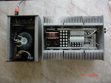

I see your point quite well. I did make a year ago a 50W version of Zen9 as stereo power amp. My god, sometimes I had to ask somebody to help me in moving it from listening place to working bench. It weight is close to 40 kg. You can see this monster in the enclosed picture.

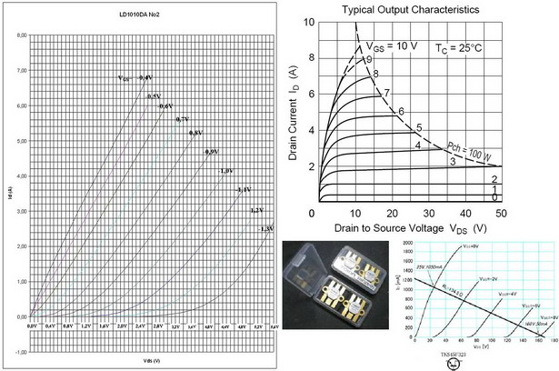

Below is a picture with measured output characteristics of LD1010DA transistor (i.e. dependences of drain current Id vs drain-to-source voltage Vds at various fixed gate-to-source voltages Vgs). It illustrates nicely the triode-like features of the device ingeniously apply in real schematics by Nelson Pass. The transistor was mounted on a heat sink during measurements. I hope this picture could be useful for DIYers who build Zen9 or F3.
I also have attached typical output characteristics of a pentode-like MOSFET (2SK1058) and of V-FET (or SIT) transistor TKS45F323. The last is really behave as a solid state tube. I would be very grateful if somebody knows where or from whom these TKS45F323 could be available.

flg said:
Great work Vladimirk :D
Now I need some time to digest...
I'm not familiar with the TKS45F323 or SIT? You don't mean SiC do you? I go search...
Vertical FETs or, in other words, Static Induction Transistors were discussed many times at this Forum, but the type indicated above is the best for audio among them.
Not the same, but similar transistors were used in the legendary Yamaha-B1 ana Yamaha-B2 amps.
Obtaining the TKS45F323 transistors would give big inspiration for every DIYer for a next project.

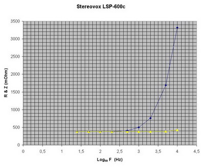

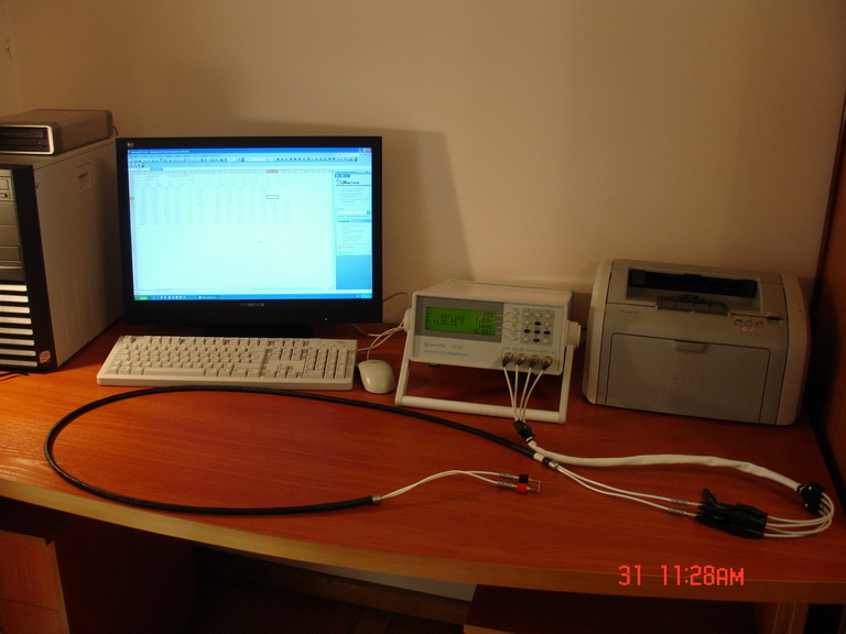

Speaking about the Damping Factor of power amp (this parameter is not so good with Zen or FirstWatt F amps) one should also remember about speaker cable. I’d like to show interesting measurements done with top-quality speaker cable STEREOVOX LSP-600c. Variations with frequency of absolute value of the cable impedance Z and of active component of this impedance are shown in the picture below. Next picture illustrates measurement setup used for these measurements.
One can see, that very well sounding cable measures terribly bad, its Z rises to several Ohms at 10-20 kHz ! It measures worse than a piece of cheap speaker wire. This story resembles situation with THD parameter.

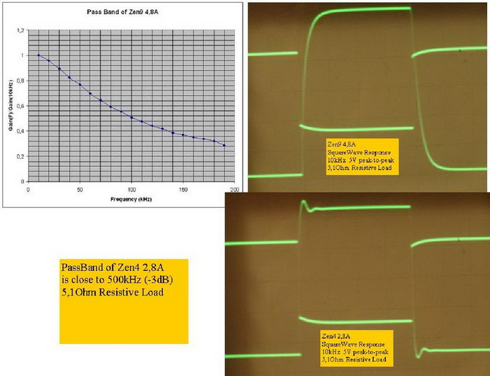

In the picture below I show the results of measurements
1) of Gain variation with Frequency (Pass Band measurements) and
2) of 10kHz Square Wave Response
for the Zen9 4,8A and Zen4 2,8A monoblocks. Load is 5,1 Ohm resistive.
Zen4 is approximately 10 times faster than Zen9 and indicates some problem with periodic set-up process, possibly its NFB compensation capacitor should be checked.
But what I would like to stress, listening of both amps (by me and several friends) do not reveal differences in highs reproduction, they are very subtle (if any), nobody can give preference to definite device. The bass and mids are better a little bit with Zen9.
At the same time, we immediately feel difference with highs, if we connect cheap speaker cable or replace output capacitor C1 (the replacement does not affect measurements).
The question is, again, to which level measurements are important and have sense ?
