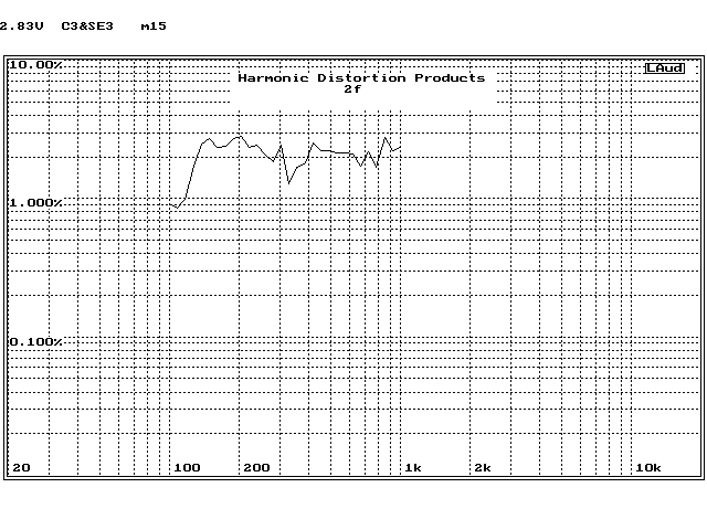

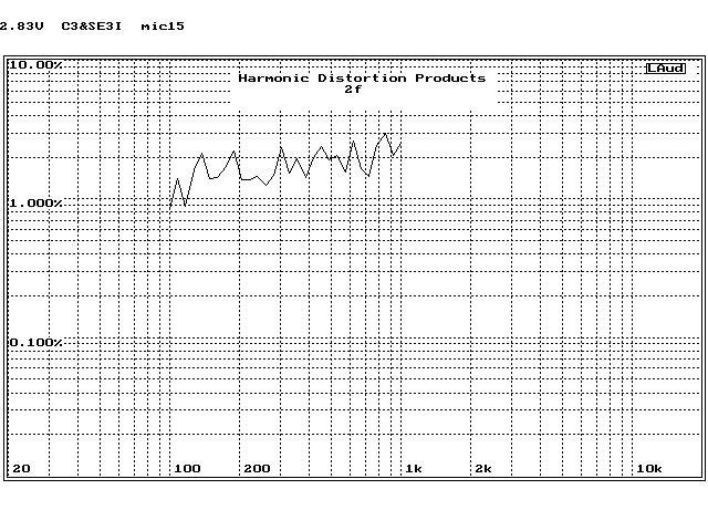

sam9 said:
I'm not that good withe math but I get the idea. Since it should be easy to test the theory I would have been more impressed if there had been traditional THD vs. Freq plots.
One for a good low THD power amp plus the Audiopax speaker.
vs
One for and Audiopax SE amp plus the Audiopax speaker.
The former would show pretty much the THD of the speaker itself. It the theory works the second should show a lower THD indicating that the additional THD of the SE amp "compensated" away some of the inherent THD of the speaker.
I have *some* graphs:
Speaker distortion when driven by a 0.05% amp:
