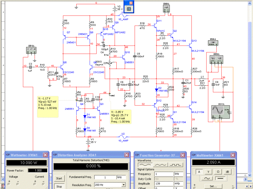

nitrate said:Once more i find my self tredding along the long path of audio engineering when anougher set of awkard questions are found buzzing about inside my head that demand attention from the masses.
First the question :-
Does vanishingly small amounts of THD in an amplifier GUARANTEE good sound and fine music reproduction?
Explanation :-
I've been developing a classA amplifier for a while and its been on the test bench for far too long now. The problem is i want it to be my best work to date but i'm convincing myself that it dosn't sound that good. I also bought a copy of Selfs 'Audio Power Amplifier Design Handbook'. After reading the book cover to cover i decided to apply some of Selfs methods for reducing THD across the entire amplifier design. After doing this on the sim my amp went from approx 0.065% / 0.016 THD 50/1 Watt to 0.002 / unmeasurable ( < 0.000 ).Everything seemed good, no measurable THD on the computer via RMMA ( crap soundcard but it said the previous attempt was not that good lol ), good squares and sines on the scope with no noise, 20v/us rise and fall etc. I am convinced there has been a dramatic improvment just as the sim said there would be. Hence the question above, if an amplifier has very low THD then why does it not sound as good as amplifiers i have thrown together in the past that use voltage regulators as current sources and have relativly high THD's? Am i imagining this? Are there other hidden distortion's / imperfections that can have a large impact on the perception of sound??

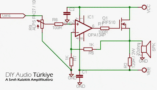

hi nitrate
hi nitrate..i didnt read all of the posts but i can tell something ..i build output capacitorless class a headphone amplifier a week ago..i used opamps that have very very low thd..i used lm4562.it has nearly no thd.i listened to it..the sound is very clear and detailed but i thought that there is something wrong..i replaced opa2134 which has more thd than lm4562..but the sound is better now!and now i think that detailed and pure sound is not always good for my ears..and low slew rate amp maybe can sound better?
here is the schematic of my amp
As requested here is the offending circuit.
The Amps origins are to be found here:-
http://www.diyaudio.com/forums/showthread.php?postid=1407918#post1407918
It seems that the more NFB is applied the greater the drop in THD but at the same time the amplifier seems to sound less transparent. I mean the amp does not sound 'bad' but it isnt up to my expectations either!!
Leigh

AAMOI why did you opt for a quasi complementary output?. Possibly getting bipolar gain droop, the VAS stge is set to 13mA and the TIP41 has a gain of as low 30 and the MJL21193 25 so it could possibly supply 10 amps max also the ft the TIP41 is only 4MHz which wont help. I have played, about thirteen years ago!, with a Self type topology except it used FETS and had Hawksfords error correction circuitry, the results were very very good. If think the design is in here somewhere, if not I can dig it out. Any questions on error correction should be referred to Mr Cordell .

Leigh, realy the circuit it is an uncommon implementation. Because in electronics everything it is under revision forever, i can't express my opinion. Before 5 years i heared a Hi-End class amplifier of Italian origin with quasi compl. output with wonderful reproduction.
Thus the only remark that i have it is the strange mix of misfit between them transistors. Why you use these hi Vce transistors although the voltage supply level of your project it is so low? Everyone, yet the most newcomer, he knows that the higher the Vce the lower the beta (bandwidth) of a transistor. In so low supply you can use transistors with a beta of some hundreds which accordingly helps in the improvement of the transient response. That is exactly what you don't like in hearing.
Also the circuit it does not say nothing by alone and by the simulation. Can you please tell us how much it is the Rise Time by applying a square wave of 10KHz from a real generator in input and measured in output with a real and not a virtual oscilloscope?
