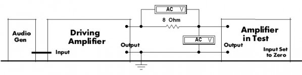

Determination of Damping Factor...........The Easy Way
How should I measure the Damping Factor? What equipment do I need for this?
All we need is a reliable AC VM & a load resistor. And another power amp.
Referring to the attachment, one amplifier is used to drive the output of the amplifier in test. The amplifier in test is not driven, the gain control set to zero.
The driving amp can be any amp of reasonable spec, very little power is required.
Cranking up the signal generator, if 8V appears across the 8R resistor there is One Amp passing thru the secondary of the OPT of the amp in test. Then measure the volts developed across the amp in test secondary terminals. As an example, if that measures one volt the resistance at the amp in test terminals is One Ohm.
If the measurements were made on the 8R tap the Damping Factor is 8/1 or simply 8.
If a second amp is not available on the shelf, call your buddy! And don’t be surprised at the results, might not be as good as you had supposed. SET amps without NFB manage DF of 3 if not biased off too far. SEUL amps without NFB might make DF of one. NFB will push the DF up.
I just measure the output voltage for a given R load, then replace R with R1 (say 10% apart), measure the output voltage again, and calculate the internal source impedance of the amplifier output. From this you get DF.
Another way measures the output volts with & without a load. The answer is good enough for a first order estimate. And also shews if the amp is stable.........or not!😱

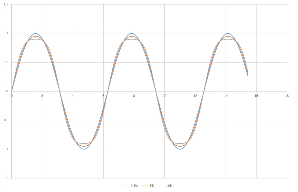

6vheater, why do you respond so rudely? It's not utter nonsense, push-pull distortion is predominantly third harmonic which flattens the top and bottom of the sinewave (see picture), you just can't see it on a scope unless distortion is high. How it looks with a music signal is another matter....
That is a completely worn out subject.
Maybe your push pull amp produces lots of odd harmonic distortion, as do very many commercial amps.
Properly designed ones don't, so this sort of generalisation is nonsense, as is the idea that a complex music signal changes anything at all.
If you look carefully the THD of a "typical" PP valve amp increases in a fairly linear fashion, then shoots up as it approaches what looks like fairly soft clipping.
Amps using ultralinear screen grid connections do compress, but it's what appears to be a taboo subject, because the resultant sound -half way house between triode and pentode, so many people seem to like "warts and all".
It was the basis of a whole generation of "smooth sounding" amps especially from the USA & Mullard.
To my mind we don't want to be adding more compression artefacts to most musical signals which already compressed to death.
Solid state amps don't produce the same characteristics,- usually have giant amounts of NFB and are not allowed to come close to clip, at which point they have that brutality of noise, for which they have become well known.
It's as a valve amp approaches clipping that it compresses the signal,- which is why they are routinely used in studios - In push pull would you believe (!) as a balanced pair to add some soft distortion close to clip to make digital sound less harsh.
I wouldn't dream of running any hifi amp constantly even close to clip.
What you get is a pool of mud!

I know my opinion:
A increase in 3rd Harmonic will show itself on a scope as a flattening to the sine wave peak.
Irrespective of the typology of the amplifier
Increasing ever further the sine wave peak is inverted, where there was a peak, is now a dip and the amplitude maxima form 2 peaks centred about the fundamental peak.
Anyone who spent any time on a scope, would understand perfectly what was meant by compression....
Sorry it's rubbish.
When you approach clip, the peaks of the sine wave FLATTEN.
(it's normal, the valve curve goes over kink into non conduction, unless of course you run in AB2, where another secondary virtual anode forms from the control grid.).
If you push a valve amp further into clip the peak of the sine wave doesn't INVERT it simply turns into a square wave. You wanna see the traces I have of exactly that?

The stage has dominant 3rd harmonic distortion, and a lower level of 2nd harmonic distortion.
With a pure sine wave input, the apparent shape of the output wave is a ‘fat' shortened alternation, followed by another ‘fat' shortened alternation.
Many push pull amplifiers exhibit this characteristic (especially if there is no cancellation from earlier stage(s), and even if there is no output transformer saturation).
Before we approach clipping, this becomes visually apparent on an oscilloscope.
If we have a spectrum analyzer, it is easy to verify the fact of the harmonic amplitudes.
If we go to hard clipping with either the single ended stage, or with the push pull stage, we begin to approach a square wave.
