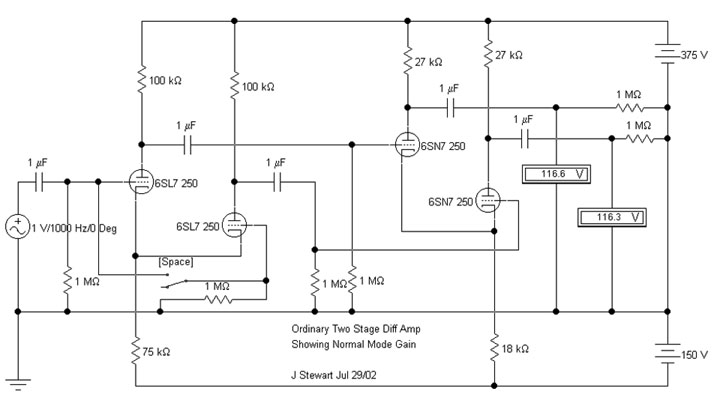

Cutting away from the various discussions of what is & what isn't, here is a series of six simulations covering the normal mode & common mode gain of a 2-stage toob amplifier.
There is no test after this.

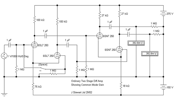

The first of these examples uses simple resisters to a -ve rail of 150V. It shews a normal mode gain of ~116 to each of the outputs. The common mode gain is 0.382.

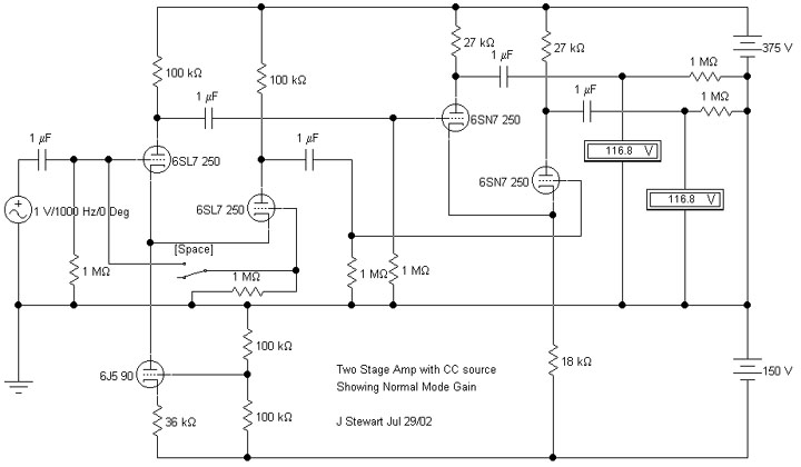

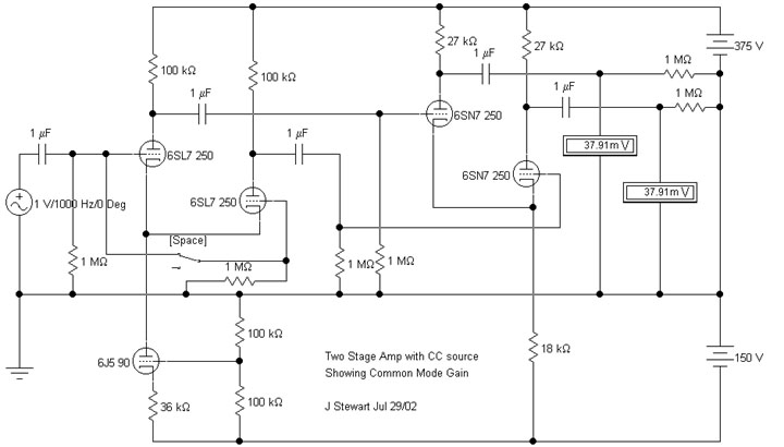

The 2nd example replaces the resister tail of the first stage with a triode whose tail is yet another resister. In this case the tail for the first stage looks like (20 + 1)*36K or 756K. That is about 10X the simple resister tail. The common mode gain drops to ~0.038. And the normal mode gain still ~116.

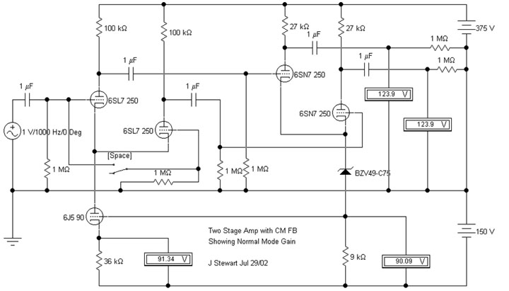

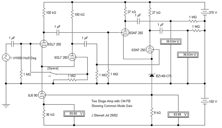

The 3rd circuit uses an active FB connexion from the cathode of the 2nd stage. To avoid using a resister network to shift the DC level a zener is shewn. But just as easily that could be replaced by a 75V gas regulator. The result is a common mode gain of ~0.036, while the normal mode gain has increased to ~124. Not much improvement that time.
For those still awake, you can calc the common Mode Rejection Ratio(CMR) from
20 log (Normal Mode Gain / Common Mode Gain)

The examples given are simulations. The models given in Electronic WorkBench (EWB) software are only first order. So any D% numbers don't mean much, need to build a real cct & do the tests. Very much depends on matching of the triodes so better results with dual triodes should be the case.
I've used the two tube diff amps with simple resistor tails to -150V as drivers in several projects with very good results. It is easy to build in AC balance into the cct, then adjust that for least 2nd harmonic of the entire amp.😎
The usual cct uses 6SL7 as first stage, 6SN7 as 2nd stage. All these were bootstrapped drivers into output stages like the ElectroVoice/Circlotron, Norman Crowhurst's Twin Coupled/McIntosh clone & a PPP 6080 output stage (25W).
I built a pair of adapters to try 6BQ7/6BK7 family in these drivers. The results measuring both THD & IMD were a lot better than most people would expect.😱
