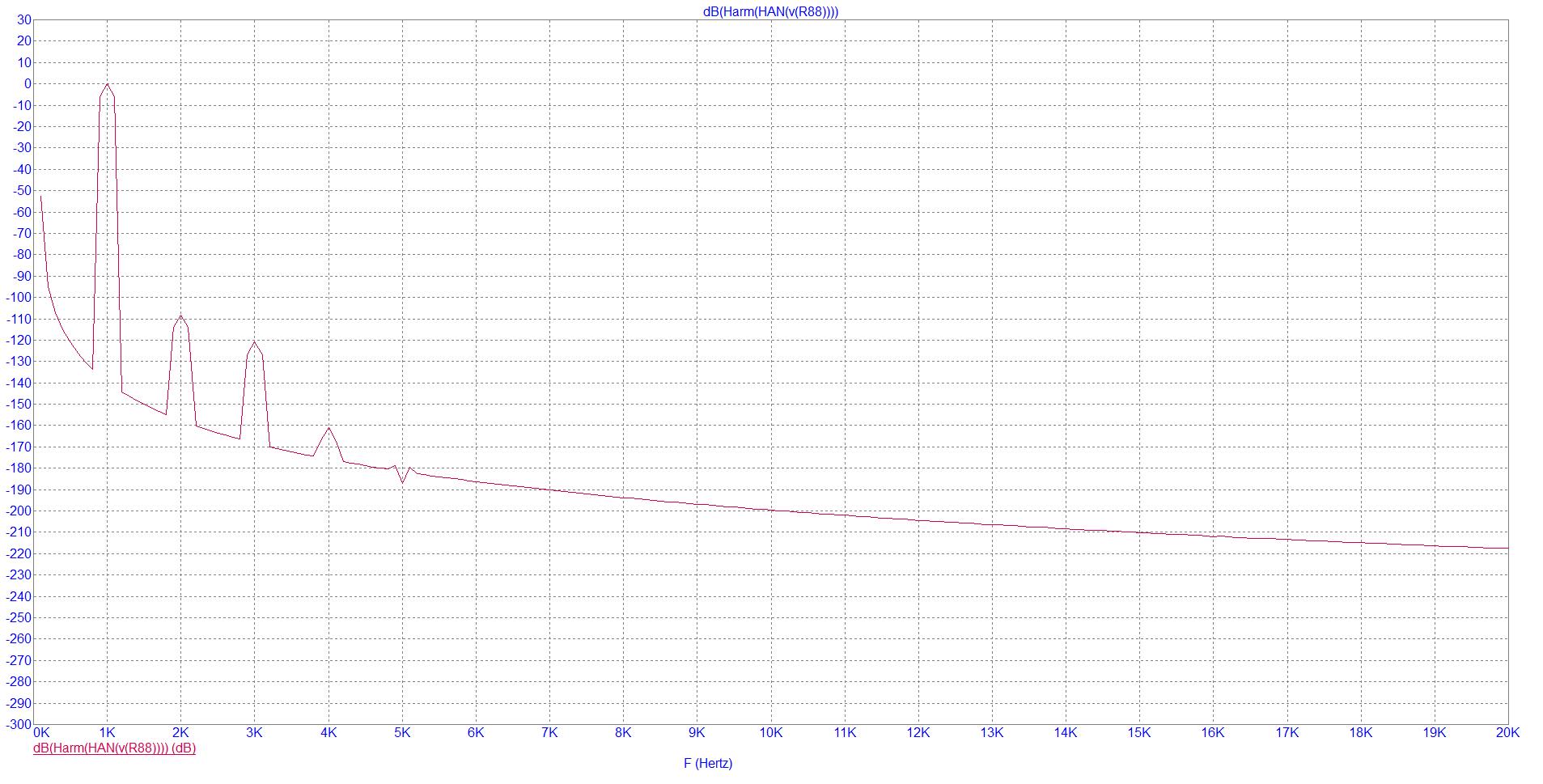

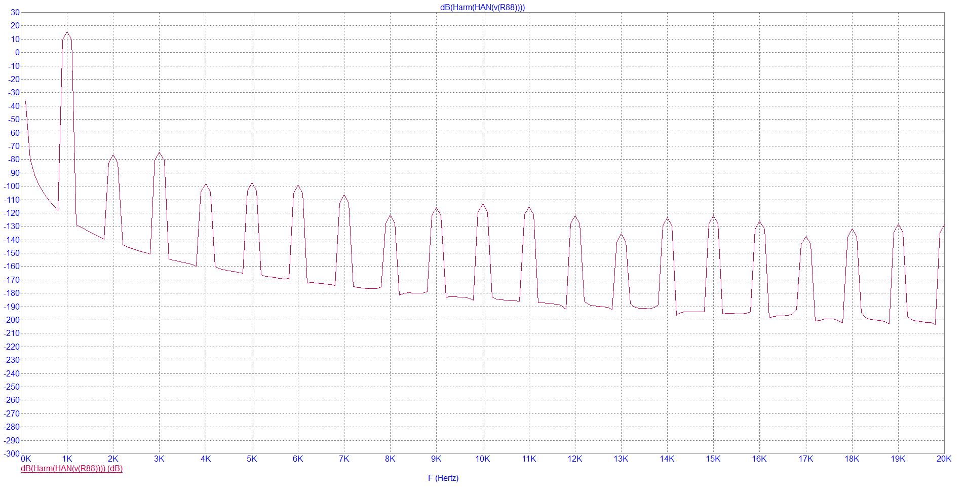

THD 0.00045% and 15 Watt

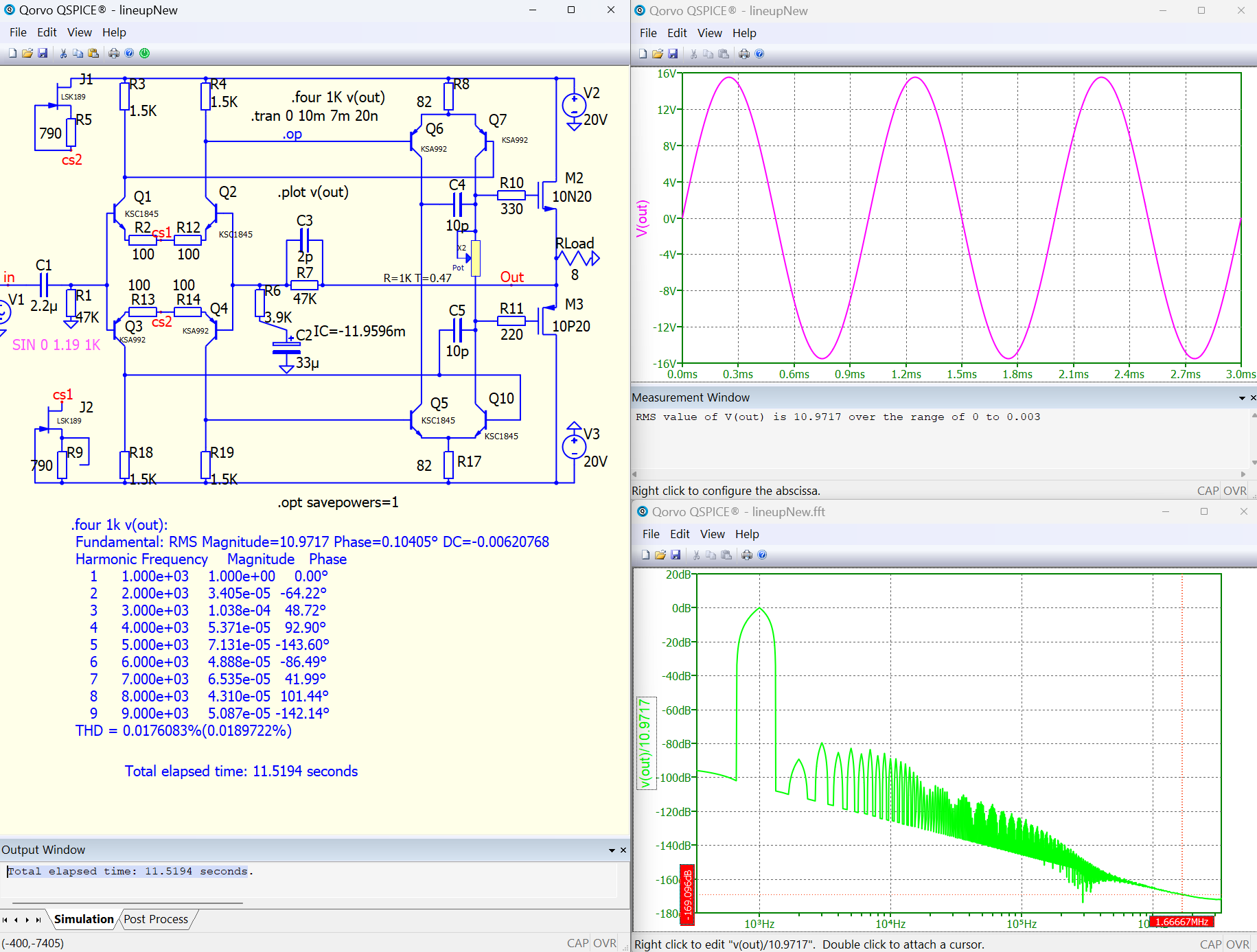

I built this last year for my SX3700.
2 changes are 47k resistors instead of constant current and IRF240 and IRF9140 biased at 6v. I also added 1n4148 on vas to fix clipping . Sounds great good to know distortion is this low. I am using 9.1k// 1k feedback ratio gain of 10.1 .

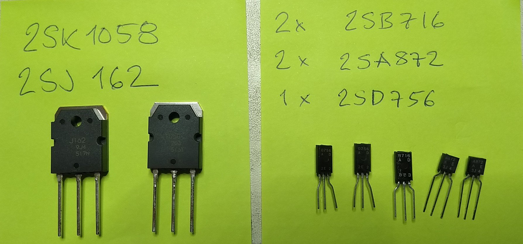

Seems I just have some parts for 'Hitachi', but some of these can be fake ones.

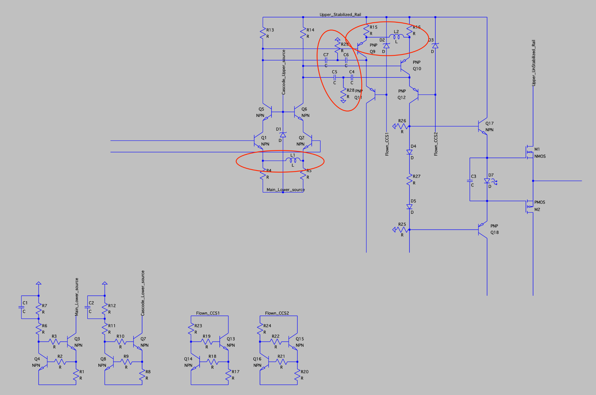

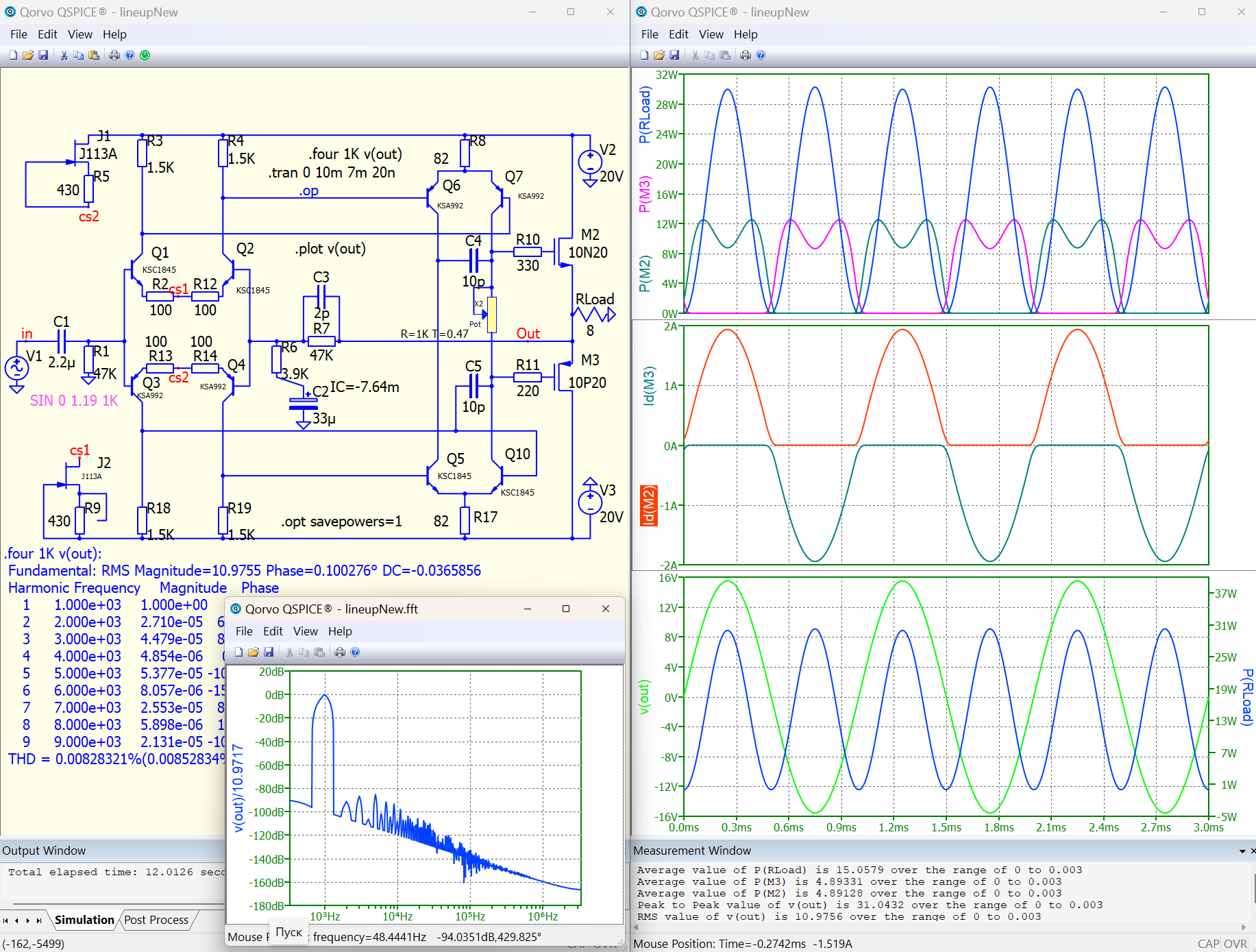

So I used improved models: bipolar transistors taking into account the quasi-saturation region, field-effect transistors taking into account the subthreshold current (current in the threshold area). I had to increase the source resistors. Apparently, I have other parameters of the LSK189 transistors. I have achieved approximately the same output cascade currents as you have, as well as the currents of the last differential cascades.

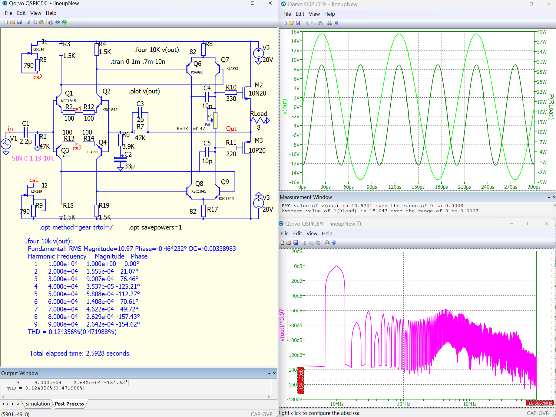

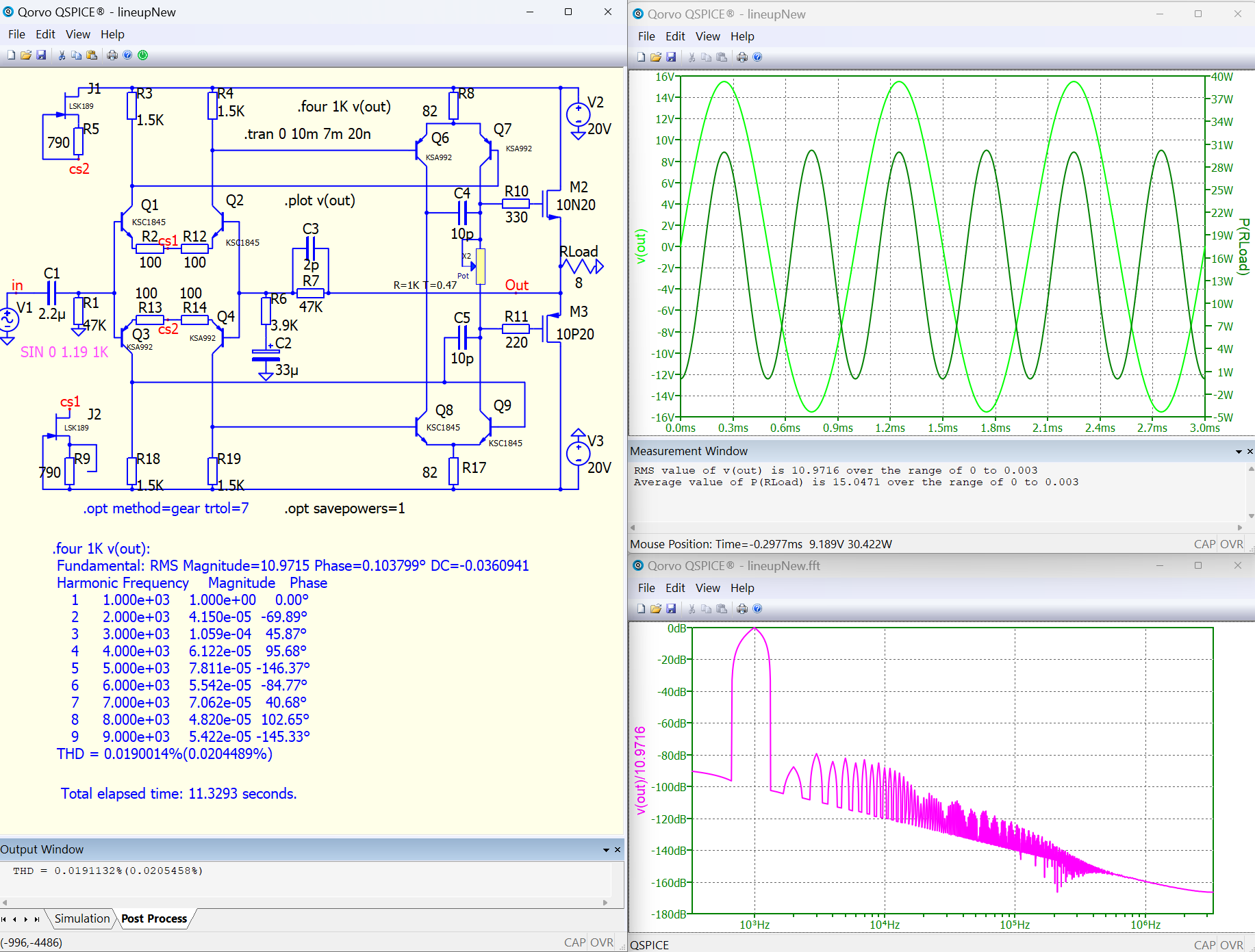

Unrelated question: I see you’re using QSpice. Is it starting to be ready for prime time? I tried it a few months ago and it looked promising, but a little too buggy.
I believe that Qspice is already quite suitable for audio circuitry. Its results are quite reliable. The main thing is to use the right models.But Multisim may miss (not detect) the instability of the amplifier. In addition, Qspice has the ability to model JFET transistors more accurately. In addition to improved modeling in the cut-off area, it allows for more accurate modeling of the initial phase of the volt-ampere characteristics (similar to more advanced models of bipolar transistors, taking into account quasi-saturation).
