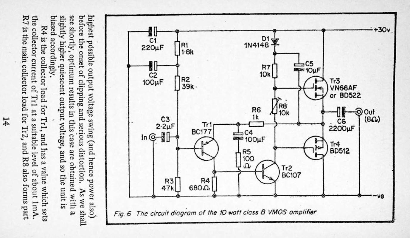

This is proven Hitachi diagram, used and cloned to humongous proportions, always delivers with so little parts
Very Much so. It is a Classic
Such a great topology.
At low voltages, transistor choices become even more fun.
Using higher gain readily available transistors. I have tried B grade everyday BC556B/546B
And at " 1 watt" as posted, distortion is close to the OP post around .0003%
full power holds up to .002%
If everything is tuned to work at lower voltages. This just using standard BJT power transistors.
So normal VBE for bias is employed.
Agree, fun one to play with, with such low part count verses performance
What more can you wish from symmetry?
Agree.
As noted the low parts count verses performance often leaves you not needing much more.

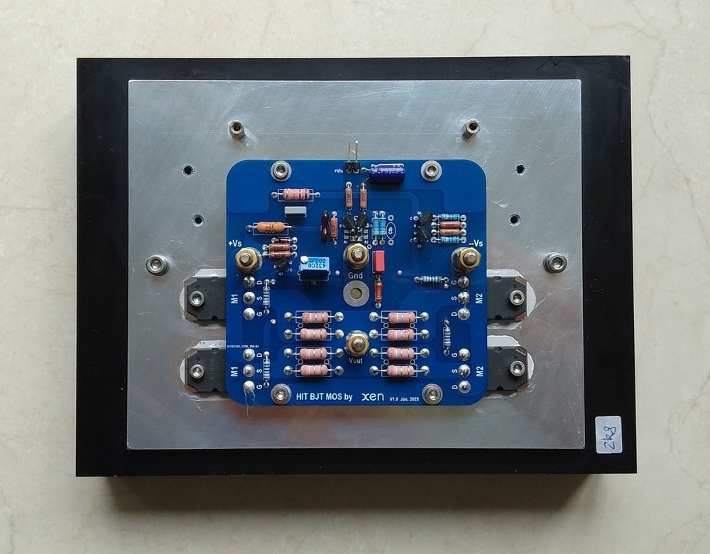

I am working as I said.
But it is not promising. No longer THD 0.00016%. Almost twice that.
And no longer 16 Watt. More like 15 Watt.
I am not happy. Maybe end this project ... 🙁
I could post my revised schematic. Is there anybody who wants this?

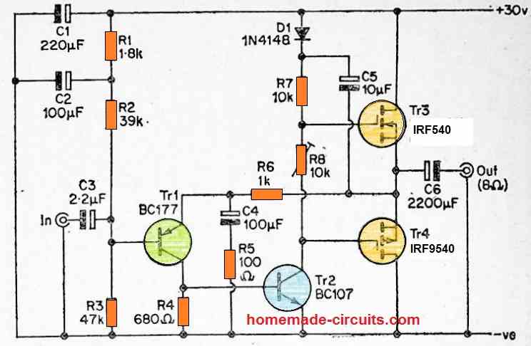

Since the wiper and the unused end of the pot are tied together, I would assume that if the pot is an appropriate value, it would merely lead to increased dissipation and not an outright failure.
Correct, but still you can run very long time at hot bias unnoticed, need to calculate ful pot R scenario.... Good quality pot will probably never fail... It is just small area to improve this design, no drama, but still

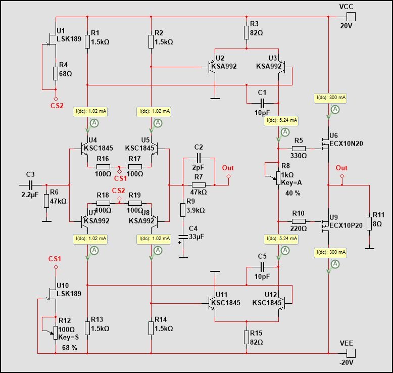

Take one simple but very fast CFB power amp with mosfets, I took first picture from internet, don't know if this one works or not, seems it does if you change mosfets to laterals instead IRF's, of course you can change BC transistors to something better. point is a simple and super fast, forget THD and DC offset:
Than add one classic opamp at input and run global feedback overall with gain bit higher than poweramp itself... see what happens, I think it will satisfy THD needs at many frequencies
If you spice it, I will build it eventually 🙂
