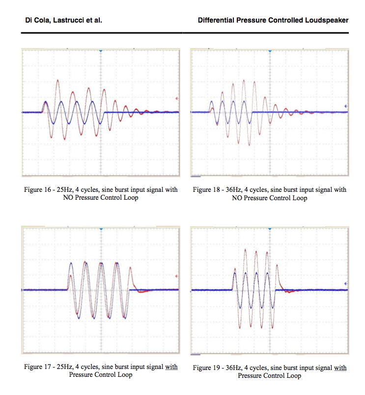

"The feedback control of this system is based on a differential pressure control sensor. The entire system control is performed by a “Zero Latency DSP” application, specifically designed for this purpose in order to be able to process the system with real time performances.
The Differential Pressure Measurement, senses the difference of pressure between the front and the rear side of the radiating diaphragm due to the acoustic load, and uses this information to alter the behavior of the reference model, therefore according to the real boundary conditions."

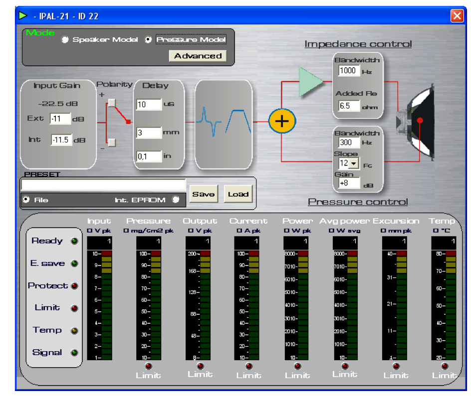

The IPAL is mono.
It would help to identify the full model number to avoid confusion, Powersoft makes loads of different amps.

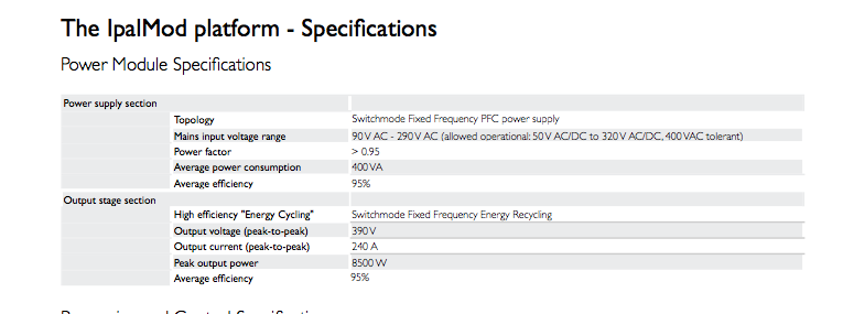

Although the IPAL output voltage is capable of 390 volts it is current limited to 8000 watts. All the Powersoft amps use current limiting.
The current limiting is why the IPAL can work with speakers with RE of only .74 ohms.
The BMS IPAL woofers look like the 18SW and 21SW, but the specs are quite different.
If one had the money to buy the IPAL, a bit more linear output could be squeezed from any speaker.

The IPAL module is capable of 390v peak and 240A short term if my memory is working. I might be a bit off on those so don't quote me exactly but regardless it has substantial reserves. The peak ratings appear to be in line with a bridged k10 but I suspect that the long term power output and protection circuits are governed a little more tightly due to the huge current demands of 1 ohm minimum loads.

the powersoft ipal module is 390volts but does is at verry low impedance eg <1ohm

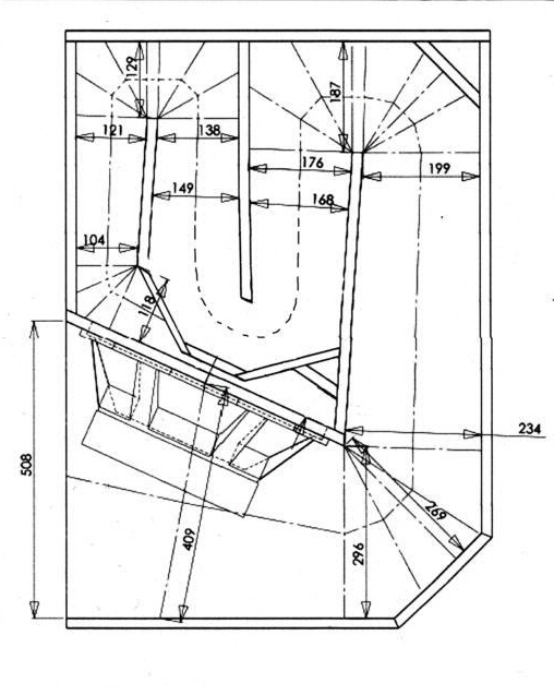

Hi Guys,

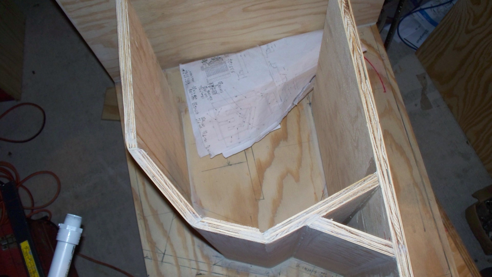

I took apart the first cabinet I built ,basically cause I messed up the some measurements,They were off enough to matter, so here is what I have replaced the incorrect building,1st Pic
The glue and PL is drying so the box is still open and braces will be added .Both are using a B&C 18PZB100,
The second box I built is the second picture and it starts putting out good bass at 18 hz with a sweep generator to a Inuke 3000 at quarter volume,It keeps getting louder up to about 250hz ,I plan to cross at 130 Hz, This box shakes the Sh T out of everything,walls Belly,Pants,keys,stomach,lol.Wife's dishes,lol.
I don't remember where the drawing came from,I used bigpicture to get the measurements to build it.
