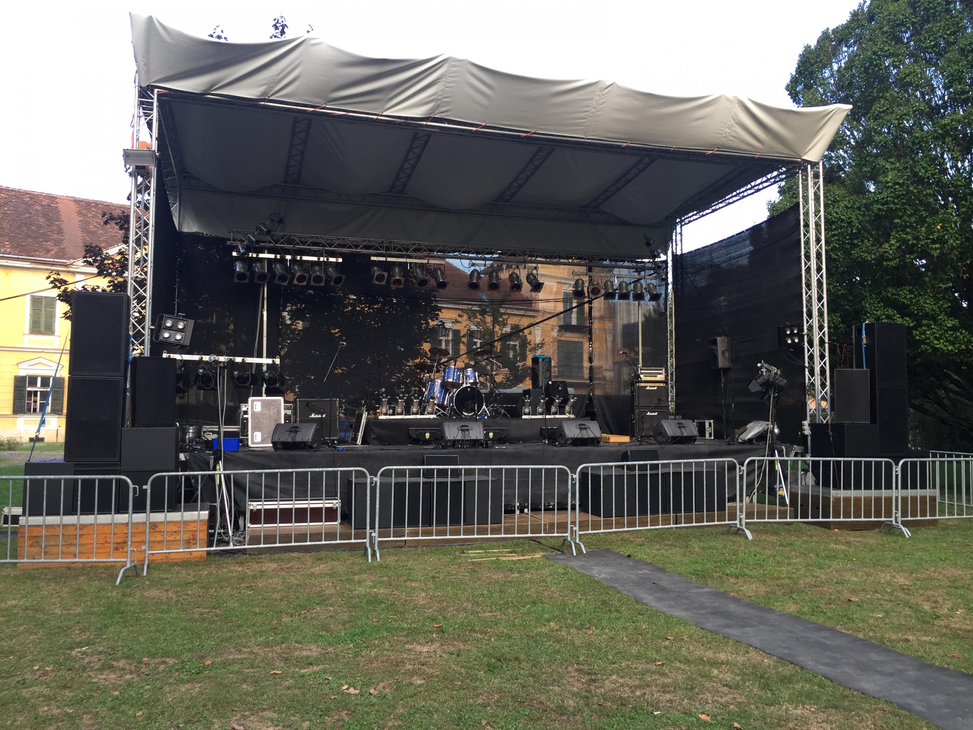

Hi all
i was using 8 pcs of TH18 friday night the first time on this nice open-air "rock in the park"-event. we used 4 passive ones paralleld to 4 self-powered ones. also we had 2 double 18 bassreflex cabs supporting the upper bass range. it was cool, two bands and a djane were playing heavy alternativ rock to about 800 listeners.
because it was a low budget gig we had not enough hands on stage and at the end not enough time to check out the optimum bass array. although the pa worked well because of the oversizing and headroom but im shure next time we can make it better. Playback music was really fine, but we generally had troubles with the dassdrum mics.
it was was very interesting to watch the directivity of the system. behind the stage bass was like shut off. i guess the problems with micing the bassdrum has something to do with this. does somebody of you know something about this issue?

Weird, usually there is a power alley when you space subs. Maybe the br cabs had phase issues with the horns but I have noticed big nuls with kick mics and subs before.

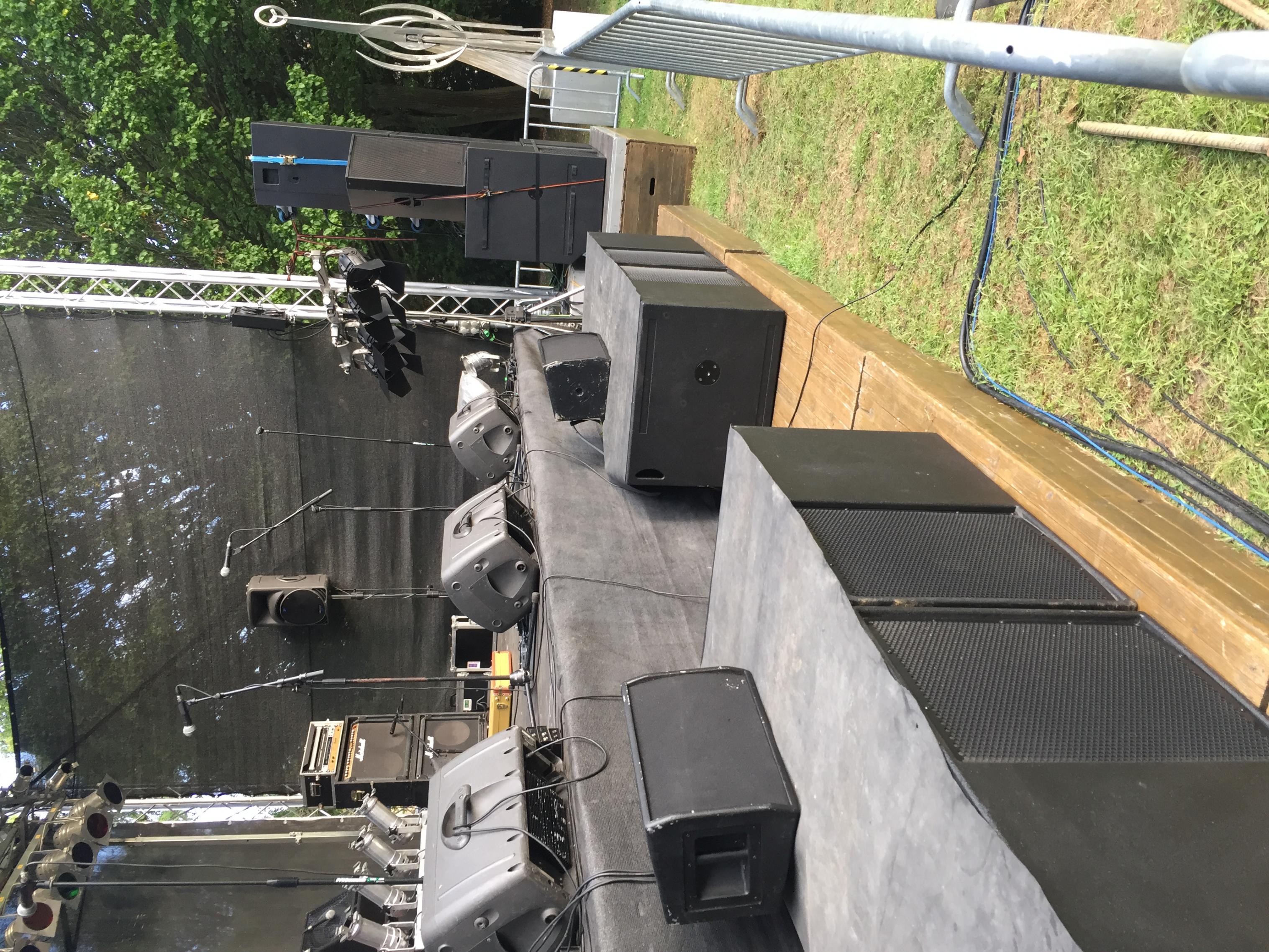

Hey mr. doom
interesting! the br-subs we previously aligned correctly in a separate measuring session. as i said dj stuff was fine. the br cabs were rather speaker stands than subs.
setting up a bass array with only 8 cabs that way simply by estimation is a bit naive😀. nevertheless i was a nice job. people were happy. i have to learn more about different setups....
Hi Xoc1
yes we delayed the mainstacks 2ms for a wider splay. this was noticable better and did not cause any cancellations or negative effects when playing playback music. every bass stack had its own controller. we had also a main controller (BSS Minidrive from my companion) in the signalpath. i think it had been better to have 8 single points then 4 Pointe for a higher cut-off frequency...
Next time try reversing the phase on the kick mic. Then try the other mics. I'd say there was a good chance kick and floor tom or other tom mics were cancelling each other a bit. Miking live drums is no easy task. All sorts of fun! Also, high pass the drum mics except MAYBE floor toms.
Hi Zwiller
phase reverse had no remarkable effekt, we started with AKG and endet with Audix - allways the same strange behavior. i have to mention the kickdrum was weak and not well tuned because of the high daytime temperatures but the kick was generally better at other locations were we used the system in L/R setup (2 Subs per side)
With the subs placed as in the photo, I'd expect there would be a ton of bass where the drum riser is located, even if it was quiet backstage.Playback music was really fine, but we generally had troubles with the dassdrum mics.
You need to use frequency dependent noise gates on the kick drum and low toms to get any real "thump". Otherwise the LF enveloping the kit resonates the drum/head Helmholtz frequency, the PA amplifies the acoustic resonance, and it "runs away". It sounds like "regular" LF feedback, but EQ alone won't cure it.
The noise gate "opens" with the loudest sound (beater or stick) then closes, the gate frequency and envelope being user defined. Noise gates that are not frequency dependent are often not very useful, as drummers often tend to whack the snare louder than any other drum, which can cause multiple mics to open. With a properly gated kit, only one mic is open at a time, unless the drummer hits more than one thing at a time.
As far as Zwiller's suggestion of reversing the "phase" (it is polarity, not phase...) on the kick drum, that usually has little effect other than in the drum monitor at the drummer's position. The TH has a full wavelength of delay at the upper end of it's passband, switching polarity of the mic is six of one, a half dozen of another.
If you have no noise gates, switching polarity of half the drum mics will reduce shared "noise", but the reflective/resonant/ highly equalized environment of a reinforced kit makes it difficult to suss out without an extensive time period.
If the system itself has not been properly "dialed in" first, drum reinforcement can be a real exercise in "tail chasing" ;^).
