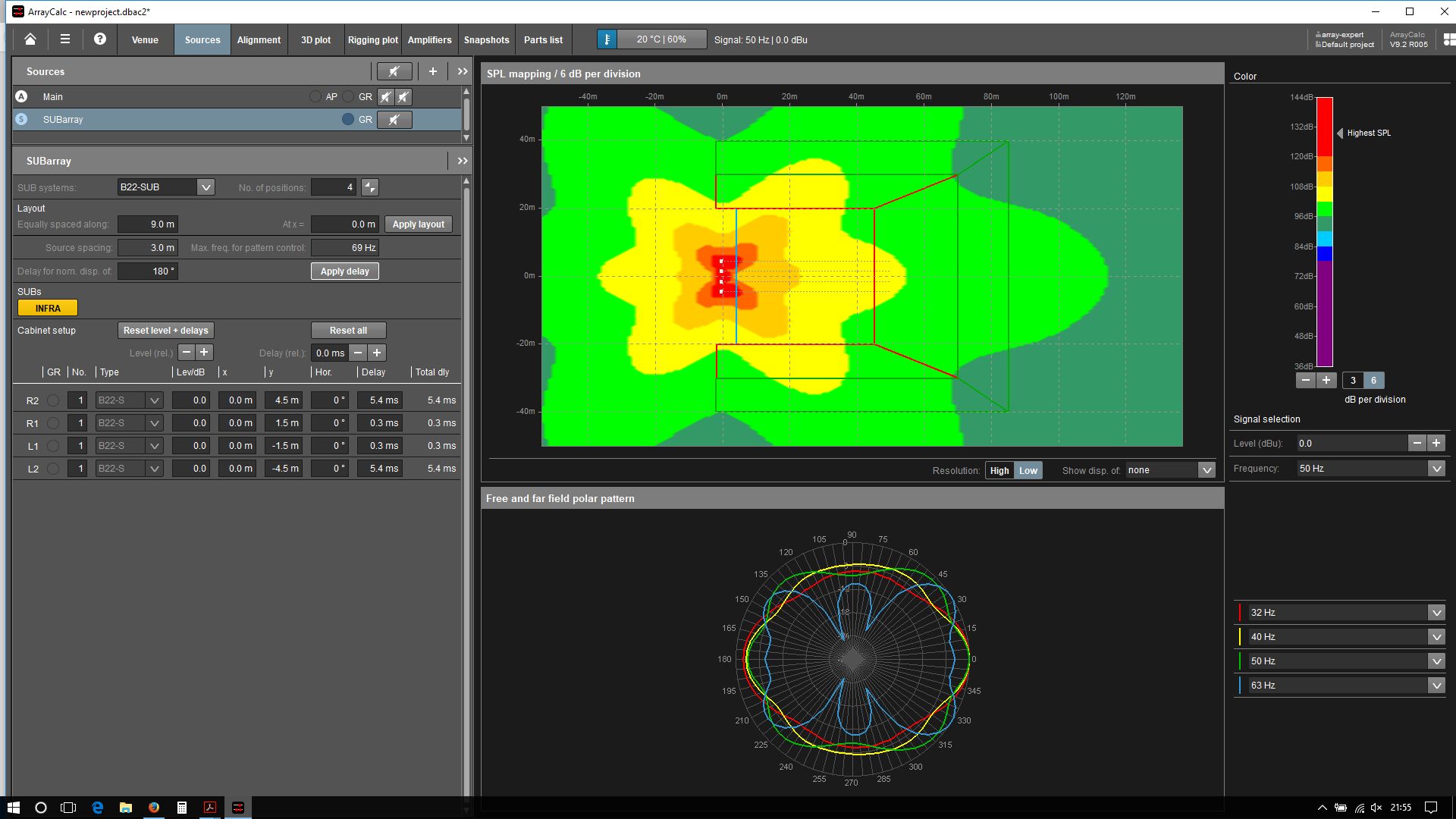

I would expect the tapped horn subs to be fairly ommidirectional.
Far more important would be the spacing and delays used.
I was looking for some software to help calculate optimal delays and found arraycalc on the D&B Audiotechnik site.
Simulation - Software | d&b audiotechnik
It says that its only meant for use with D&B speakers but if you choose an ommidirectional sub from the range and enter the number of speaker pairs & spacing you used the results look like they could be useful!

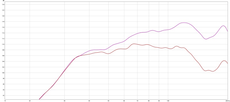

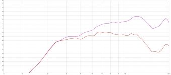

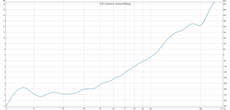

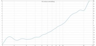

I measured my 2 FLH's (58cm wide, 75cm deep, 116cm high each) both in front and back side. 3M from the mouths. As the lines didn't line up <20Hz, and i highly doubt there is any directivity down there, I added 2,9dB to the 180deg line.
Both in 1/12th octave smoothing, difference between the plots with 1/6th octave smoothing
I don't believe 3M is a good distance to do these kind of measurements, so I will repeat them soon at 10M or maybe more...
As you can see there is a small amount of directivity. So yes, this is cardioide, as any reduction in rear output would qualify as cardioide. But every sub does this to some degree, related to size.
