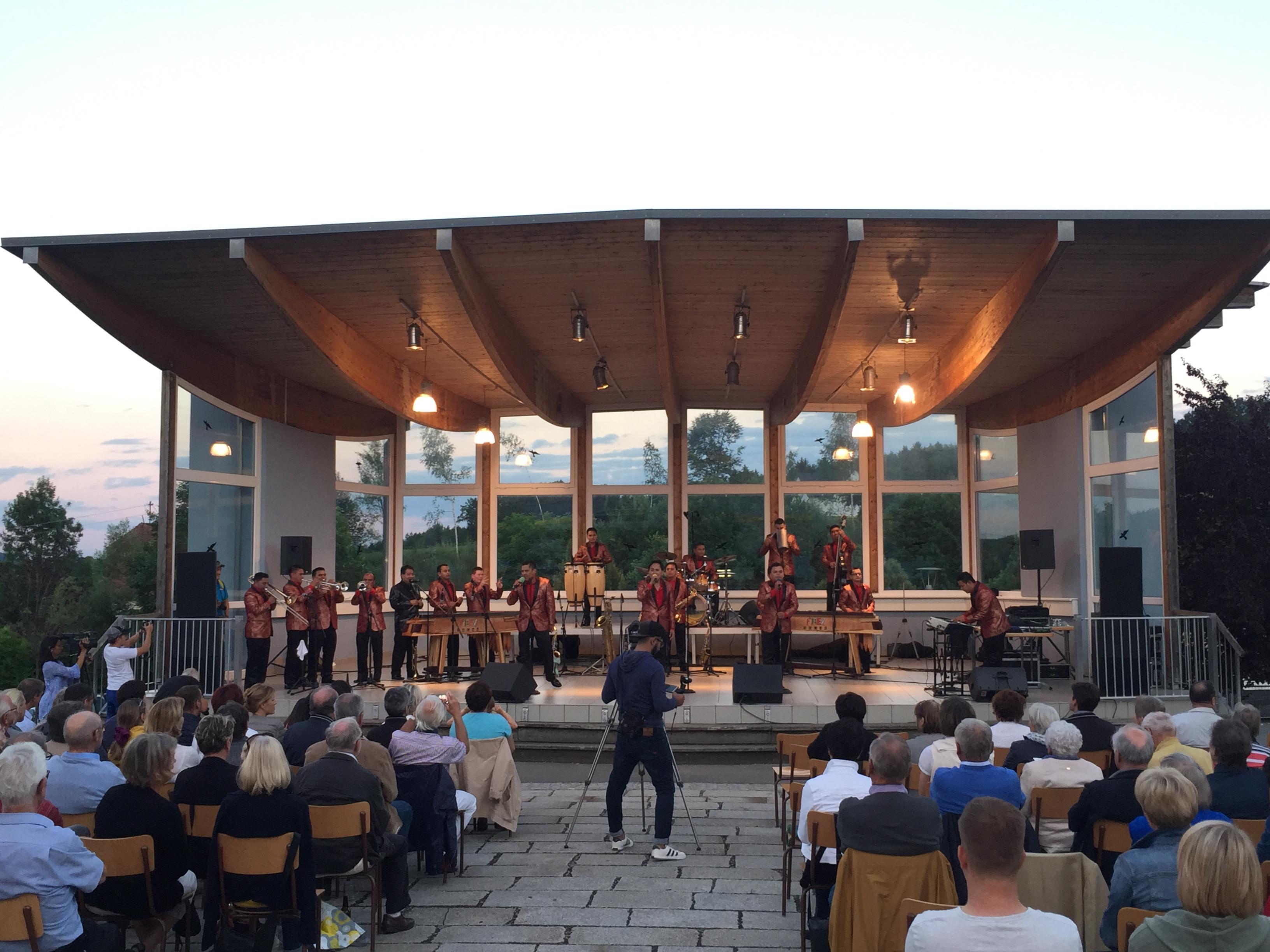

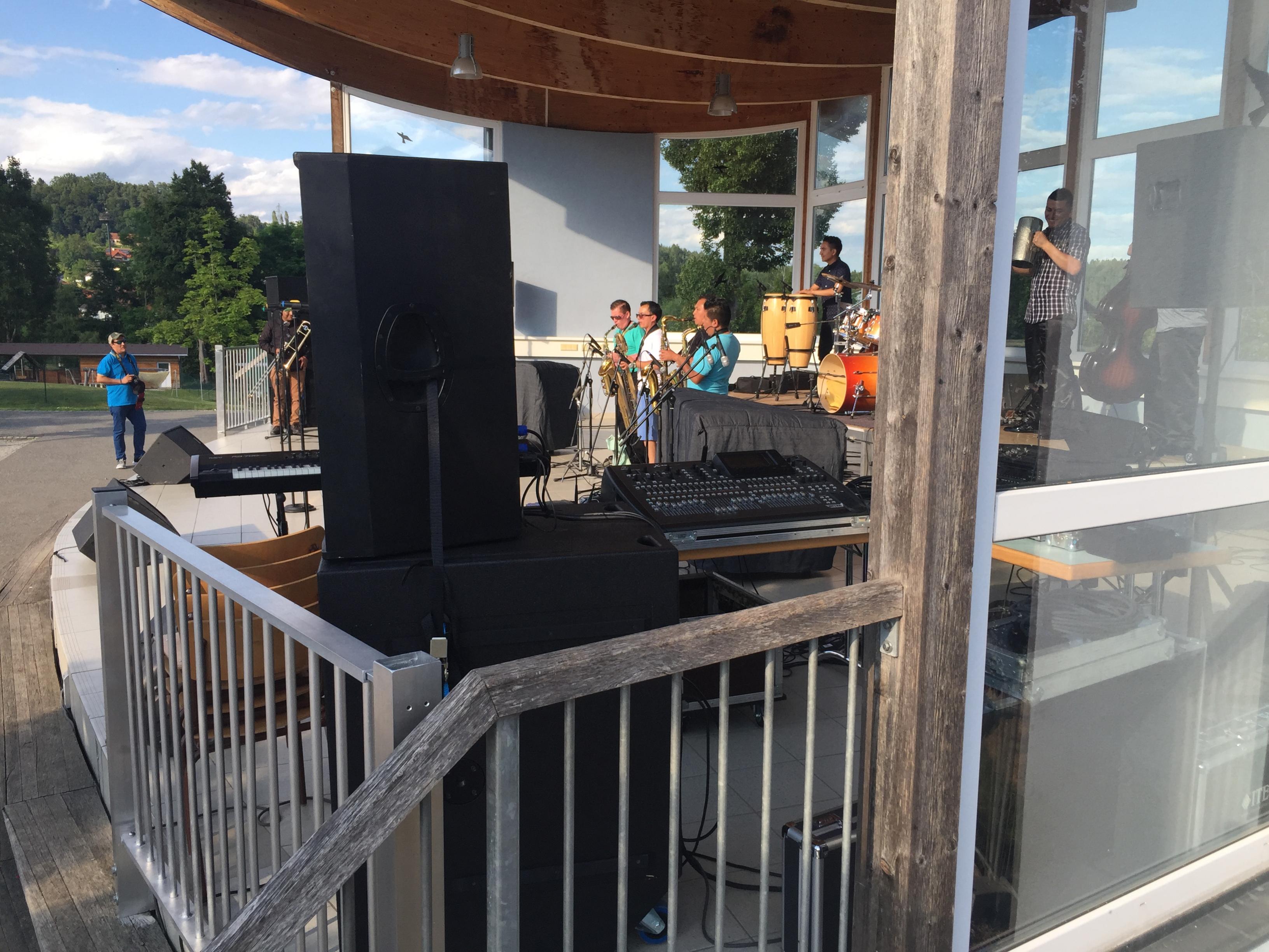

i'm very happy with this system. i got a real good feedback: on weekend we had this dance event. one organizer who was present told us, that he wants to rent the system for smaller a 4-day-festival in august. he compared the sound with Function One and didn't believe that it's self-made. he wanted to use a Nexo Line Array from a local rental company for the festival but he said he would kick it out (we will see if he will take it - from now on my system has got a appropriate price too🙂. many others wanted to know who's the manufacturer because there is no logo on the system. cool thing.....
mit freundliche Grüßen
Bertl
sorry for the long text. doing now a job with a latin bigband. cool. got the job yesterday. 1 Top + 1TH 18 per side. sounds cool...

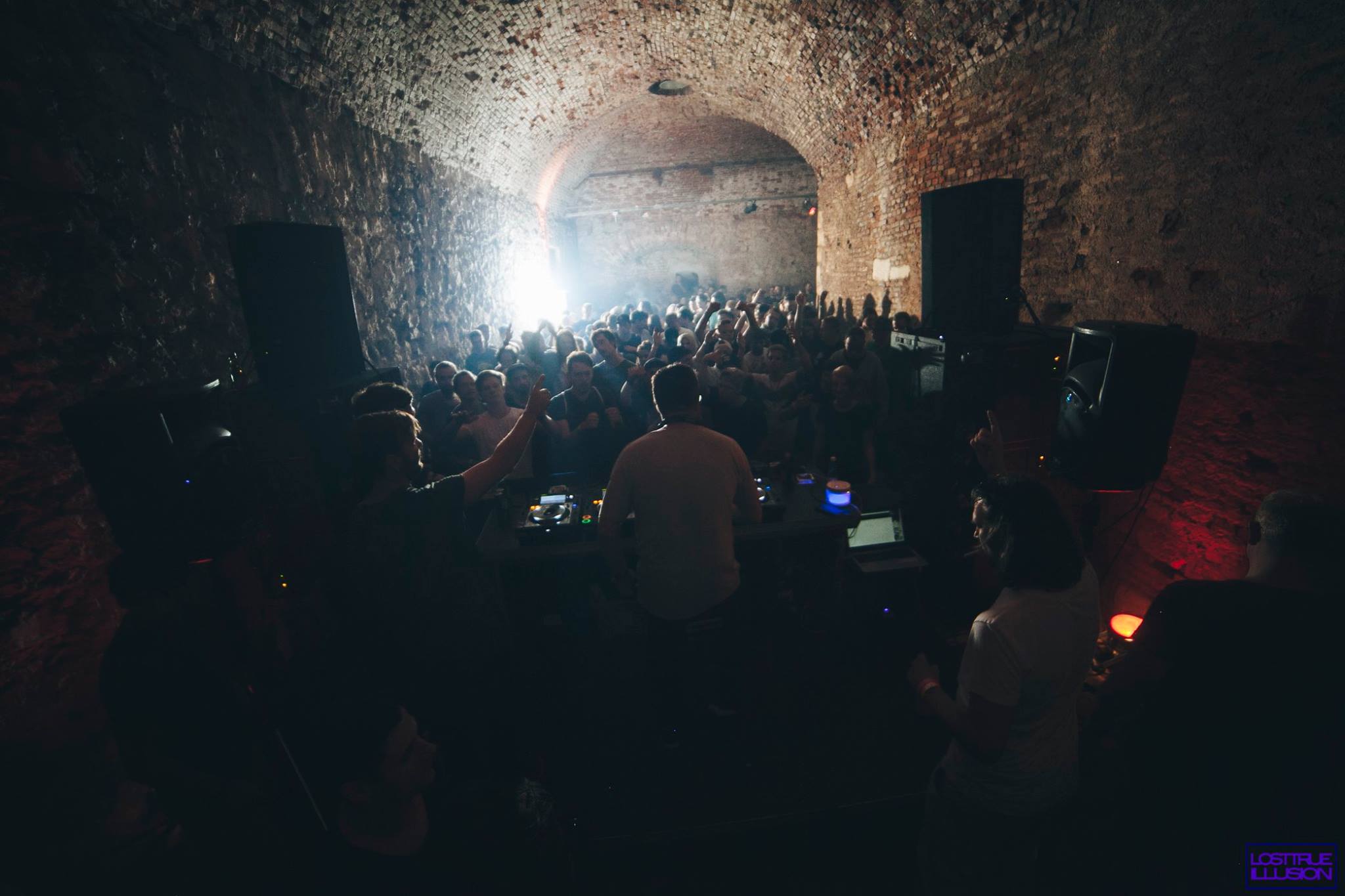

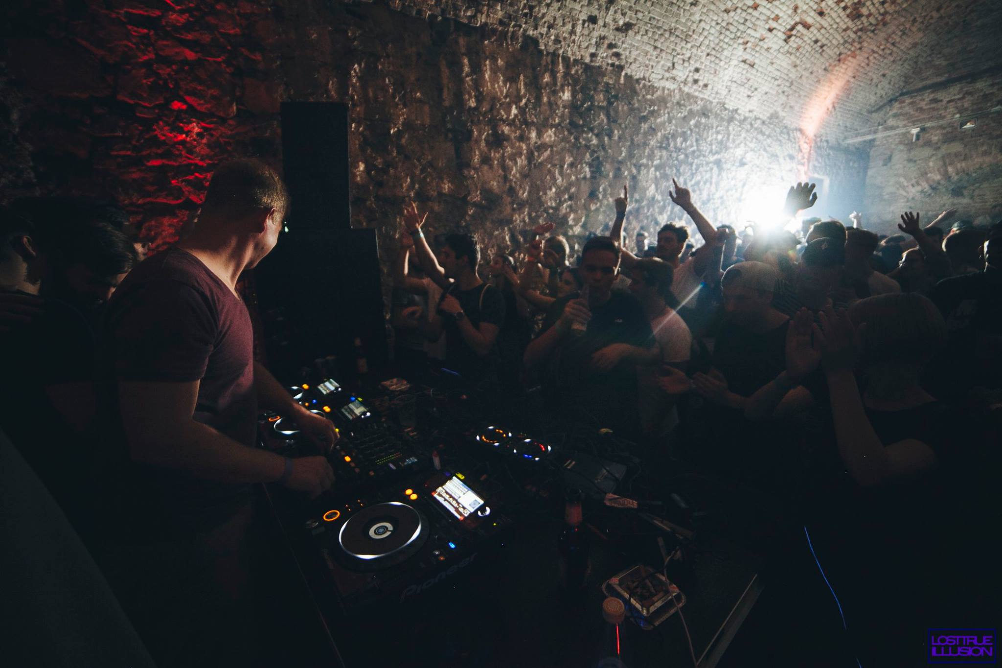

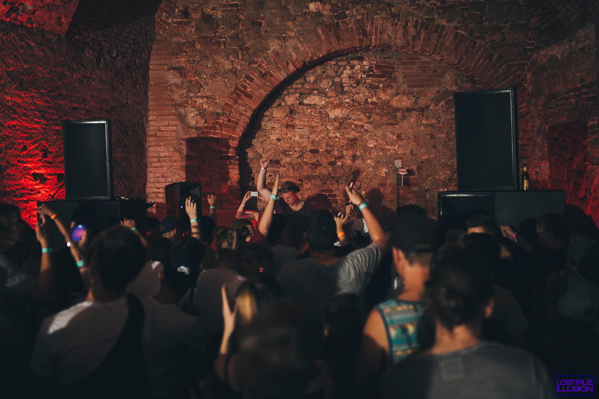

more pics and information about the dj set:
https://m.facebook.com/tanzfreuden/...28226648743/666126806912216/?type=3&source=49
the location is in the city of Graz (Capital of Styria, federal state of Austria). its an annual event called "der Berg groovt" (Berg=mountain) organized by

BMS: the latin Bigband on tuesday was on tour with their own FOH-tech. he was great, a real professional. he checked out the settings in 30 minutes and made a real fat and clear sound (there were 19 musician on the stage). after the gig we talked a bit. he told me that the band is playing 200 times a year and the are a big number in guatemala. he made to remarks about the PA-system: "good response" and "no distortion" - he said NO(!) distortion😉
