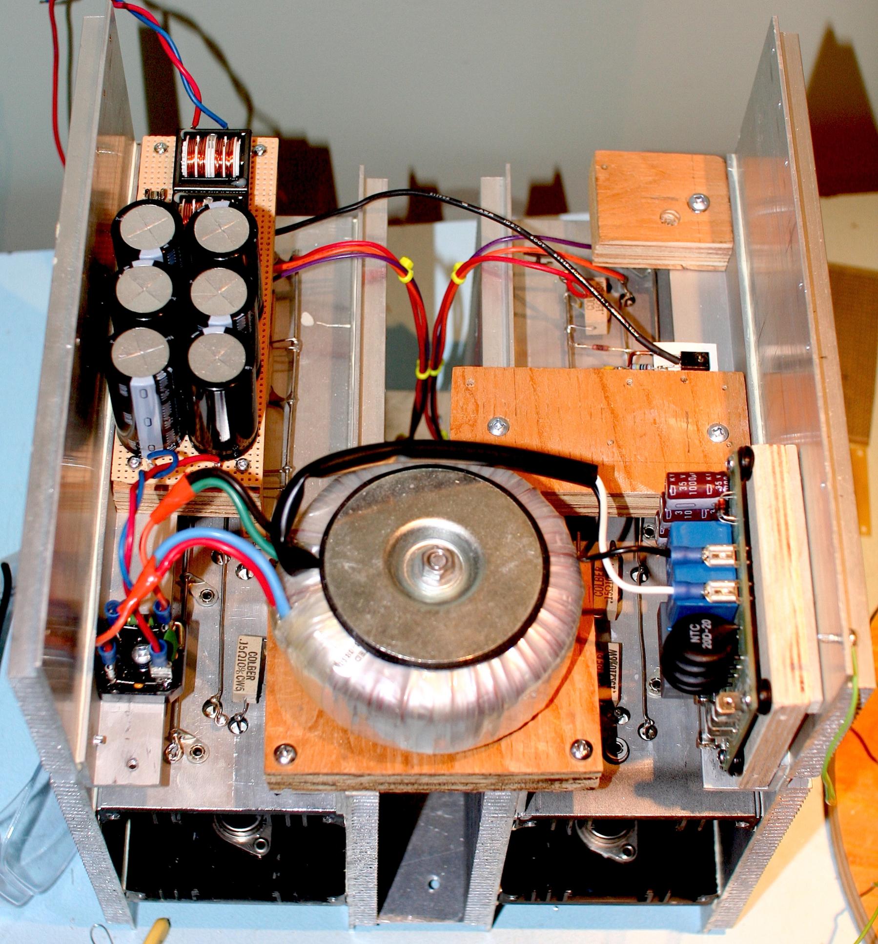

I've made a bit more progress. I've installed the soft-start board and the power supply filter board (photo shows the amplifier chassis lying face down, the back open for installation of the parts). It ain't pretty but I'm having a blast building it with any bits I can find lying around !

We should be good, all the large caps are rated for 50V, twice the power rail voltage. I've read that higher voltage caps are better quality than lower voltage caps so perhaps there is some slight advantage.
................We should be good, all the large caps are rated for 50V, twice the power rail voltage. I've read that higher voltage caps are better quality than lower voltage caps so perhaps there is some slight advantage.
This does not seem right.
If your 50V capacitors are @ double the rail voltage, then that means you are confirming that your rail voltage is ~25Vdc.
That then confirms your maximum output signal is ~8Vac and into rated load probably less and maybe as much as 1V less.
That would indicate a maximum power output of around 6W to 8W into 8ohms.
Is that right?
I believe my statement is right.
Regarding power output - I can't get the rail voltage called for by the original JLH design (i.e. at least 27V) so I'll accept a lower power output. Thing is, I'm using this amp to temporarily replace a 6AS7 SE tube amplifier that generates maybe 3W when the sun is shining.
Rather than 25V I expect to have only 24V rails. Maybe, the output stage can get within 2V of the rails (?), giving me +/-10V. Into an 8R load this would be (10*10)/(2 x 8) = 6.25W rms. I'll be quite happy with that.

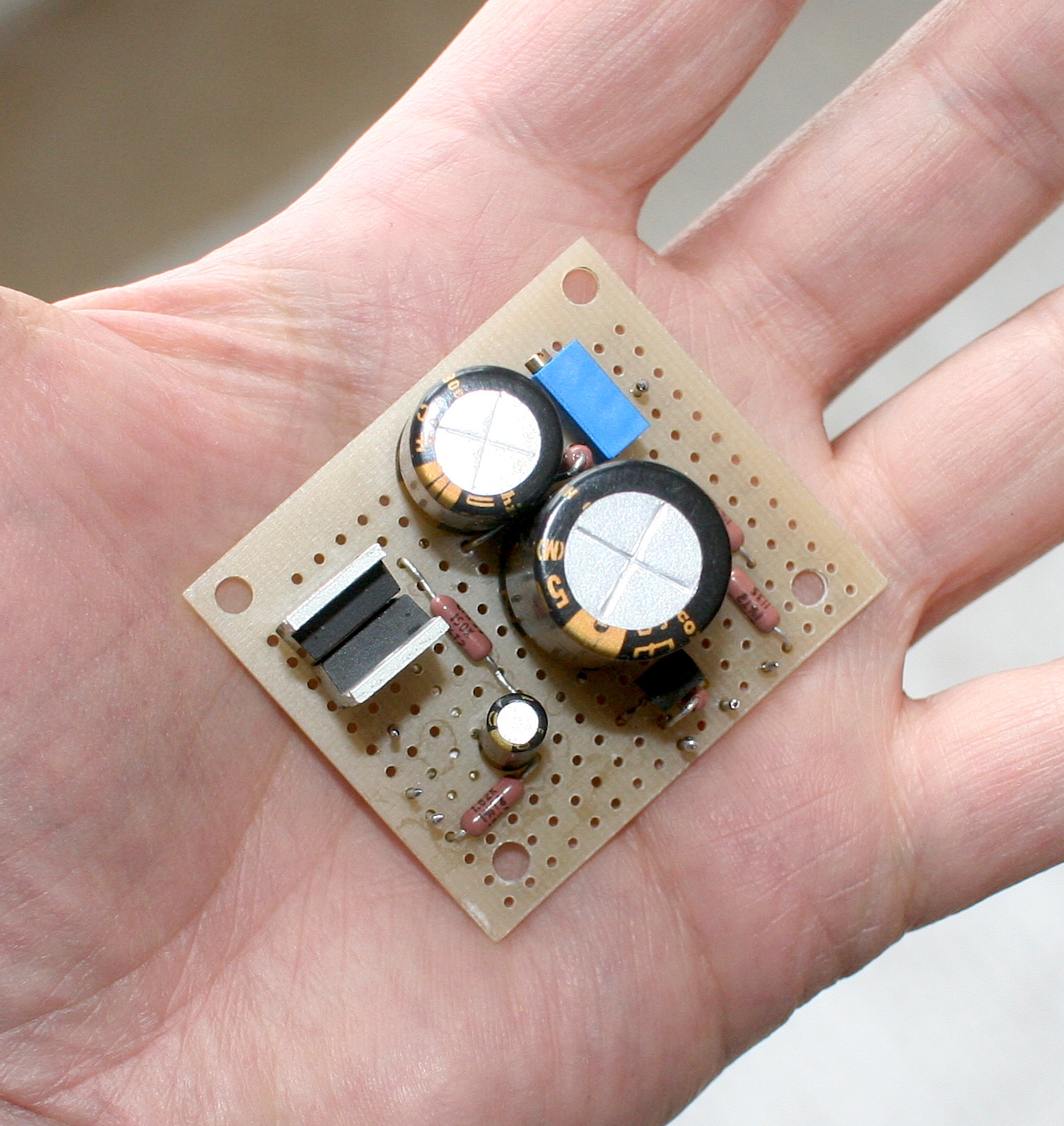

I'm considering a simple RC filter on the rail instead of a capacitance multiplier. Simulation based on a 10,000uF cap at that location looks like this is able to provide the same benefits. It keeps things closer to the spirit of the original circuit, which appeals to me. However, the simulated performance with the additional output devices, cleaner DC supply for the front end - adds up to a significant performance improvement.

You are OK.
I did not realise your TGM9 had a target maximum power of 6W.
On your post29 pic you show a snubber across the output of the bridge rectifier.
It may be better to move it to the input of the bridge rectifier, i.e to the transformer secondaries.
The mains fuse should be before the switch.
There is no target, just trying to make a JLH69 with parts on hand. It will be enough for the application.
On your post29 pic you show a snubber across the output of the bridge rectifier. It may be better to move it to the input of the bridge rectifier, i.e to the transformer secondaries.
I think this was discussed already - it is where it is, no plans to move it now.
this is a limitation of the design of the soft-start circuit (eBay). Not perfect at all, I will think about this.

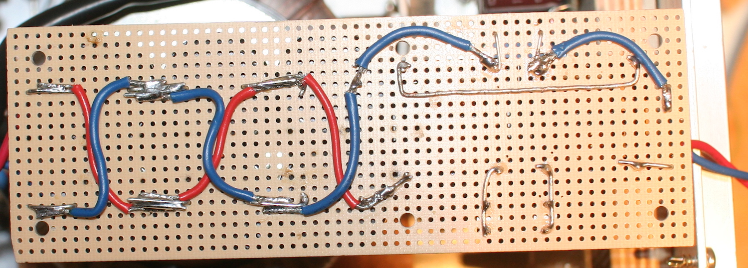

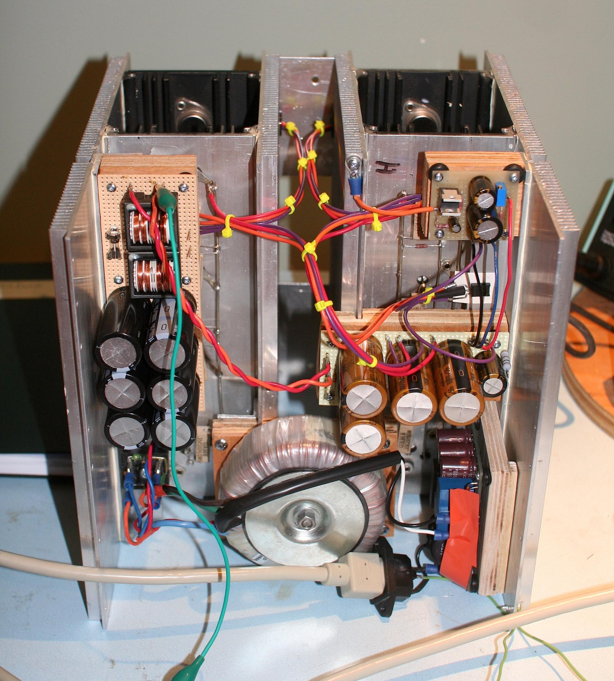

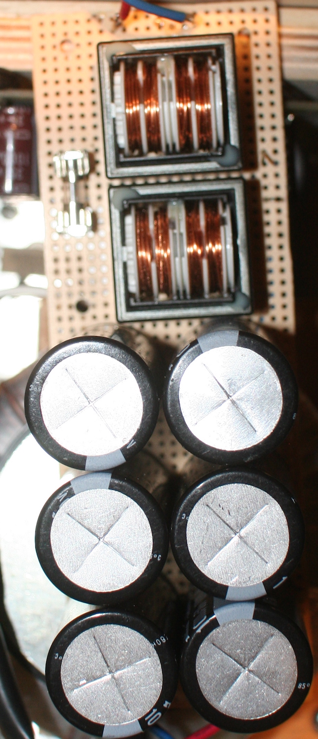

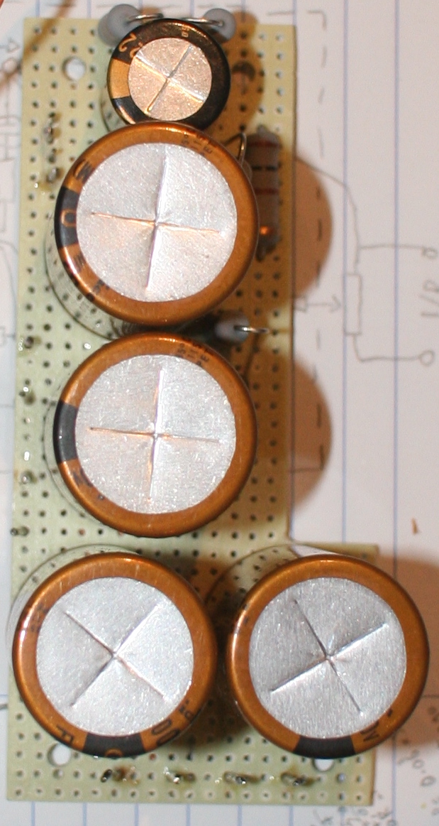

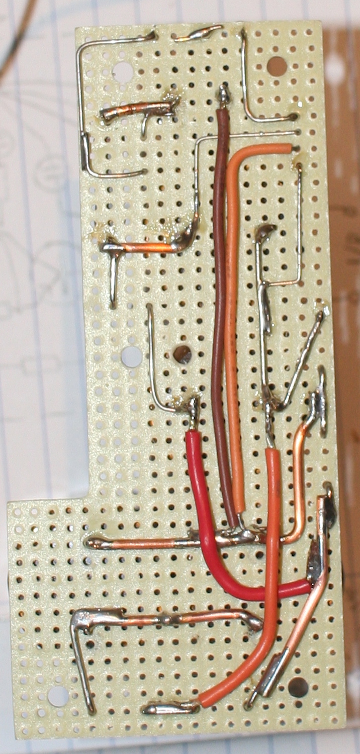

Some progress!
The power supply board is done, big black caps. The underside wiring is 'very DIY' !
Also found some more perf board in the scrap box to hold the big gold caps. These are the final rail cap, output caps and front-end filter cap. And a Nichicon MUSE cap for the bootstrap. Underside wiring even more crazy! Next step is to find some more perf board to build the input stage.
I checked it out be rewiring it up again as a Follower. Get V+ of 24V at idle. My multimeter 'sees' around 17mV of a.c. ripple. I'll get a CRO on it once more of the amp is built.

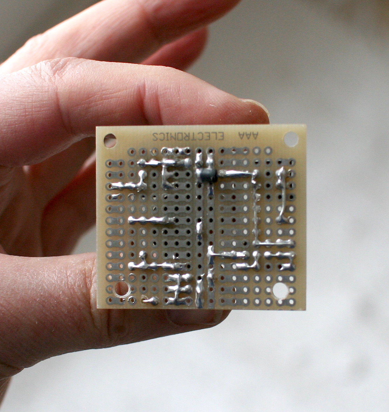

Last board.
I found and cut a small piece of prototyping board for the small signal circuitry - all the parts around the input device. And I included on the board two back-to-back TO-220 diodes from the scrap bin to form the earth loop interruptor between signal ground and chassis.
I used Dale 1% resistors all-round (happen to have them in the parts bin)
I also used Nichicon Gold (and MUSE) 50V rated capacitors all-round. Even the input cap is an electrolytic. It will be polarized (approx. 10V) and at 10uF it will have little a.c. voltage across it.
A small 470pF NPO/C0G cap was used for the input rf-filter. I like these too.
For the input device I found a nice 2SA844 pulled out of something old - a very good quality transistor, possibly over-spec'd here.
For the phase splitter, TR3, I found a nice 2SC3419, also pulled out of something old. These devices have a low Vsat (nice for lower power rails) and tolerate a lot of collector current if things go pear shaped.

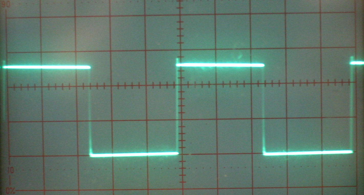

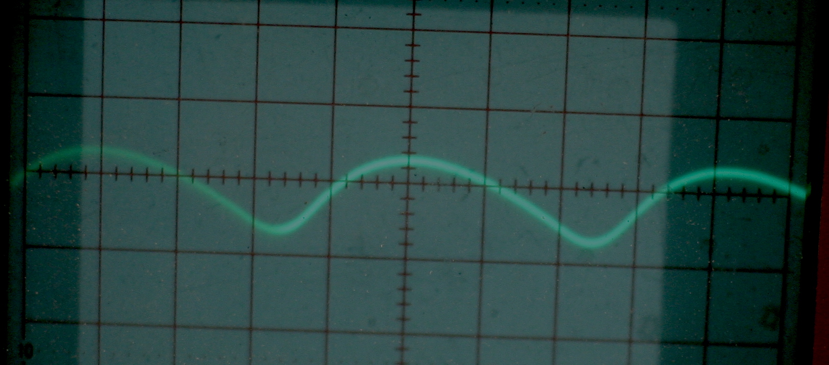

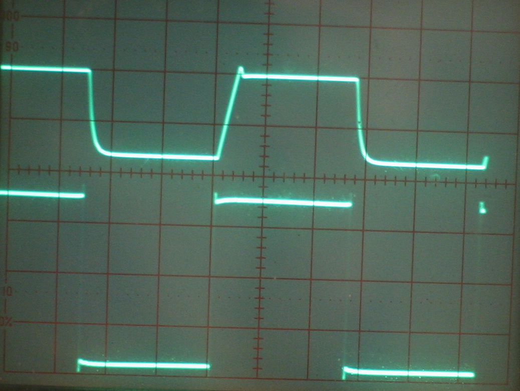

Got the CRO out. Hooked up an 8R load to the output.
Some images:
First up (left) - power supply output ripple. Looks nice and smooth, 120Hz with 50mV pp on the +ve rail. The output of the amp shows only 2mV to 3mV pp of ripple
Second up (middle) - 1kHz square wave 500mV pp input (test point output on scope); output looks reasonably clean and at 5.2V pp we see the gain is around X10.4
Third up (right) - hooking up a signal generator provide a 20kHz square wave input (lower trace - not that clean itself). See some ugliness now on the leading edge of the output (upper trace) which was unexpected; some of this is crap from the poor signal generator.

With a sine wave input the output triangulates at 100kHz, but it's amplitude dependent and the triangulation appears only above 3V pp at 100kHz. The input r.f. filter would not cause this so it a limitation of the amplifier (slow output devices ?)
Clipping was explored using a 1kHz sine wave and turning up slowly till I could see the tops flatten in the output waveform - i see it is very close to being symmetrical at an output of 22V pp. Implication is a peak output of roughly 7W into 8R.

The middle pick shows overshoot.
This is usually more visible by upping the sqw frequency or using the horiz times 10 switch.
I recommend you ALWAYS endeavour to eliminate overshoot of a sqw test signal.
Overshoot and ringing can look a lot better if the input filter rolls off the HF.
Overshoot and ringing can look excessive if the input filter is disabled AND a too fast sqw test signal is applied.
One needs a happy medium for the speed (rise/fall time) of the test signal.
Is the rightmost pic confirming that the test signal has overshoot?
Could the test signal be seeing the wrong impedance and it's a reflection of the fast signal that is creating the overshoot?
Is the generator a 50ohms source impedance?
Is the cable a 50ohms impedance?
Is the load at the amp PCB a 50ohms impedance?
I haven't had much time to work on this of late and that time was spent working on the chasis. I'm not a huge fan of chasis work because I don't have a proper workshop and rely on a power drill and other hand tools.
Yes, it does look as if the test signal isn't clean itself, both +ve and -ve going edges.
Yes, it's a real possibility because the test set up was not optimized to avoid impedance mismatch - there were probably several points where a reflection could occur. However, despite my poor experimental technique I've had clean waveforms from testing of other amplifiers I've built.
The waveform shown on the right (my post above) shows not only an overshoot on the +ve edge but that the shapes of the edges are different from each other.

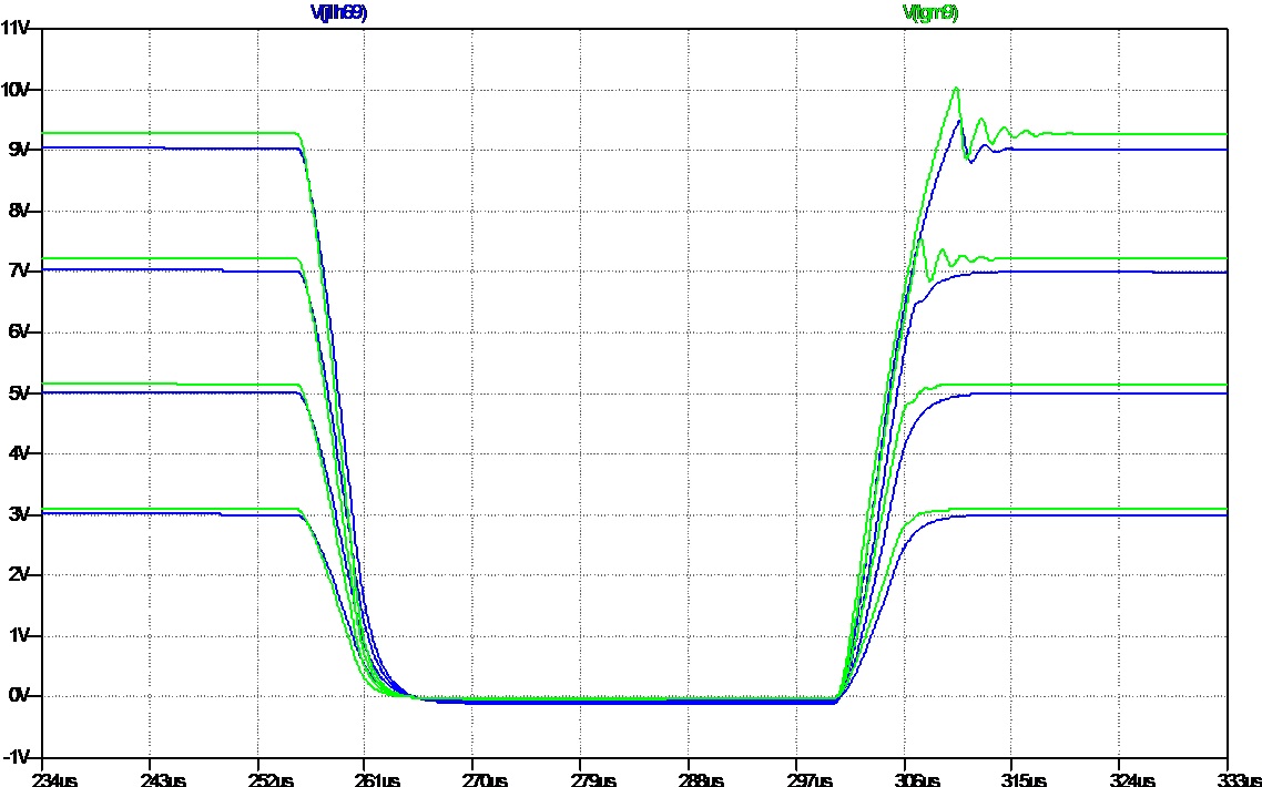

I thought I'd feed a square wave into my simulated circuit to see how it behaves and what I see looks qualitatively similar to the measured waveform. At low signal levels it's clean but the +ve edge starts to show over-shoot at higher signal levels.
The attached plot shows several different signal levels for a 10kHz square wave, both for the original JLH69 (blue traces) and the TGM9 (green traces) version.

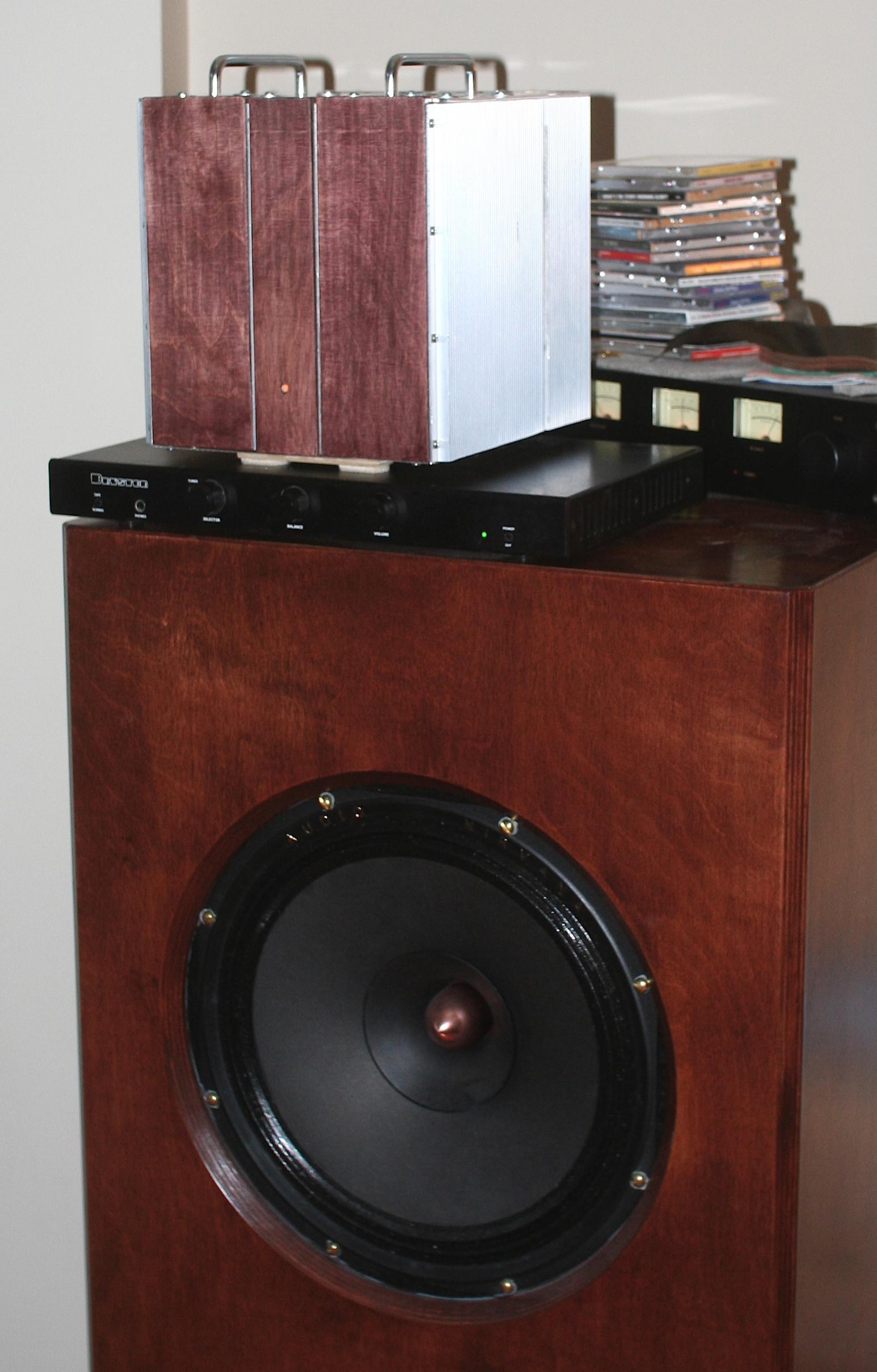

First Listening Test on the Big'un Speaker
So I've put some bits of metal and wood on the chassis to make it presentable. And I've installed it on top of my slimline Bryston integrated (using it as a pre-amp) so I can play it through my Audio Nirvana 15" open back box speaker. Source is an FM tuner on the local French channel (they seem to have the best sound quality of all the FM stations I can pull in with a simple antenna).
It sounds quite different from my SET. The bass is stronger, cleaner and deeper. It sounds just as smooth as the SET amp. :checked: 🙂
And of course, with 7,000mW of power it beats my SET amp (which may have 2W or so). I'll need to hook up my CD player for some more critical listening.
