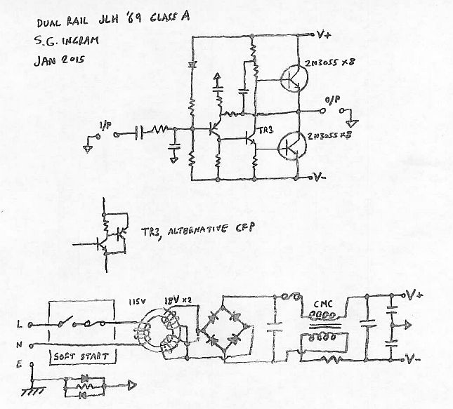

I did a bit more listening. Finally I can know what is the JLH69 sound!
It has a nice sound, a bit laid back, not as 'accurate' as my Recent class AB amps. This promted me to consider a bit more exploratory work.

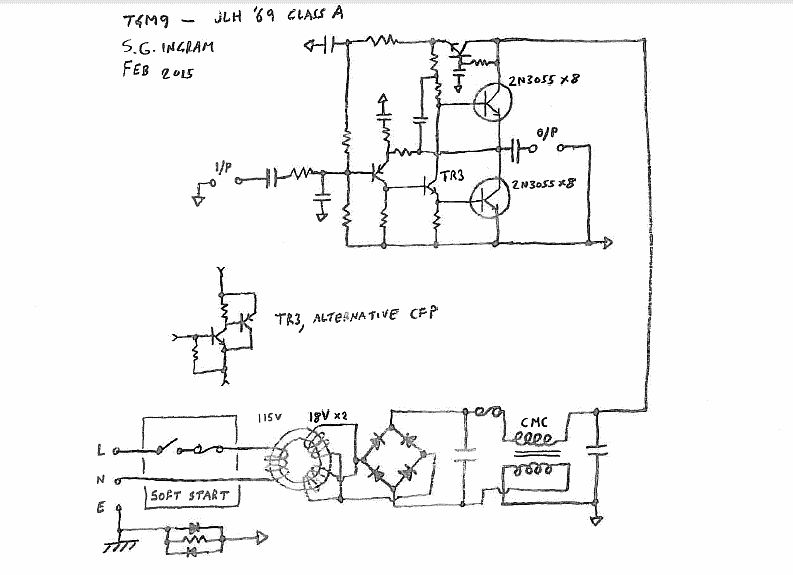

This evening I modified the amp by installing a Sziklai pair in place of TR3, the phase splitter/VAS. I used a 1k collector load for the master device across which the slave device derives its control voltage. The higher Hfe of this pair required some asjustment of the input device bias to keep the output at the mid point of the power rails.
I installed a 33p np0 cap across the b-c of the master device to ensure similar phase margin to the version I had before. Simulations say this will provide a similar UGF but with a good bump in OLG and a corresponding decrease in harmonic distortion, especially 3rd order and above.
A 1kHz square wave produced a clean output waveform without ringing.
Sound: I was not happy with this change. The magic seemed to be gone and the sound became a bit sterile. It was a cleaner sound, but bass was not as deep even if still well defined. The mids were 'flat' and overall I felt some irritation although I would not describe it as harsh. I would be happy with a cleaner sound but not an irritating sound. Interesting that my TGM2 gave me a similar feeling, it was an experiment with using a CFP LTP input stage compared with a regular LTP.
I will sleep on it, but chnaces are that I'll remove the CFP and go back to a single device for TR3.
The beauty is back!
I ripped out the CFP VAS and put back the single non transistor. The readjusted the dc-offset to half the rail voltage.
The sound is back ! - I don't think I feel any more temptation to mess with it. Now it's time to sit back and enjoy 😎
This version of the JLH69 is now highly recommended!

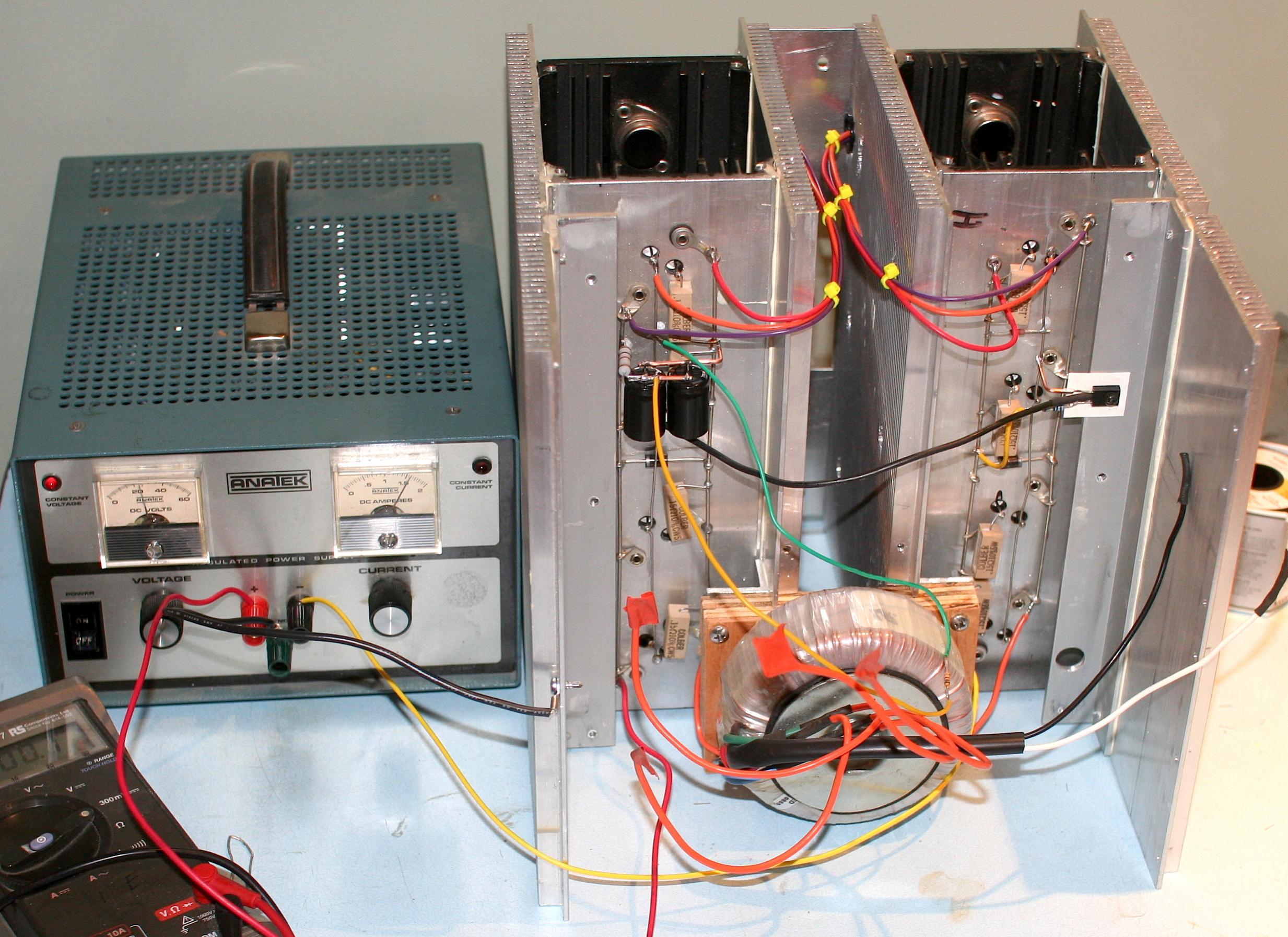

Gareth, great project. I like the compartment design - vertical, with open "windows" at the top! 😎 Better airflow for sure.

The idea of a cooling chimney always made sense to me but whether it's worth the time to make one is another question!
Attached - final as-built schematic.

The 2N3055 is the pick up truck of power transistors, they are built rugged and you can throw them in to anything. But they were not meant for the high end. I happened across some heatsinks with a bunch of them riveted in place and took up the challenge of putting them to work. I learned along the way that the PSRR of the JLH is not great but can be readily improved in ways I hadn’t seen others use and that’s the main innovation in my version. The CFP VAS did not enthuse me.
Were I wanting to build another JLH69 I would take a different path with fewer output devices and they would not be these old one’s either.
I have purchased a Chinese made stereo amp which is the JLH69 circuit tipped upside down to use p-type outputs. They are LatFET’s, at least claimed as such. It sounds good, I sense that it retains some of the polite sound of my own JLH. Works just fine with a single pair of outputs. I bought it with the intention of transplanting my own design into it, saving me a whole lot of work by re-using the existing chassis, connectors, mechanical parts for the volume control extension rod, etc. And it looks nice roo. I’m not in a hurry as it sounds pretty good but I have wanted to build the JLH69 with the front end of my TGM8 amplifier.
Hope you are enjoying the hobby!
