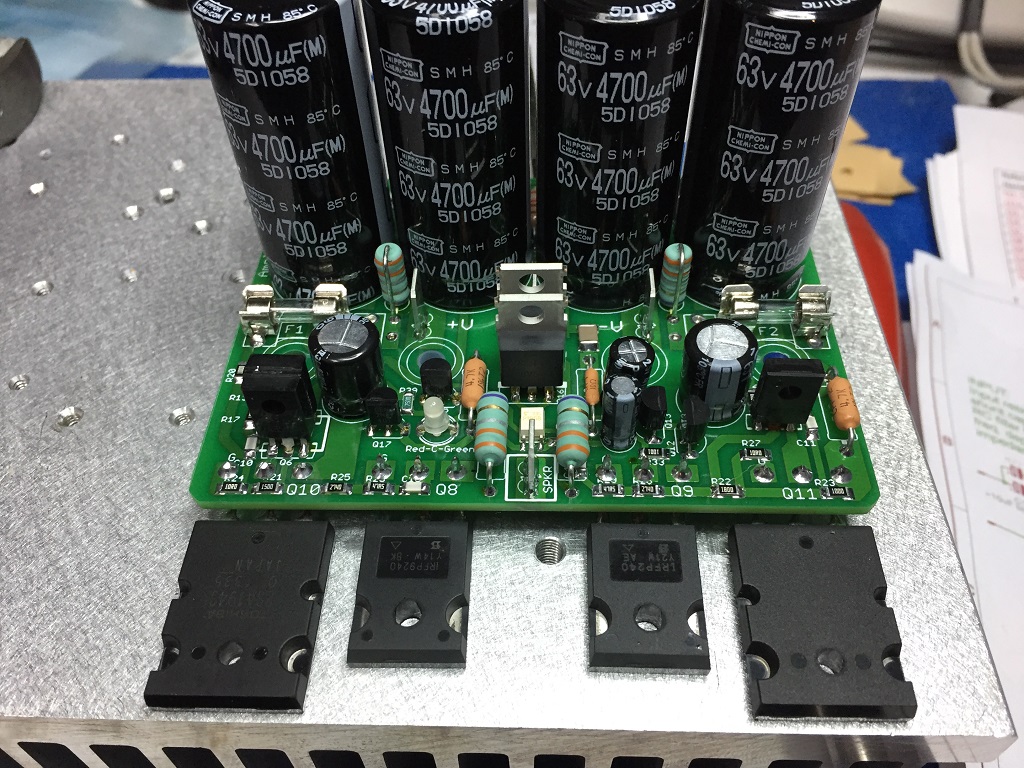

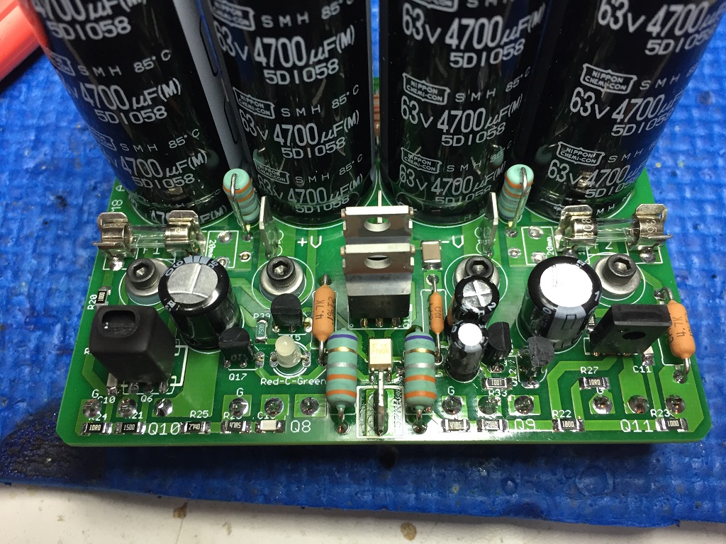

I just realized that R10 (series feedback res) is 1/2W instead of 1W as per BoM. Should I change this or I'm fine with 1/2W?
I just need to clean the underneath of the PCB, then I can fire up this amplifier for testing.
Do
I wouldn't worry at this point. I don't think it will be an issue.

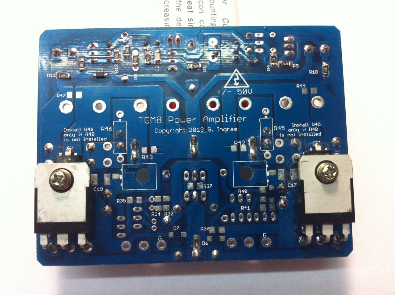

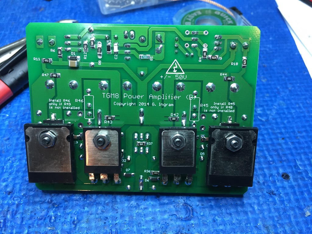

So here's some new pictures

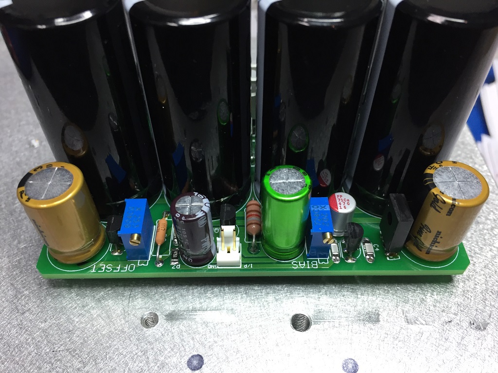

I'm a bit confused by C3's orientation now... Please let me know if ok. I have the latest PCB, B rev and latest schematics shows negative to gnd, which I did but then I read it was the opposite which I believe also it should be..? Am I right? If yes, then C3 needs to be swapped around.

I realized that C17 and C19 are not mandatory and I will most likely remove them.

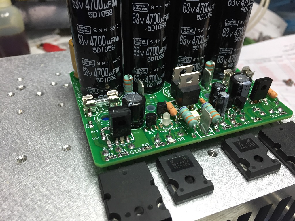

I am still at work - let me look at this in more detail once I am home (later this evening as I am working late today). I'm afraid all the power devices are incorrectly installed - do not power it up yet!
Oh... they go under the PCB? Not a problem if it's how they're installed. Can be fixed pretty quickly. Thought the holes were just for holding the board on the heatsink...
I'll wait for your input.
Do
Yes, the power devices go under the board !
I guess they don't have to, but if you mount them out to the side like you did, they need to be the other way up, shiny side facing upwards or the pins are reversed.
To mount them underneath you need spacers between the power device and the underside of the pcb. There are photos and descriptions in the thread somewhere. Here (attached) is a photo to show you how I made spacers. I used some extra TO-126 packaged transistors, BD139 probably. The advantage is that they are of uniform thickness, have holes of just the right size. I cut the leads down so that only the centre lead is left just a short bit, then I use it to solder the spacer-transistor to the board. It's not a great way to make an amplifier and I don't do it exactly like this on other designs but it does work. Look at the photo, it shows the spacer-transistors in place. You don't need to solder them, you can stick them on with some glue instead - probably much easier. It's best to bolt the spacer-transistors to the board when you solder/glue them so that the holes are properly aligned with the holes in the pcb.

Attached here is another photo that shows how the power devices fold underneath the pcb. To ensure that the power devices are installed properly I recommend the following procedure, after you first install the spacers.
You bend the leads of the power devices the right way and install them into the pcb without soldering. You'll have to clean up the solder from the holes first. Then you bolt the assembly to the heatsink, a bolt through all of the power devices. This forces the power devices to be flat against the spacers, and flat to the heatsink. Then you solder the leads to the pcb. When you remove the assembly from the heatsink the devices will be attached to the pcb all properly aligned and parallel.

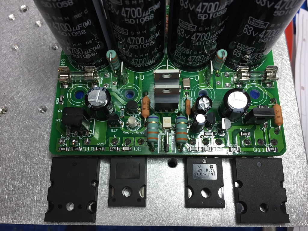

Here's another image (attached). It shows the power devices (just two of them) installed on the underside, with the spacer transistors between them and the pcb. This is a photo of the build by Christian (Ranchu32) who was the first person to assemble the amp on the original board (he had nice blue coloured boards!). The bolts he installed for this photo are temporary - however, I recommend bolting the assembly to the heatsink when soldering the power devices instead.

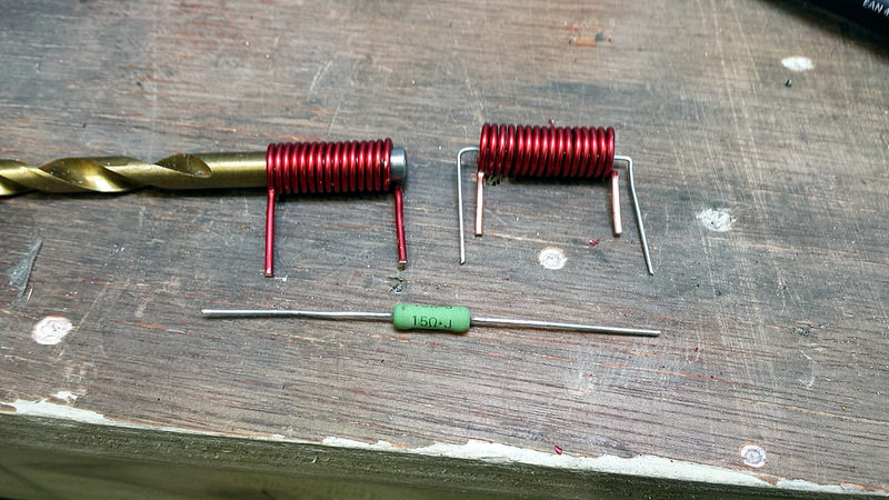

output inductor - yes, good idea to use one. In this design I kept it off-board. I placed it in the speaker wire between the pcb and the speaker binding post inside the chassis. See photo (attached).

For the output inductor, how many turns would you put on it approximately if wounded over a double A battery? Or you can give me approx value and I will find an online Calc to find diameter, wire size and number of loops.

I dont think it needs to be exact, something like 15 to 20 turns around a pencil should do it. Its usually recommended to solder a 10R to 15R power resistor in parallel with the inductor. See attachee image I found on the internet. Youre looking for something in the range 1 to 2uH.
