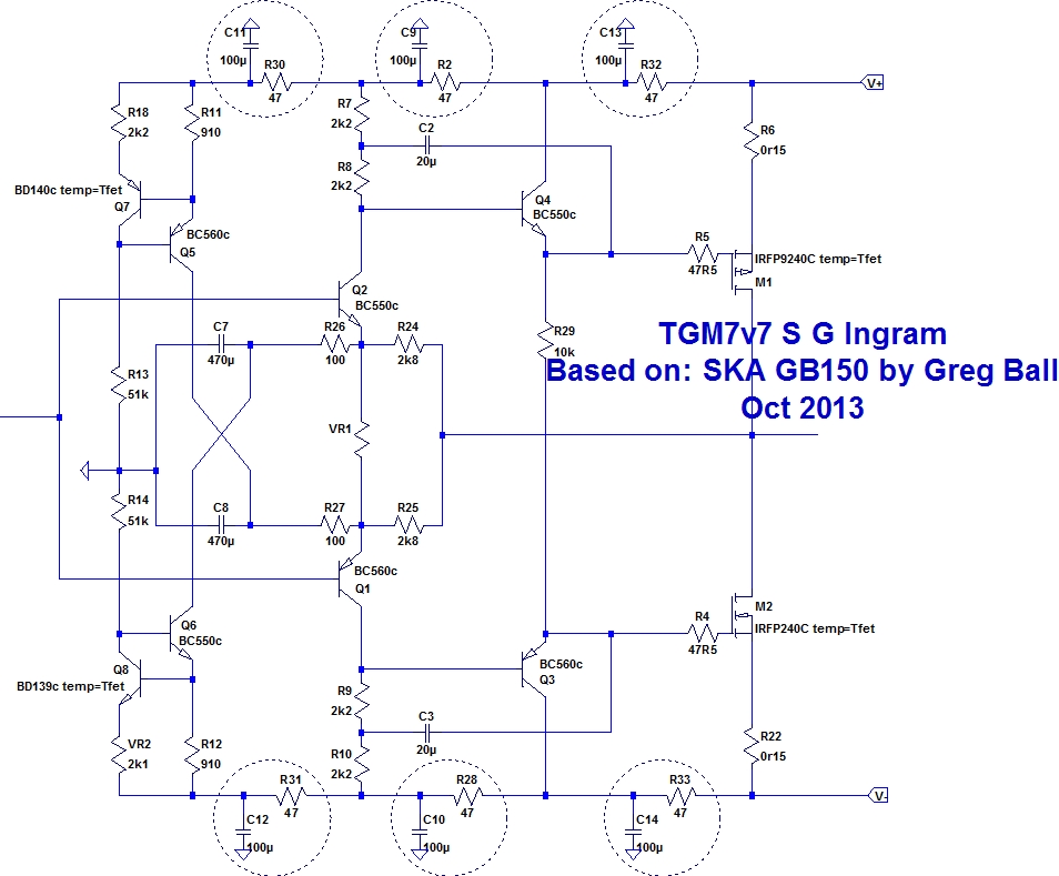

OK - here's an image of a simplified circuit to show where I tried adding RC filters - of course you add them in pairs to both + and - rail. I show 3 locations. None of them work to improve PSRR, and two locations actually make it worse.
Here's why: the input signal comes in from stage left, it's referenced to ground. It is fed to the bases of the input transistors.
All transistors are essentially a voltage controlled device, a differential signal between base-emitter controls current through collector-emitter.
The emitters of the input devices are also referenced to ground through the feedback network. So the input signal modulates the current through the input devices.
This modulated current flows through the collector resistors to generate a voltage across these resistors. This amplified voltage is the difference in potential between the collector of the input transistor and the other side of the collector load, which is the power rail.
So the input pair convert the signal reference from ground over to the power rails. The power rails have essentially become the a.c. 'ground' for the signal at this point in the circuit.
Ignoring the emitter follower buffer for now, the differential signal across the input pair collector loads is applied to the gate-source of the output FETs. The output FET source is also referenced to the power rail. This input signal to the FET modulates the current through the FET and hence through the Drain and into the load. So finally, the signal to once again referenced to ground through the load (speaker).
So where the power rail is acting as a.c. ground for the signal between the input pair and the FETs you can't put a filter in it. If you put an RC filter in the supply rail at this point then any rail noise from the power supply will produce a voltage drop across the R of the filter. This voltage drop will add to the signal a.c. 'ground' between the input pair and FETs. The FETs don't know the difference between the real signal and a voltage drop across the R of a filter. So the rail noise is injected into the output. The PSRR gets worse with a filter.
An RC filter to isolate the current sources doesn't help either since the current sources are already well decoupled from the supply rails. It doesn't cause any harm here though.

If you want to get lower distortion and better control over the idle in the output stage i will suggest to mirror the signal into Q4 and Q3. (but what to do with the capacito feed forward...?
Another option could be to make a CFP input, this will lower distortion app 20-30 dB
Hi MiiB - I think we are OK with output idle current control using the temperature feedback to the CCS. This in turn stabilizes the current flow through the input pair. I think this approach, that Greg uses, is better for this topology than the traditional Vbe multiplier. In my TGM5 I used a Hagerman Vbe multiplier to stabilize the bias despite temperature fluctuations in the VAS current. But in a CFA version of the SKA, the temperature control of the CCS keeps things on track all through the amplifier.
The CFP input is an interesting possibility - but I don't want any more challenges with r.f. oscillations than I have got already. Of course, it could be added, I've made a point-to-point CFP replacement for a VAS transistor before that didn't require any pcb layout alterations - that's in my TGM6.
Hi Fab, yes, it would be quite a large cap!!! Well the place for the RC filter must be in the main power rails.

I think there is no place for any R anywhere on the supply....🙄 except for a very small R in a C-R-C maybe ...then why not a C-L-C...

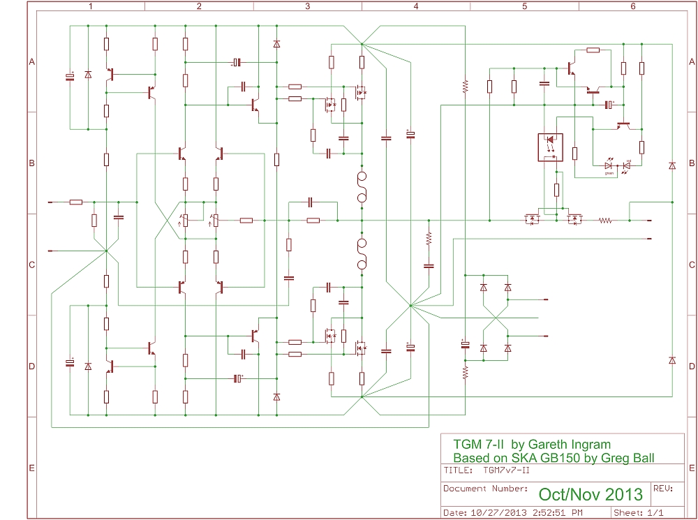

OK, now it's time to start-over in Eagle and do a 2nd board. This time I am tempted to include the dc-speaker protect (no input capacitor on the amp remember) and power supply. The question is how to avoid getting the earthing wrong when the end result will be multiple channels ?

Well, change of heart.
I have made up a schematic with both VFA and CFA options. Depending on which version I want, I simply populate different parts into different locations on the pcb. No power supply or dc protect included but it all fits on the same small pcb as before. I've used considerably wider traces for all high current paths with Quickfit connectors (they are quite popular I notice) for power supply and output. The wiring is simplified, no via's needed for example. I upgraded the main zobel resistor from SMT to a through-hole power resistor and also added separate zobels at the pins of each FET.
For the most part signals are placed above their return current paths. For example, the output currents are routed on the top, whereas the power rails supply to the FETs run underneath them.
In this design the drive signals from the LTP collectors are a.c. referenced to their adjacent power rails. The power rails are effectively the a.c. signal ground for this part of the circuit. So these gate drive traces are routed so that they have a continuous backplane of the respective power rail underneath them.
Overall, traces are shorter so I think it's a better layout than my first version. Assuming I haven't made a booboo somewhere.

All things being equal you should be able to do a fair comparison between the 2 design versions since you have essentially the same layout and parts. However, to be completely fair the CFA will probably need a bigger or better power supply ....
