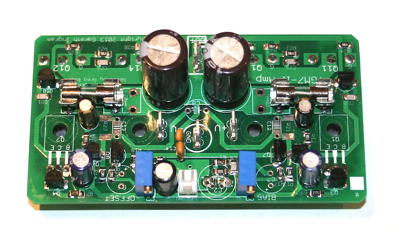

Yes - the boards arrived on Friday. Yesterday I started to populate one of the boards - it won't be super-fast due to all the Christmas events but over the next few days / week I hope to get one board fully assembled. This first board will be built with dual LTP input like the SKA GB150.

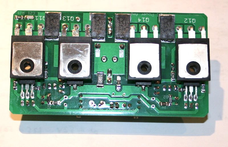

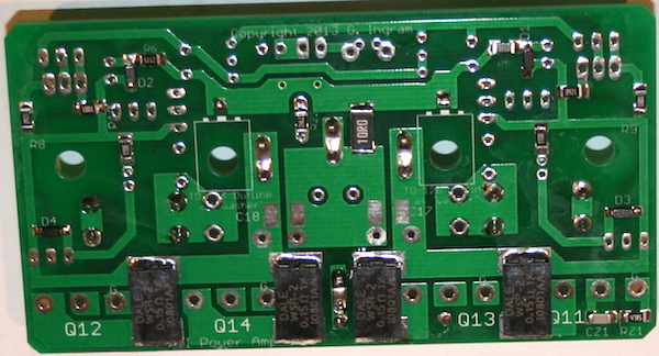

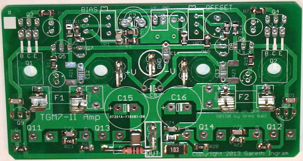

I'm now assembling the first board, TGM7-II, re-spun to see if I can quell those MOSFET oscillations. I've installed all the SMT parts for the VFA version. It's not perfect as I took parts off the old board (I'm a cheapskate 😱 )
