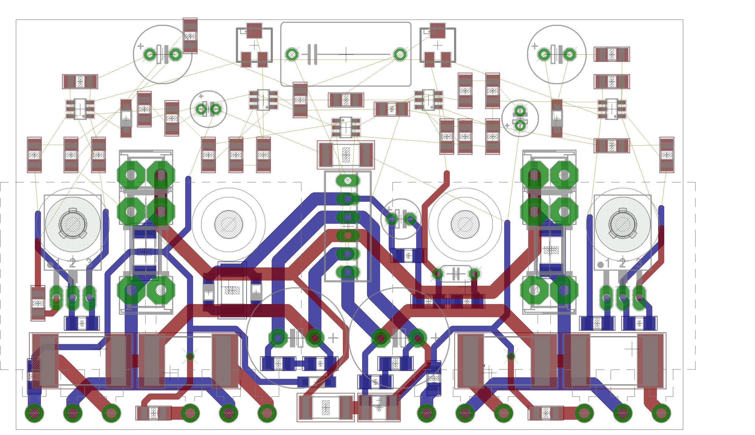

Well I've managed to put the gate stoppers at the gate pins - I think this is the best approach. The suggestion to include gate zobel's is interesting, but not sure I have the space for it.
I've attached my work-in-progress on the layout, so far just the high-current circuits are in place.

Well, I nearly finished the layout when I had sober second thoughts about using the dual-transistor SMD parts because of ease of use. Soldering 1206 resistors is easy and SOT-23 transistors is quite doable because the 3 legs are far apart (which means they end up being same size as a TO-92 footprint!). But the dual pairs come with 6 legs and even though they are bigger than the SOT-363 I used in TGM5 I think they will be a nuisance. They will be harder to install, harder to replace or repair and future availability is unknown. So I've reverted to good old TO-92's and I can now use the parts recommended by Greg if I want to 😱
The LTP pairs and the drivers are mounted face-to-face so they will track thermally. A single socket on the board is used for all signals. I also added a pair of diodes (opposite polarities) in parallel with the ground lift resistor to protect it from error conditions on the ground.
Since the pcb will be mounted against the heatsink the board will be oriented vertically I've specified side adjusting trimpots as they will be easier to access (from above the chasis) for adjustment.
The board size has come out around 96mm x 52mm. It would be nice to shave it down to 96mm x 50mm but I'm not sure the design rules will allow. I've never used an outside pcb house before so I will need to do some homework.

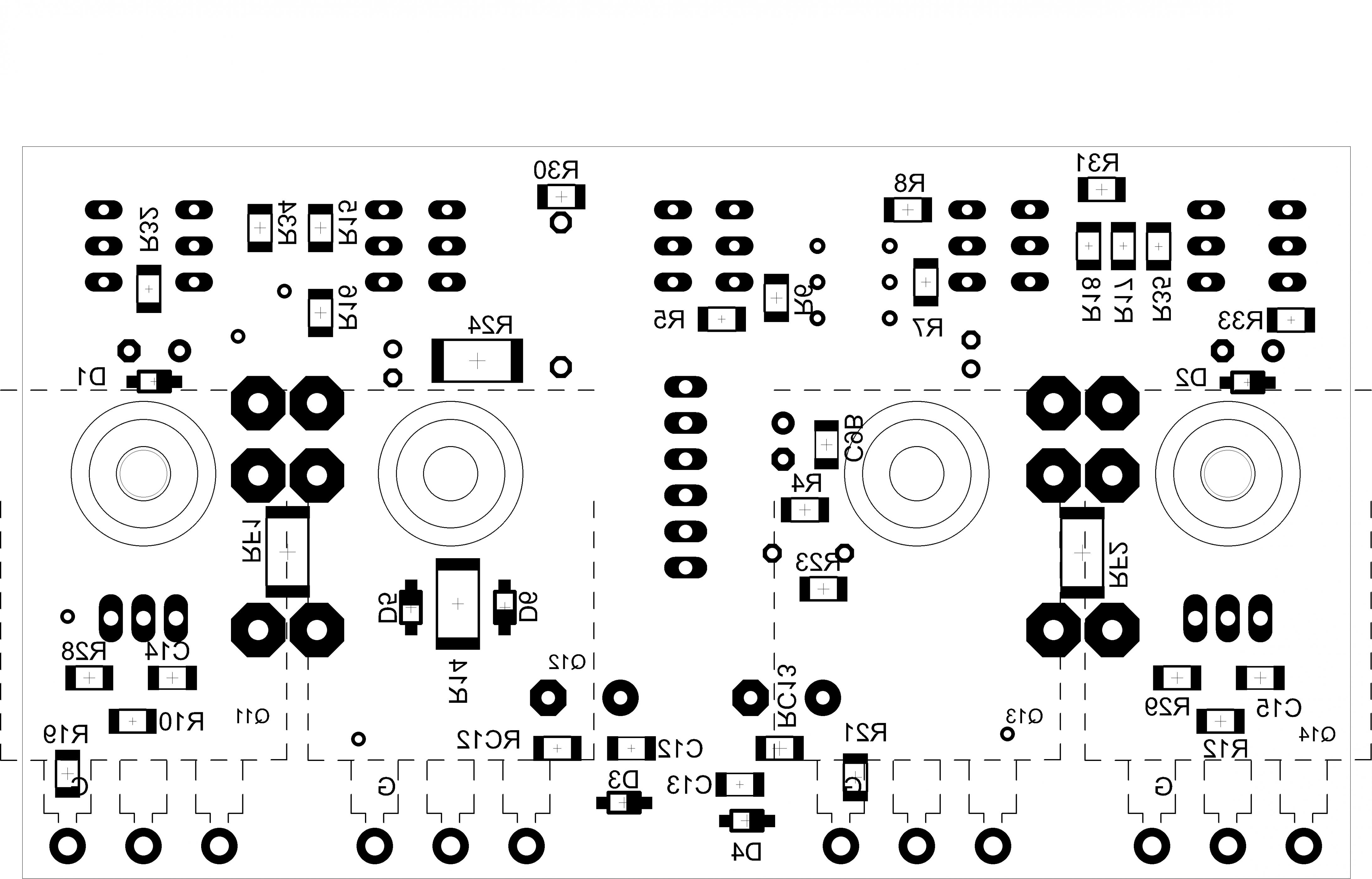

Attached is a component-only view of the top and the bottom side of the board. The bottom view doesn't show the temperature sensing devices (I may fixe this eventually).

Beautifully neat layout, Gareth. If boards do become available, they will encourage me to try my first SMD's!

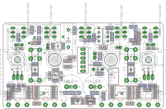

I've run the Eagle ERC - no issues. I've run the Eagle DRC - got drill size errors on the via's (there are very few via's) which all look just fine to me so it's a strange error. But what irritated the most was that I got over 500 Stop Mask errors. Jeeez. I downloaded the DRC (.dru) file from the vendor I'll probably use: ITEAD Studio - Make innovation easier and ran their DRC. The drill size errors went away but I still have 525 Stop Mask errors. I looked at several of them in detail and they look like complete nonesense that can be ignored.
Next step, I have to figure out how to create the Gerber files (not related to Gerbils I hope 😀 )

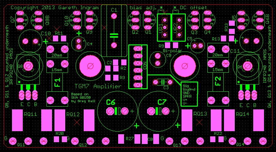

Update: I have done some checking of the design:
1) Eagle schematic matches with my Spice schematic and GB150 where relevant
2) Pin outs are correct (Eagle has a different pin out for the small signal devices than indicated in the spec sheet from Digikey
3) Checked spacing of traces for sufficient clearance for 100V rail-to-rail voltages (+/- 50V). Didn't like what I found. Seems that I have been working on the design with a zoomed-in view of life. I had to rip up half the layout and start over. I've settled for a compromise on some of the parts locations but I'm much happier with the layout of the traces - less complex, wider traces, better separation, shorter and I think more robust to manufacturing tolerances
4) lengthened the leads on the temp. sensing devices for a bit of tolerance in mounting to the heatsink. Likewise enlarged the mounting hole diameter by 1mm for a bit more tolerance
5) printed out and checked the gerber files. Noticed that text changes - Eagle defaults text to a 'proportional font' but conversion to gerber extracts it with fixed font so I changed the text in Eagle to 'fixed' font and that let me tidy it up.
6) ERC and DRC is clean (except Stop Mask)

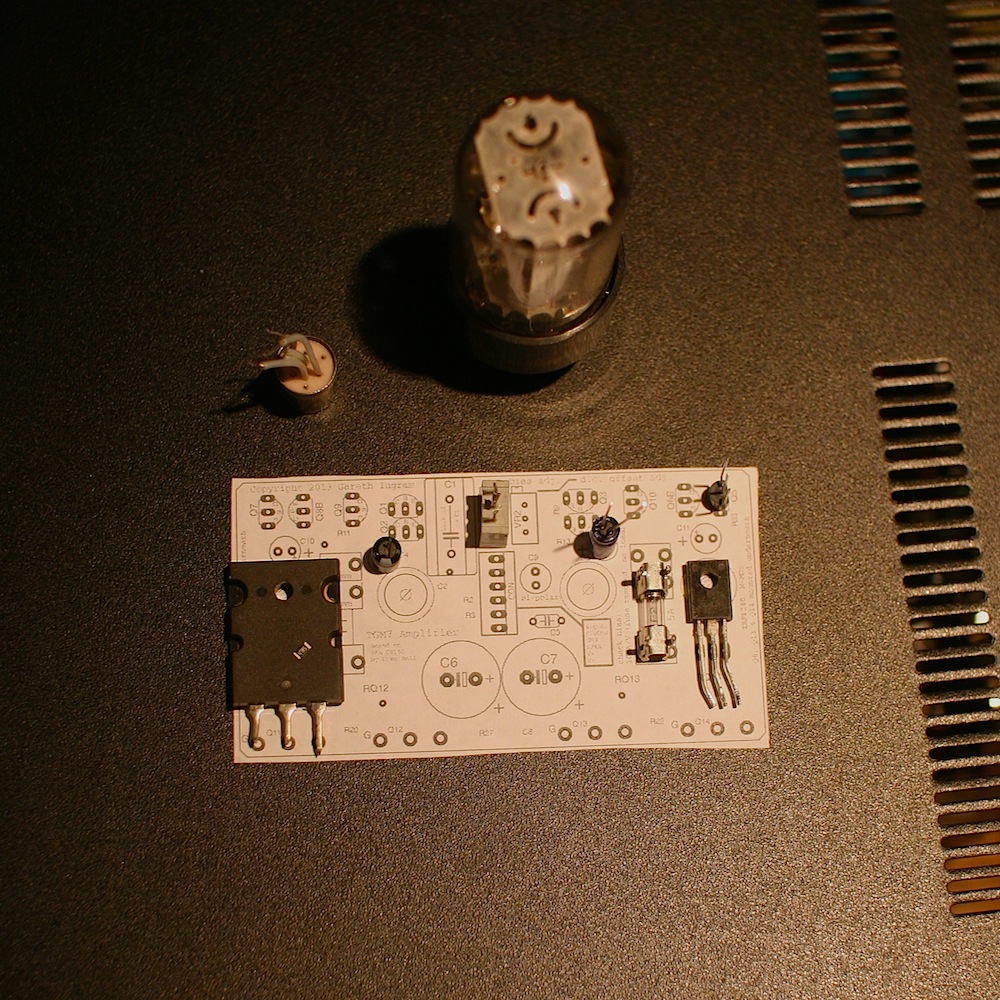

I thought I'd do a sanity check on physical size after losing track of the real size of things - see photo.
Perhaps you can recognize a couple of components in the photo that don't have a place on the pcb ? and if you look carefully you can see a 1206 size SMD resistor.

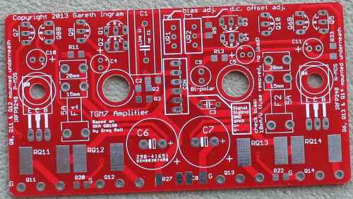

Gareth,
You have dominant H3 - can you subordinate it to H2? It would sound a little 'edgy'.
Beautiful pcb design!
