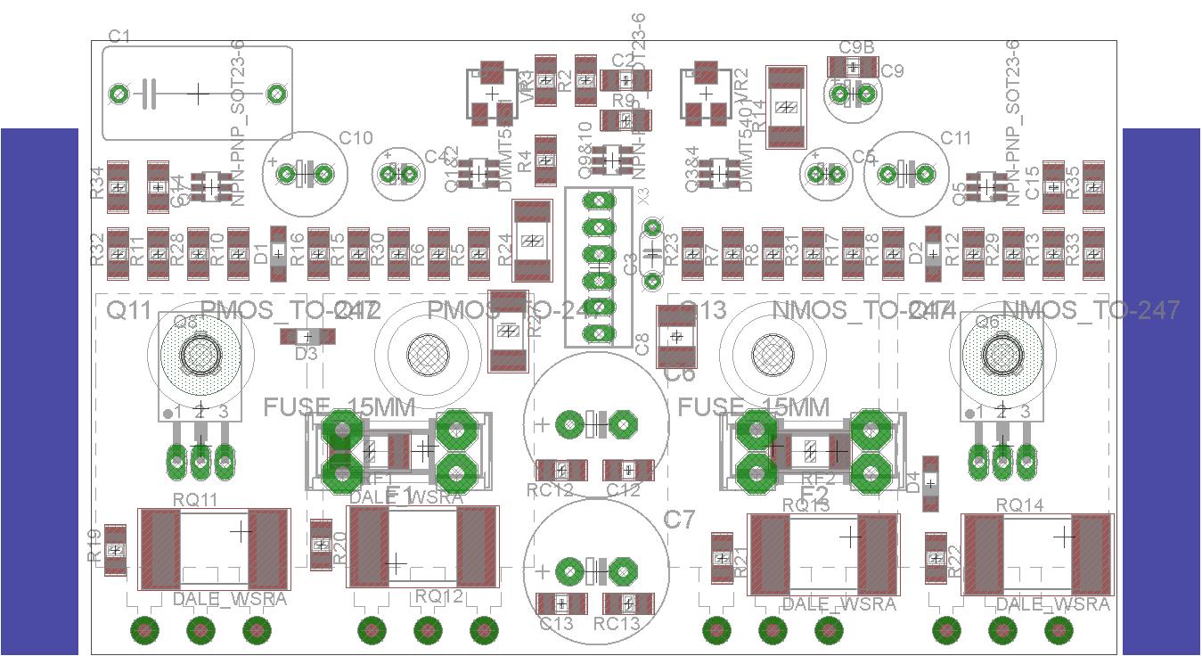

I plan to start on the pcb layout soon. I'm tempted to try something new and different from Greg's but on the other hand it seems silly to reinvent what is proven to work well.

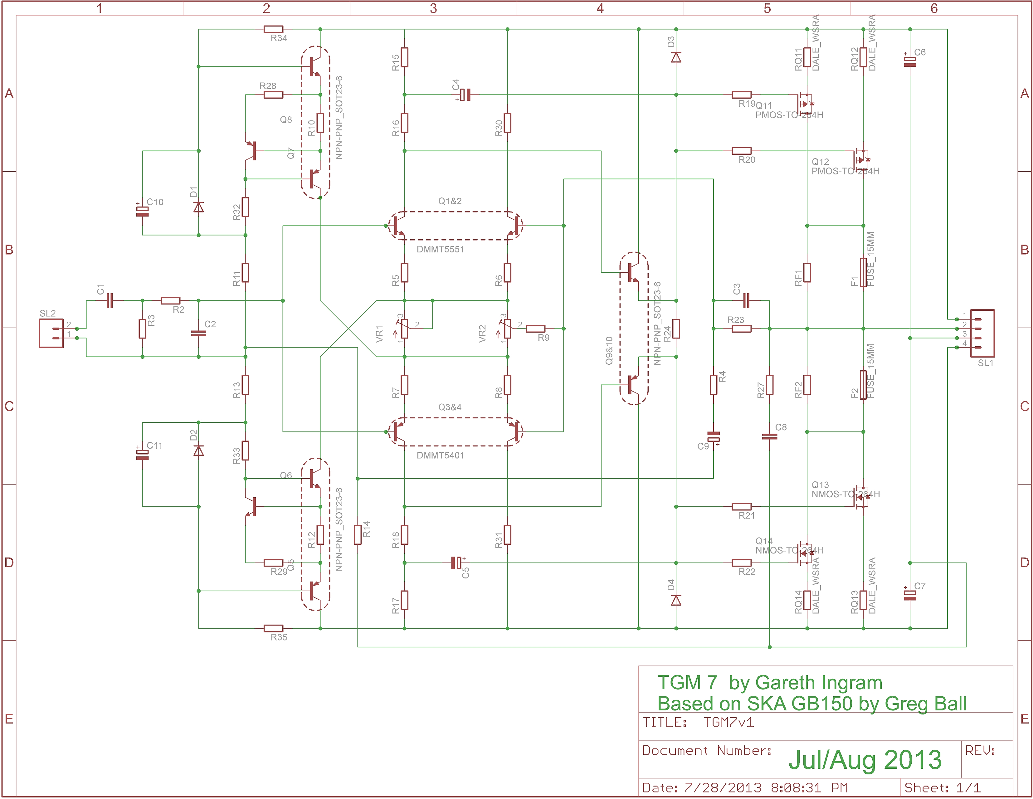

So I have looked into the 'zener mod' that is written about and made my best guess. See first attachment. The zener diode pins the voltage at the junction of the two resistors of the current source tail to a fixed drop from the power rail. This acts like a 'super diode', a shunt regulator that works all the way down to d.c. In my sims is offers nearly a 10x improvement in PSRR at d.c. over a small capacitor by itself. It looks like a good tweak and I understand it has been popular.
I'm leaning towards a slightly different solution, an emitter follower regulated current source. See second attachment. I've added a simple emitter follower to the power rail feeding the current source. A zener diode fixes the voltage so it will act like a voltage regulator. In simulations at least, it is vastly superior to the 'zener mod' described above in terms of stabilizing the d.c. performance of the amplifier since it essentially regulates the front end.
It also provides a very controlled and slow turn-on for the current source because it also behaves like a 'capacitance multiplier' of JLH fame. This allows the in-rush current to the MOSFETs to be strictly limited.
It also provides a good deal of PSRR improvement - this is probably as good as it gets for the current source PSRR for simple arrangements. The PSRR of the amplifier is mostly dominated by the current source but once the PSRR of the current source is reduced to these levels then there are more subtle factors in the inter-play between the amplifier stages - possibly a diminishing returns scenario.
The tempco of my emitter follower buffered current source is unaffected by this change and in the form shown it's simulating at around 16mV/degC (not sure that this is sufficient for the QFET as yet though).

So I want to add my own 'stamp' to the design. This will be limited to a couple of simple tweaks. First, the current source mod to include the RCR in the source tail, second to add the cap-multiplier and third I'm eliminating the diode-wired transistor. And I feel this is in the spirit of things since Greg does advocate tweaking the current source in his baseline design.
I am also going to include a provision for resistors in the 'unused' collectors of the LTPs - a 'trick' from a forum member called 'SandyK' so that the Early effect is more balanced.
I am using separate source resistors for the output devices to encourage current sharing (when two devices are used).
That's about it. I've attached an updated schematic from Eagle (hint: open the image in a new tab in your browser as it will then allow you to magnify it further, making it much easier to read).
In updating the schematic I realized I'm not interested in reproducing Greg's pcb design. Mostly because it's stupid - just go and buy one from him. But also because I want to take advantage of parts I can get in SMD format. I've replaced all the small signal devices with surface mount parts in SOT-23-6 packages. These are not that small, in fact a lot easier than the SOT-363 I used on TGM5. In this package you can get pnp-npn pairs which I need 3 per amplifier, and dual matched pairs of pnp and npn for the LTP. The manufacturer matches the die far more closely than I could - simply because it's difficult to measure things that accurately without creating controlled conditions for the measurements and buying lots of parts to sort from.
I also want to use connectors for the signal input, for the power supply and speaker output, rather than soldering in fly-wires to the board. I used connectors on my first 3 amplifiers and found them nice to have.

Well... progress has beena bit slow on account of the day-job (business travel) but I have been looking at parts choices and thinking about the mechanical layout.
I'm comfortable that I can get good quality semi-conductors in SMT and I've chosen the following parts from Digikey for all the small signal transistors:
For the LTP: DMM5401 and DMM5551 matched paris, with 2% matching on Hfe, Vce and Vbe. The packaging can handle the power dissipation just fine and being SOT-23-6 sized packages they are DIY friendly.
For the current source/sink and driver devices: I selected PBSS4160DPN which gives me npn-pnp pairs. They are not matched for parameters but their temperatures will track nicely. These are in a SOT457 package, which for all intents and purposes is the same as the SOT-23-6. They are low Vce sat which is handy for the drivers.
I'm not happy with SMD devices for electrolytic capacitors, things may have improved over the past couple of years but I don't think they are as good as through-hole. They are also less DIY friendly because their contacts are not easy to solder by hand despite being large. I have chosen to use through-hole capacitors instead.
Resistors will be mostly 1206 size as I find this a good DIY-friendly size. I know many DIYers use smaller but I like 1206. I've used them before, they're big enough to run traces under if you have to (done that on single sided boards) and the printed values are readable - they allow me to use higher wattage parts which I feel leads to better performance.
For the mechanical layout I prefer to avoid pcb stand-offs, it always seems to be a challenge getting all the holes to line up and installing them neatly. I prefer to bolt through the pcb and power devices in one-go. For my TGM1 amplifier I used a flanged heatsink style but for TGM5 I held the pcb flat on top of the power devices. It worked well, it's stable and easy to build. However, the pcb gets heated by the devices. For this project, TGM7, I will bolt the pcb over the power devices but use the temperature sensing TO-126 packaged devices inbetween the power device and pcb to provide a gap. This has the benefit of putting the temperature sensing device in intimate contact with the power devices to reduce the impact of the heatsink heat-capacity slowing down the thermal feedback loop.
I've put together a 'first draft' mechanical layout which I'm not yet satisfied with; some parts may be moved to the underside, no point wasting real-estate. As this will be my first commercially made pcb I figure I'll take full advantage of it being double-sided. I like to keep high current circuits all at one side of the board.

It's looking very good, congratulations Bigun!
Could you allow space for European type fuses - 5x20mm?
Paulo.
Paulo.

I didn't realize there was a difference - do you mean that 15mm fuses are rare and not available ?
I suppose we can always order them from the States but the standard here is 20mm. I've never used a 15mm fuse, the ones I buy everywhere are 20mm.
Joined 2009
I see. Well I will look at fitting in 20mm - although I'm not sure that my pcb is going to be 'good enough' for wider use yet.
I am nervous about routing of the gate connections.
It looks to me as if there's no clean way to keep the gate wiring away from the heavy current traces of the output/power rails when using two pairs of outputs. The gate traces will either pass near-by or cross over/under on opposite side of the board some of these high current paths.
Since the gate drive is low impedance (from the emitters of the drivers) and there will be gate-stoppers at the gate pins I am thinking it maybe safe because capacitive coupling will be swamped out and hence negligible compared with the internal parasitic capacitances of the FETs themselves. I'm probably worrying without good reason. Opinions would be welcome ??
Use the gate stoppers as bridges, even if the lead spacing needs to be wider than normal, to cross the D/S traces at 90deg. R to G trace minimised, of course!

Certainly common ones here are M205 (20mm) and 3AG which are even bigger.
If the gate stopper pad is right next to the gate lead then only a short length of resistor lead + trace length + FET lead add a little inductance "after" the stopper.
For those that want even lower inductance. Don't use this pad. Attach the stopper resistor directly to the FET gate lead right where it comes out of the package. The closer the resistor body is to the gate lead the better.
Other traces can now pass under that resistor VERY close to the gate lead and no interference due to low capacitive coupling to the now raised resistor body.
